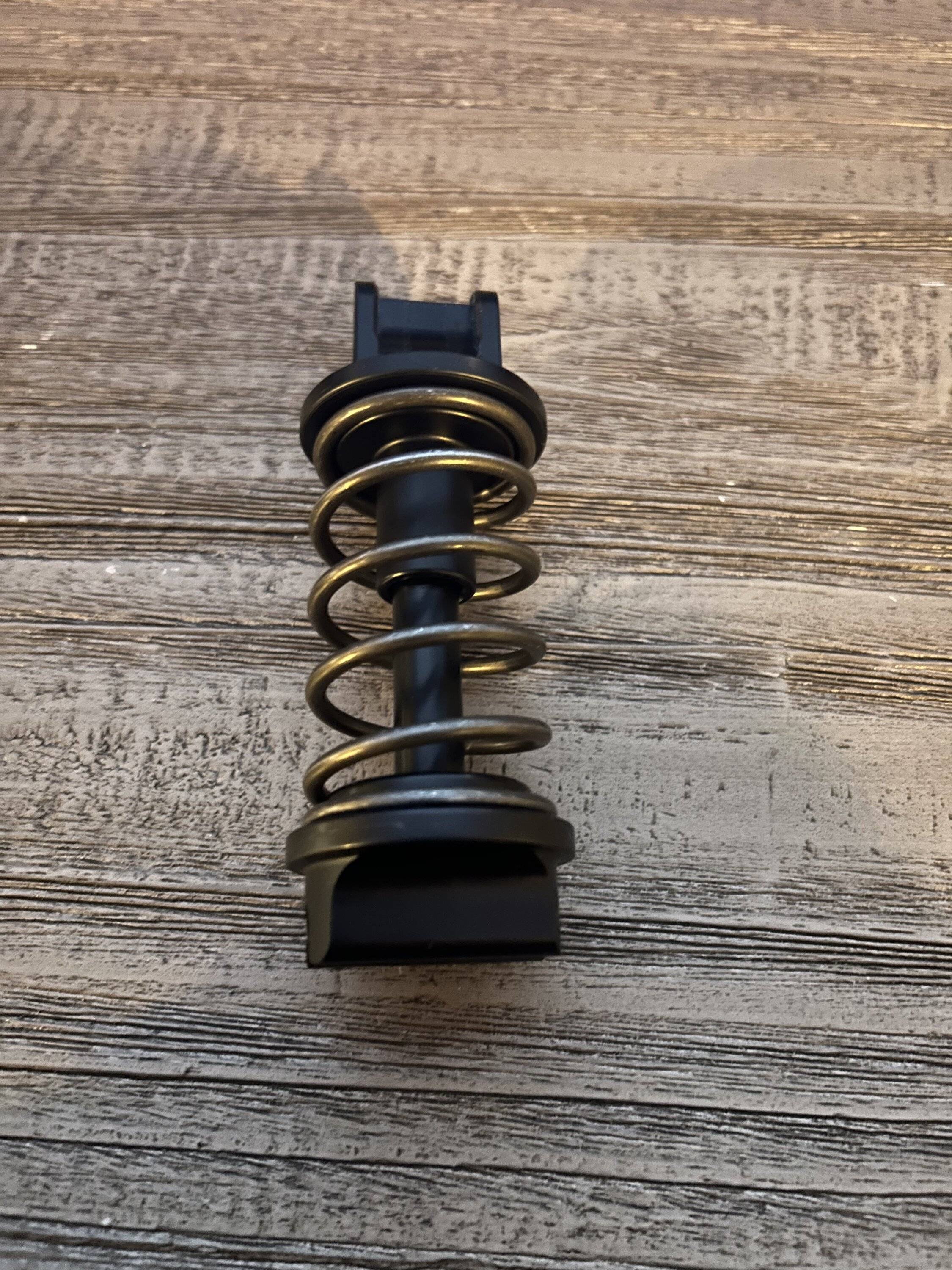

I installed the Steeda spring today along with the MGW shifter. The feel of the shifter is fantastic. The spring has made the clutch pedal motion much smoother for me with no hard catch point when driving with a little spirit.

I ordered the spring and its in rout itā€™ll be here the 12th. Iā€™ll be doing a braided clutch line next. Itā€™s great having so many people willing to help out. Iā€™ll be doing a monster stage 3 when I need another clutch which Iā€™m sure will also help. I have a stage 2 in my GTO right now. Love the product so Iā€™ll be sticking with that. And definitely doing an MGW shifter upgrade also.

And itā€™s here. Gonna install it here in the next few days and get back to everyone on how it feels.
it's easy to break the plunger plastic so do yourself a favor, use 2 zip ties to collapse the spring, put it into place then snip the zip ties.
Great advice thank you
