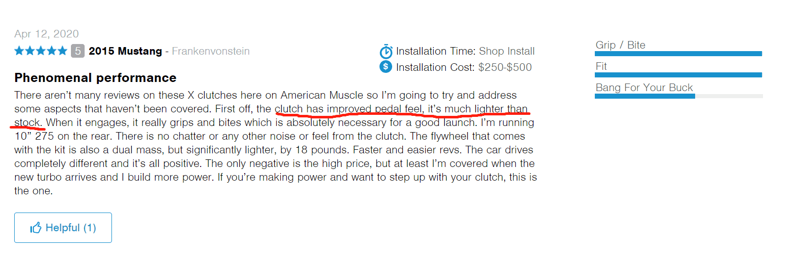

The AM sales guys recmond "X-Clutch Stage 2R Ceramic Single Disc Clutch Kit with Flywheel", I do see a guy`s review shows it could make the clutch lighter than stock. see screenshot

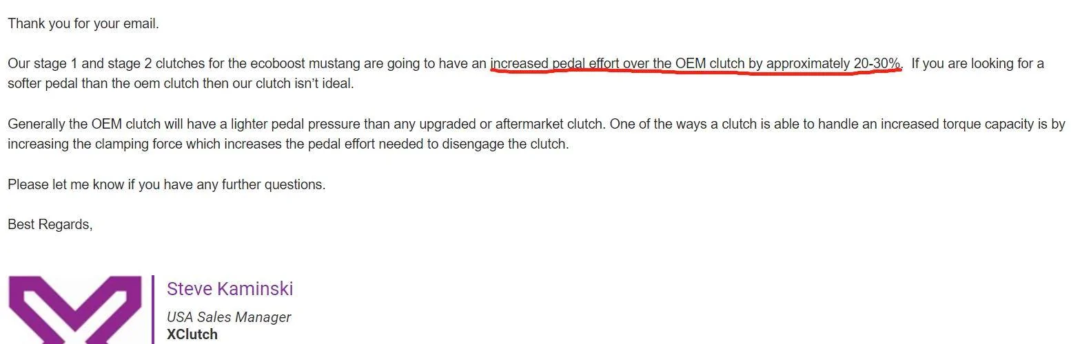

But when I ask X-Clutch sales man, the answer is their product will increase pedal effort over stock clutch about 20-30%. see screenshot
Is there any way to make 2015 ecoboost clutch feel softer?
