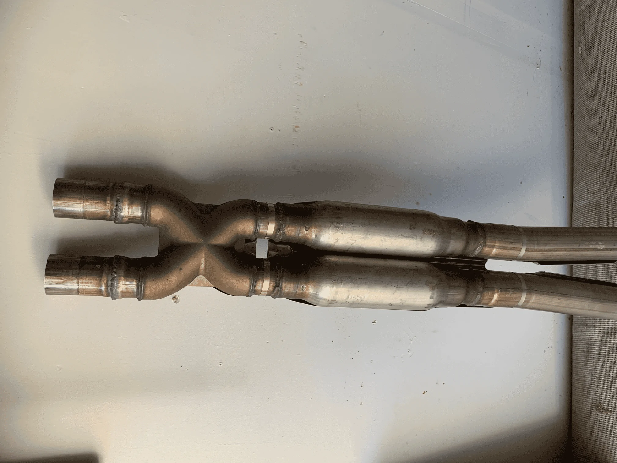

What about running the GT 500 X pipe with resonators in place of the big suitcase resonator the Mach 1 has. I plan to pair this with my 2018 active mufflers.
according to Lakeland Ford's site, it's nearly $1,500 and only comes as a full cat-back, i would rather get the double H pipe for a third of that (plus the chance that in-transit it gets damaged/bent)
also i'm not really a fan of how X pipes sound, too raspy for me
