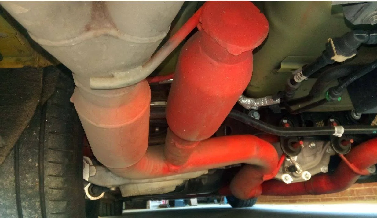

Basically what Im asking is, is there any good dampening material anyone recommends to tone the cabin drone down?
You can waste time and money doing other stuff but welding in a Helmholtz resonator is the only thing that will eliminate drone from the Outlaws,, or any other exhaust that drones..
I have LT's and 3" O/R Outlaw catbacks and welded in a pair of 2.5" Vibrant mufflers and those killed 95% of the drone ... There is drone under load, like climbing a hill in high gear but it's tolerable, Before these the drone would cause ear-bleed ...
