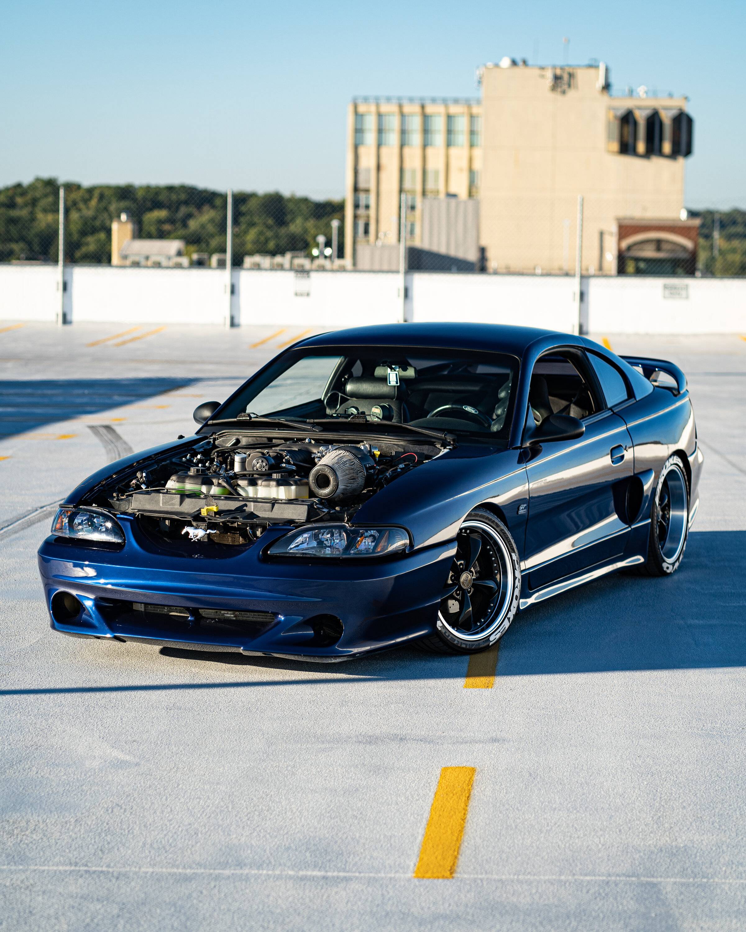

Heres a little image of the car for you guys:

Definition of a picture doing the car justice...very nice. Good luck with the build!
