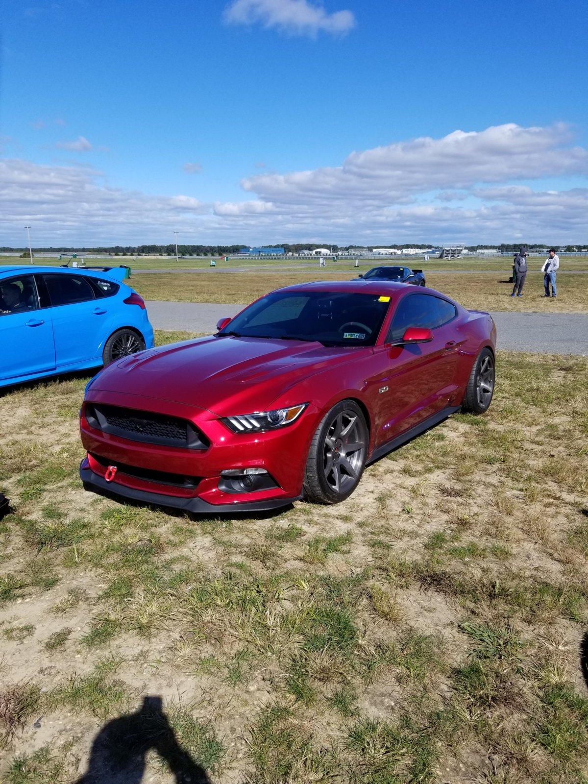

jabrax
Oct 22, 2015
85
790
146
Montgomery County PA
Jeff
2015 ruby red PP GT
Here ya go - on progressives - 19x10 - 285/35/19 tires

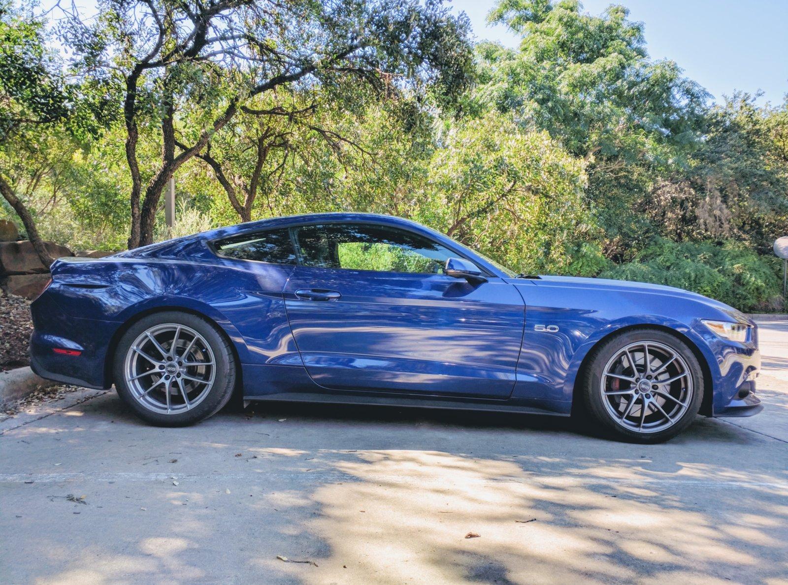

MtnBiker
Jun 24, 2015
414
142
San Antonio, TX
2015 Mustang GT PP
Steeda Linear Sports and stock PP size wheels/tires.
