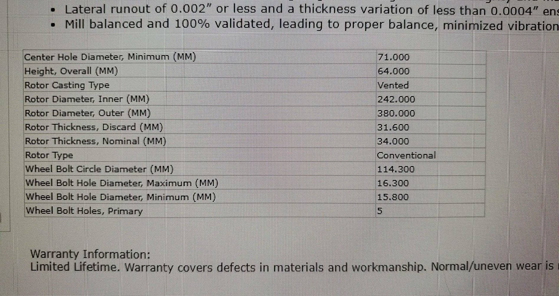

Minimum thickness.

My slotted rotors are not very slotted anymore. I will take some measurements this weekend.

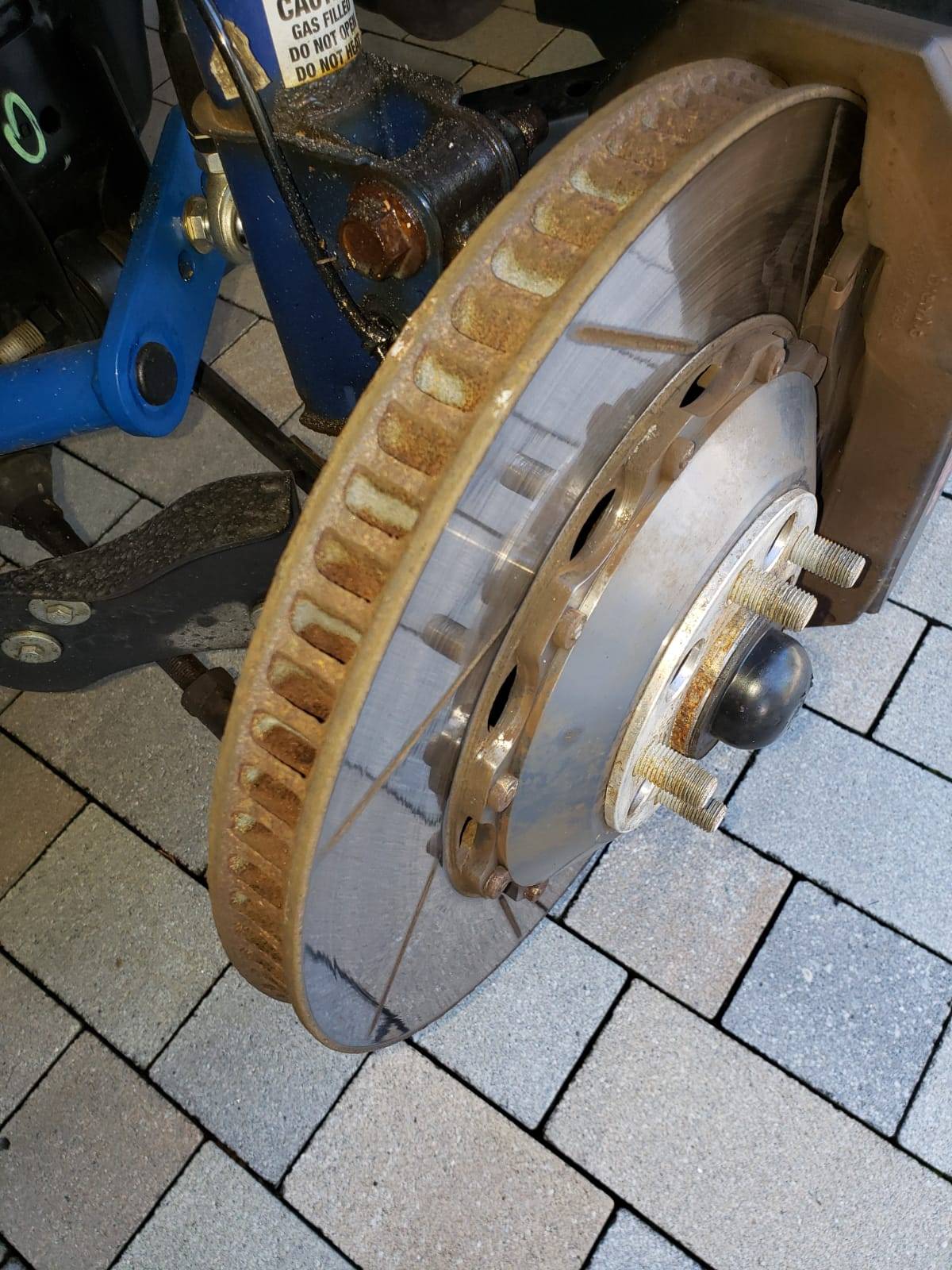

Post a couple pictures, usually it's easiest to estimate wear with a quick visual inspection for small cracks and such. As mentioned above, lots of small cracks around the center of the rotor face are normal when driven hard. It's when those cracks extend to the lip (or through the lip) where you need to be mindful of them and ready to replace.
Different pads also treat rotors differently. Some of the cheaper race pads are very abrasive and thus eat up the rotors much quicker than some others will. It really ends up costing more in the long run, since you have to replace rotors more often ($$).

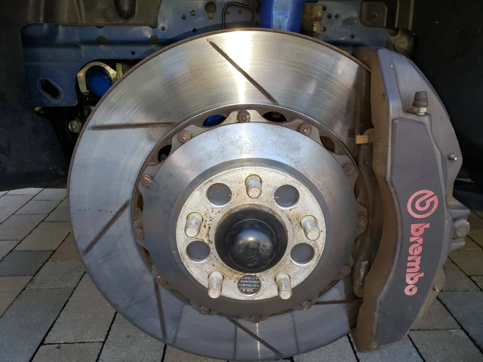

Weather was nice today so I was able to work on the Stang.

Iron discs (used on track) generally lose effectiveness long before they're actually worn out in a mechanical sense. They will start to not have good 'bite' and then the overall efficiency of the brakes kind of goes to hell with higher pedal pressures and inconsistent locking. If you're concerned with performance, change before then.
