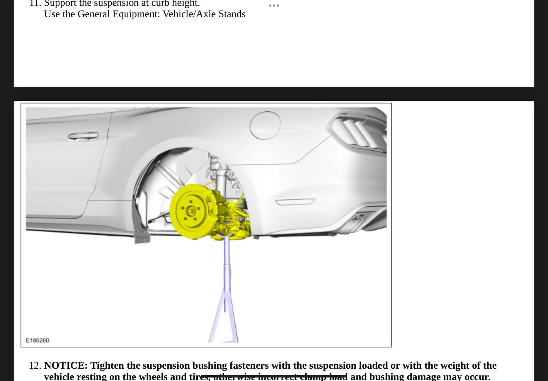

The Ford Service manual always shows the car on a lift with an under hoist jack stand to load the suspension. My version of that when doing suspension work on my car in the garage on jack stands is to use my floor jack to load the suspension.
While this doesn’t get the suspension at the exact same height as it would with the entire weight of the car on all four wheels, it’s close enough to work without damaging any bushings and my re-torqued suspension bolts have never moved as proven by the paint pen markings.
