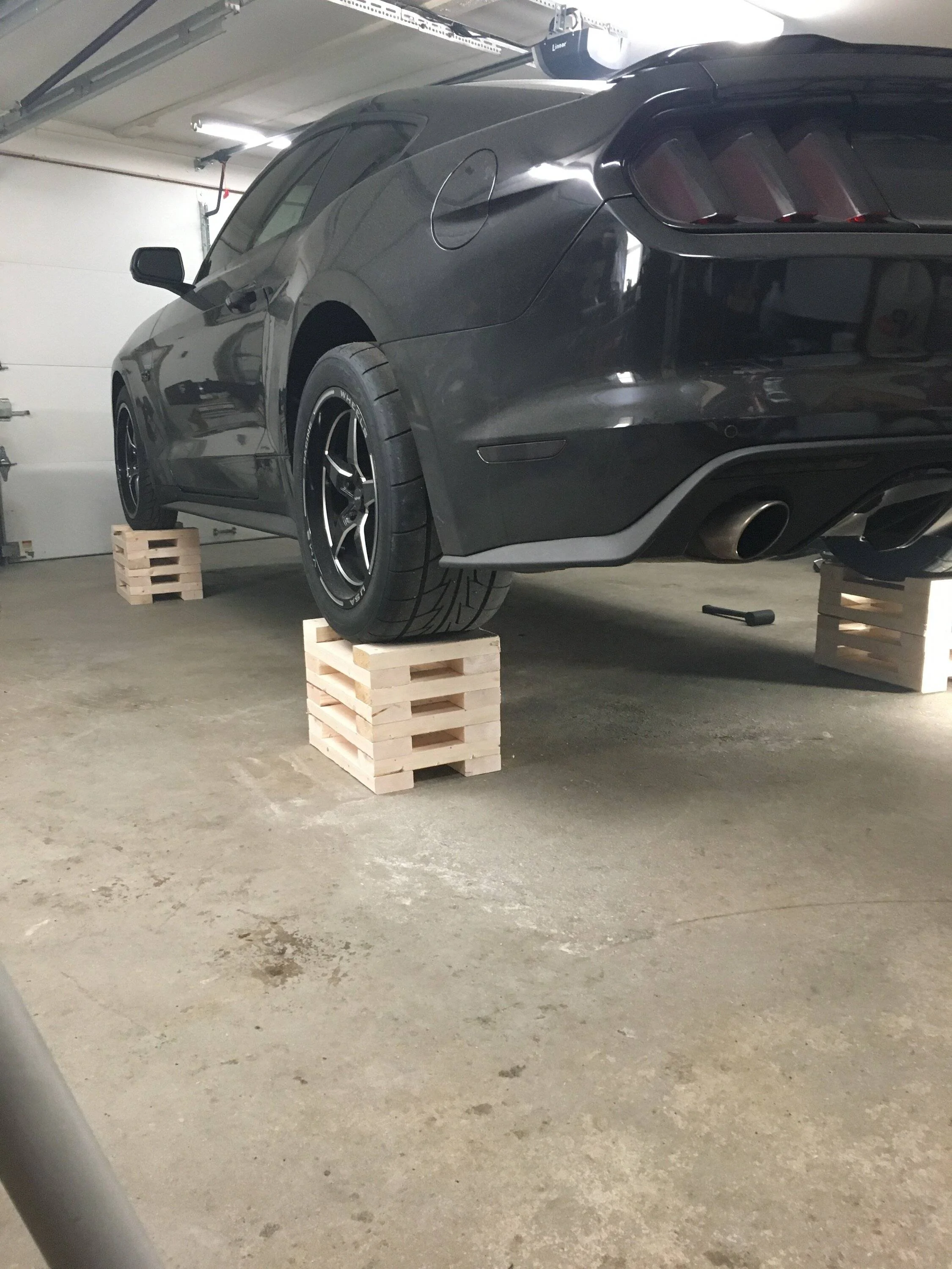

I use both. Depends what I’m doing. These are cribs I made. There’s actually 8 sections. 2 stacked under each wheel.

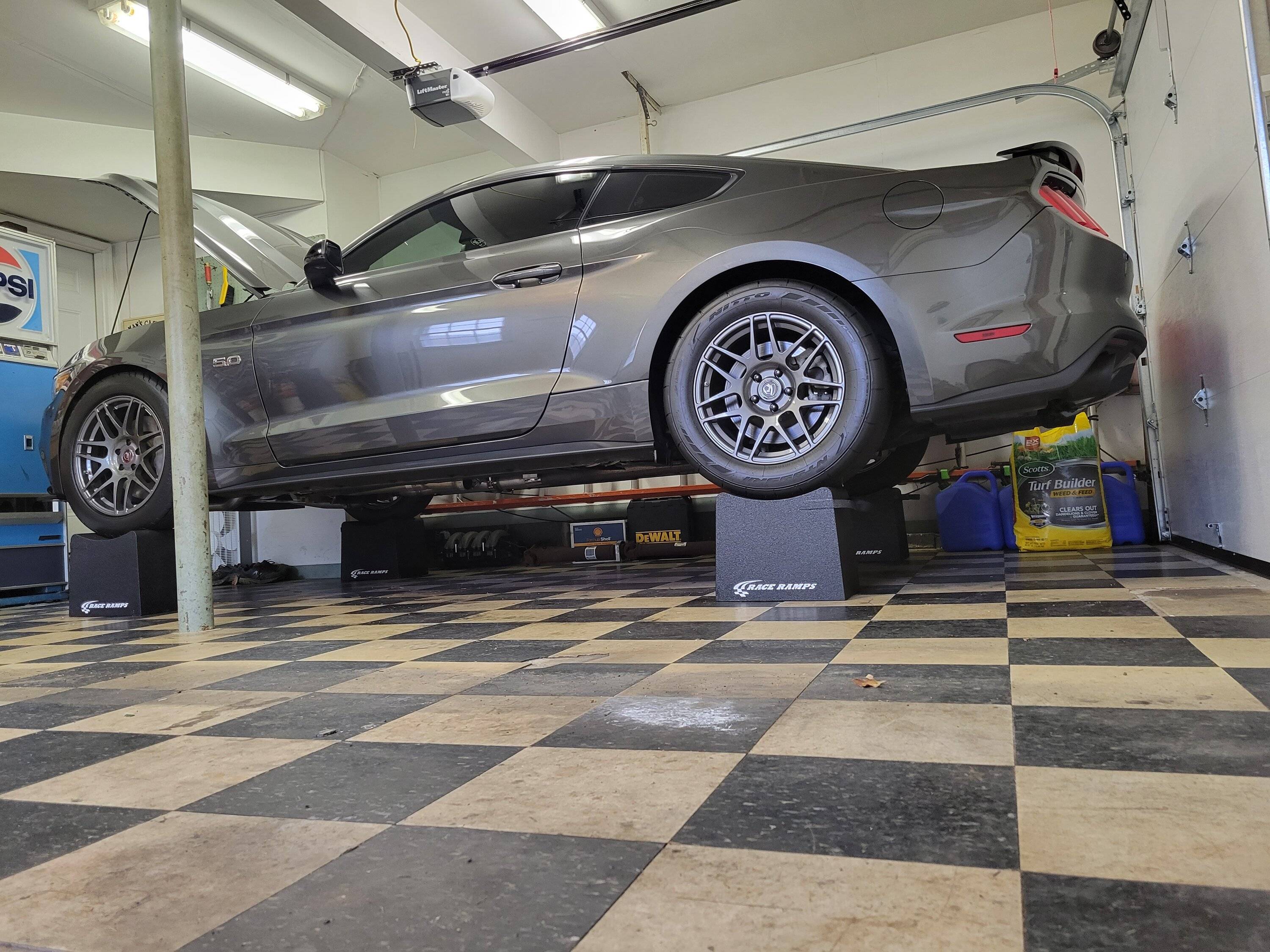

I've used these 10" wheel cribs from Race Ramps for a couple of years. They're not cheap, but work great, are easy to set up and store out of the way.
I typically use them for oil changes, but also used to install/remove a cat-back exhaust on my GT. There is plenty of room to move around under the car with the 10" cribs.

At the time I think it cost me around $21.00 and about 1hr to make them. Getting the car up on them is the tedious part.

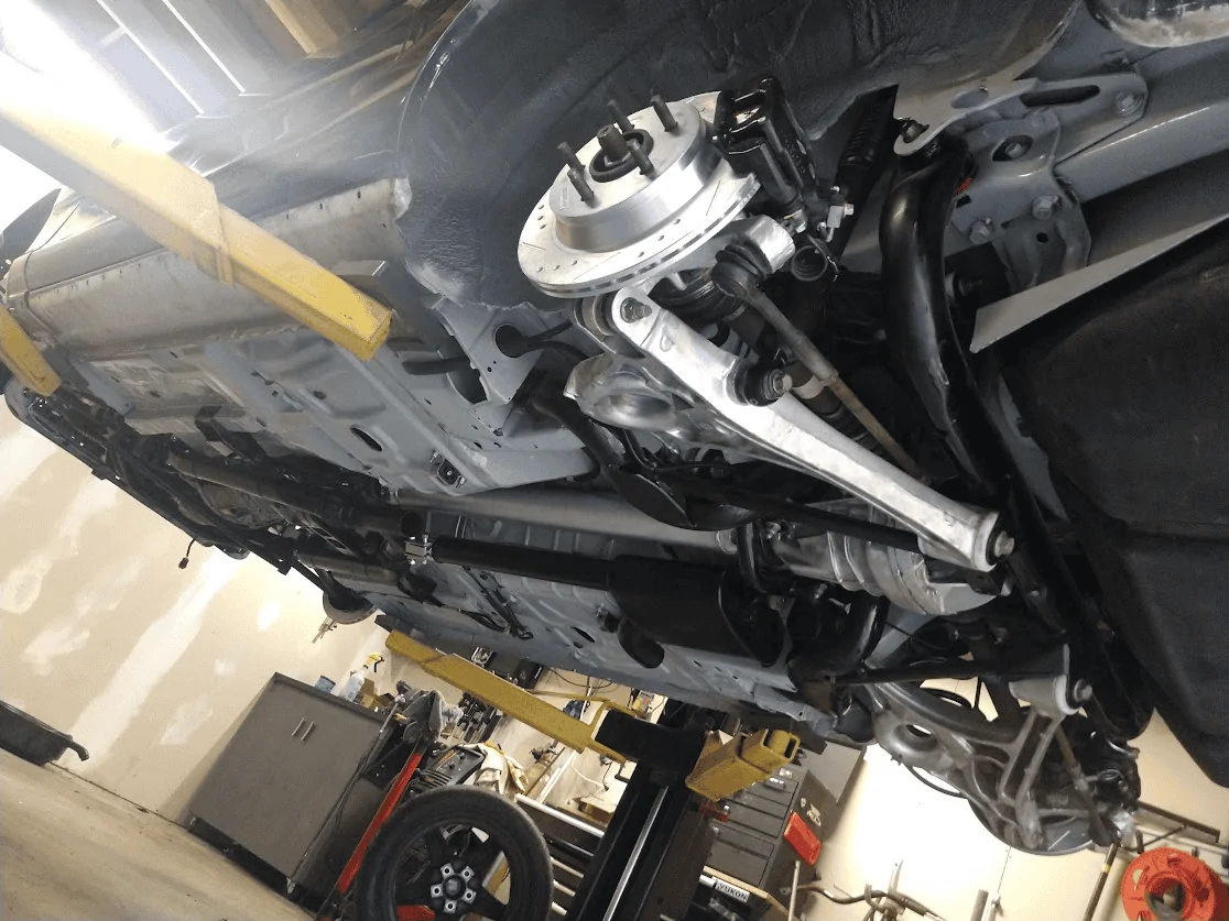

I have the raceramp 12 inch. Just pulled the transmission out to have it built.

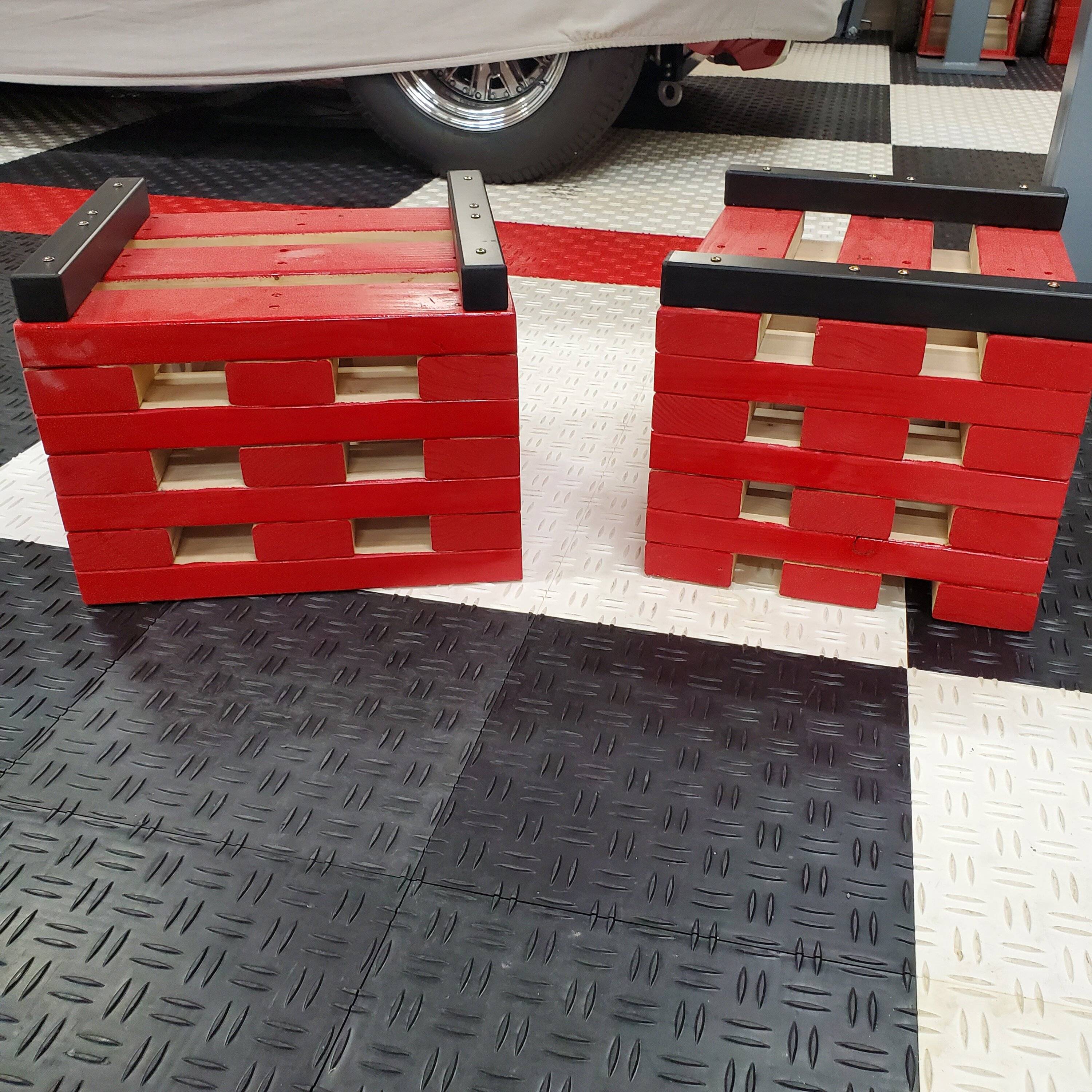

I built these, 10.5" High fully supported to the floor.
