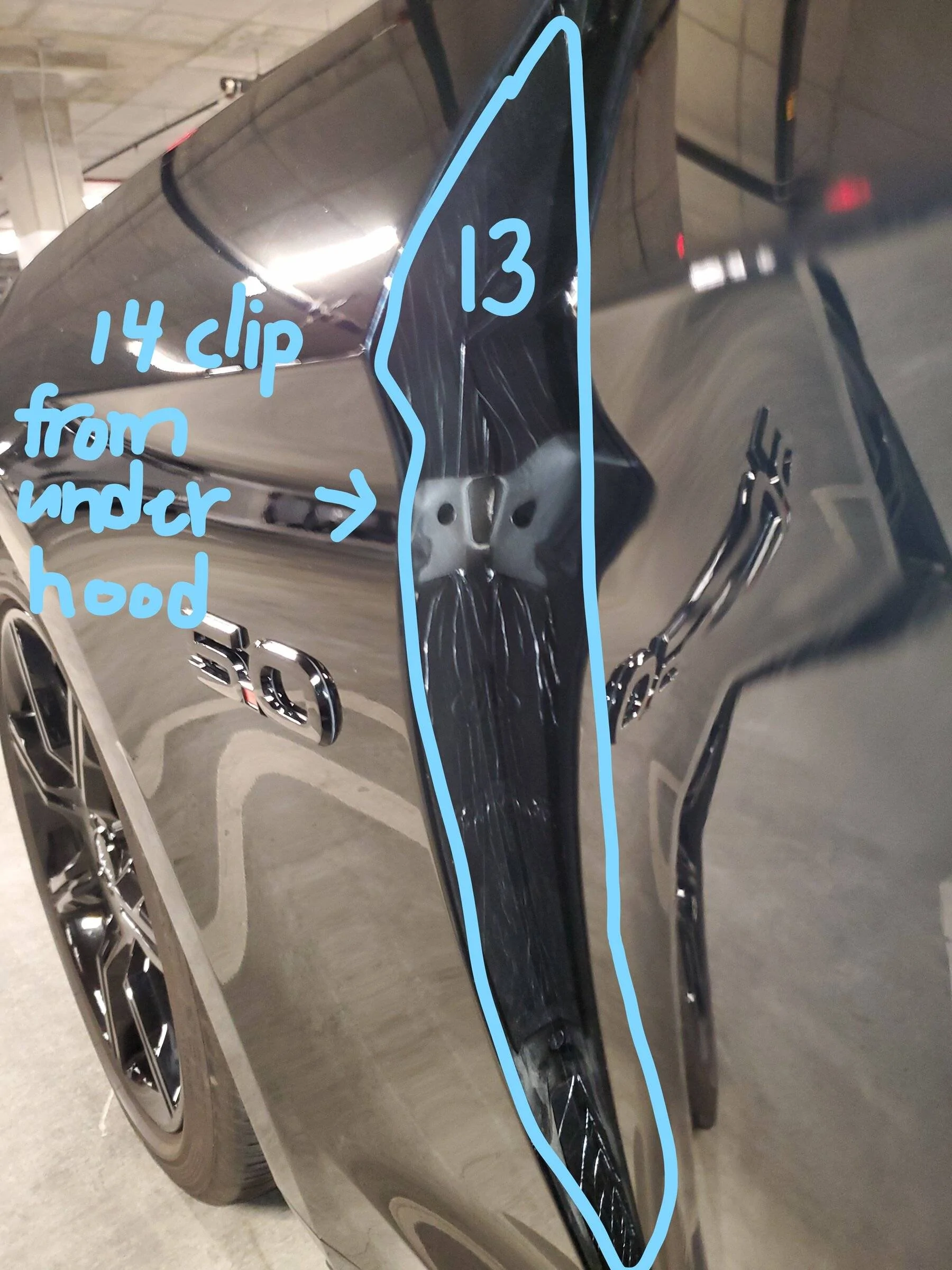

I need to get this pin into the driver side fender insulator to hold it in place, but I have no idea how to reach it.
I can barely get my forearm down through the top under the hood, and it will take a good amount of force to get the pin through the thick insulator, and then through the hole. The pin has to go through from the inside and will not work the other way.
Anyone know an easy way to access the inside and with enough leverage to shove the pin through?

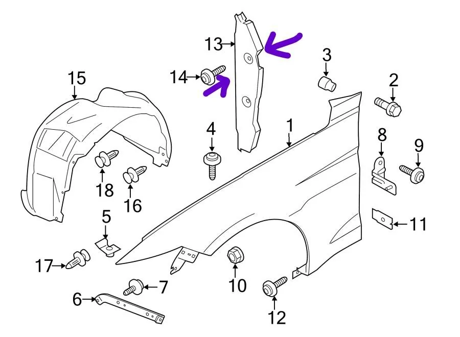

Seems that you have to remove the wheel liner, # 15, to do it
Btw, just went to look at mine and the factory only used 1 push pin at the top and the foam piece doesn’t seems to even have a hole in it for the lower one

Yes, on the wheel liner the pins come out pretty easy and you only have to remove the back , you can then fold the liner to access the foam piece and insert the new pin

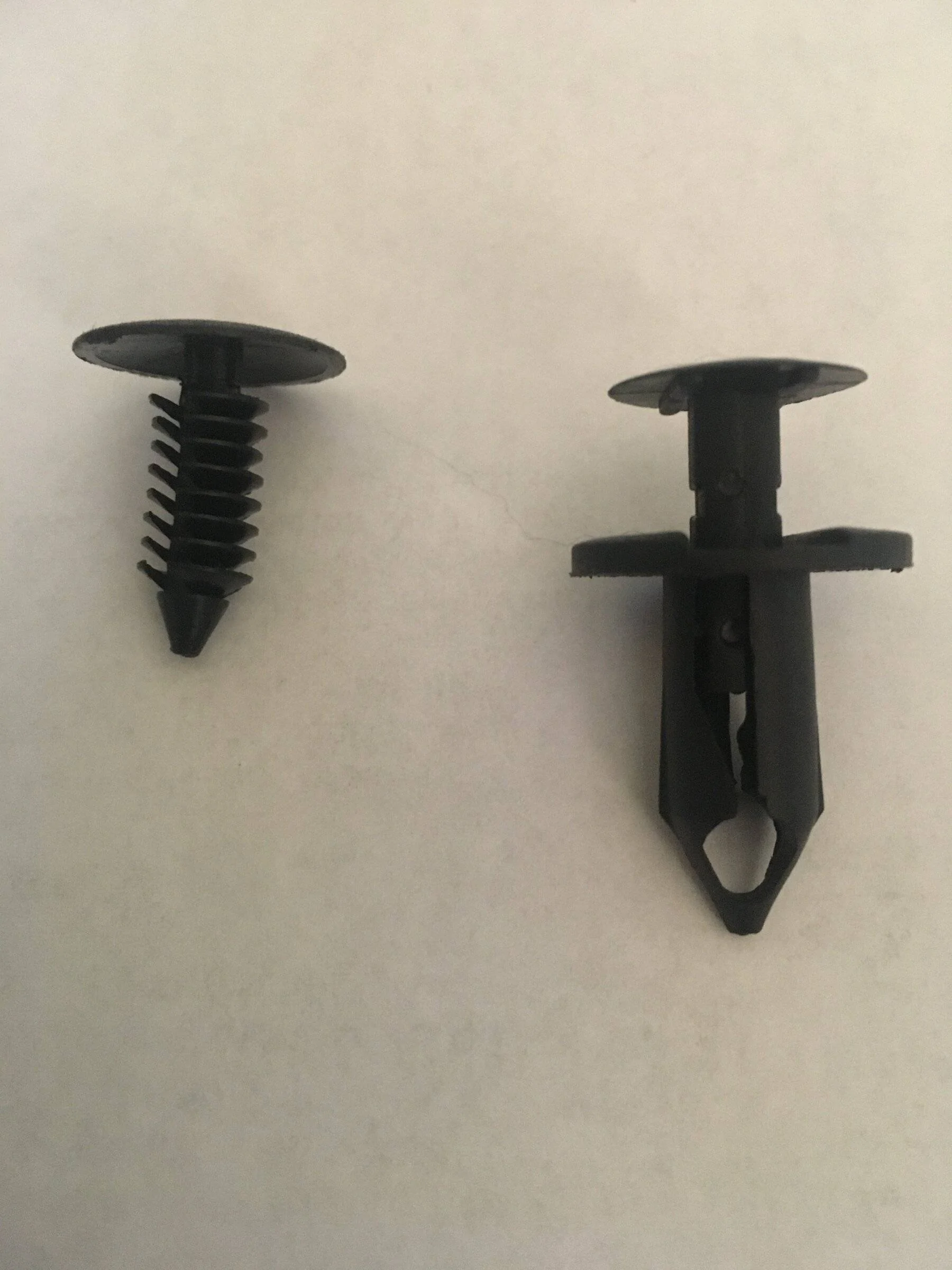

You really have 2 types of pins
The one that is missing is a 1 piece called a Christmas tree that are easy to put in but very hard to remove. You can get some new ones at a part store
The other type of pins are made of 2 pieces/part and are very easy to remove and put back
If you look closely you will see a top and bottom part
Slide a small flat screw driver between the top and bottom part and lift the top up. You can them remove the bottom part
Basically the top has a straight pin that spread the legs of the bottom part when pushed in
Make sense ?
