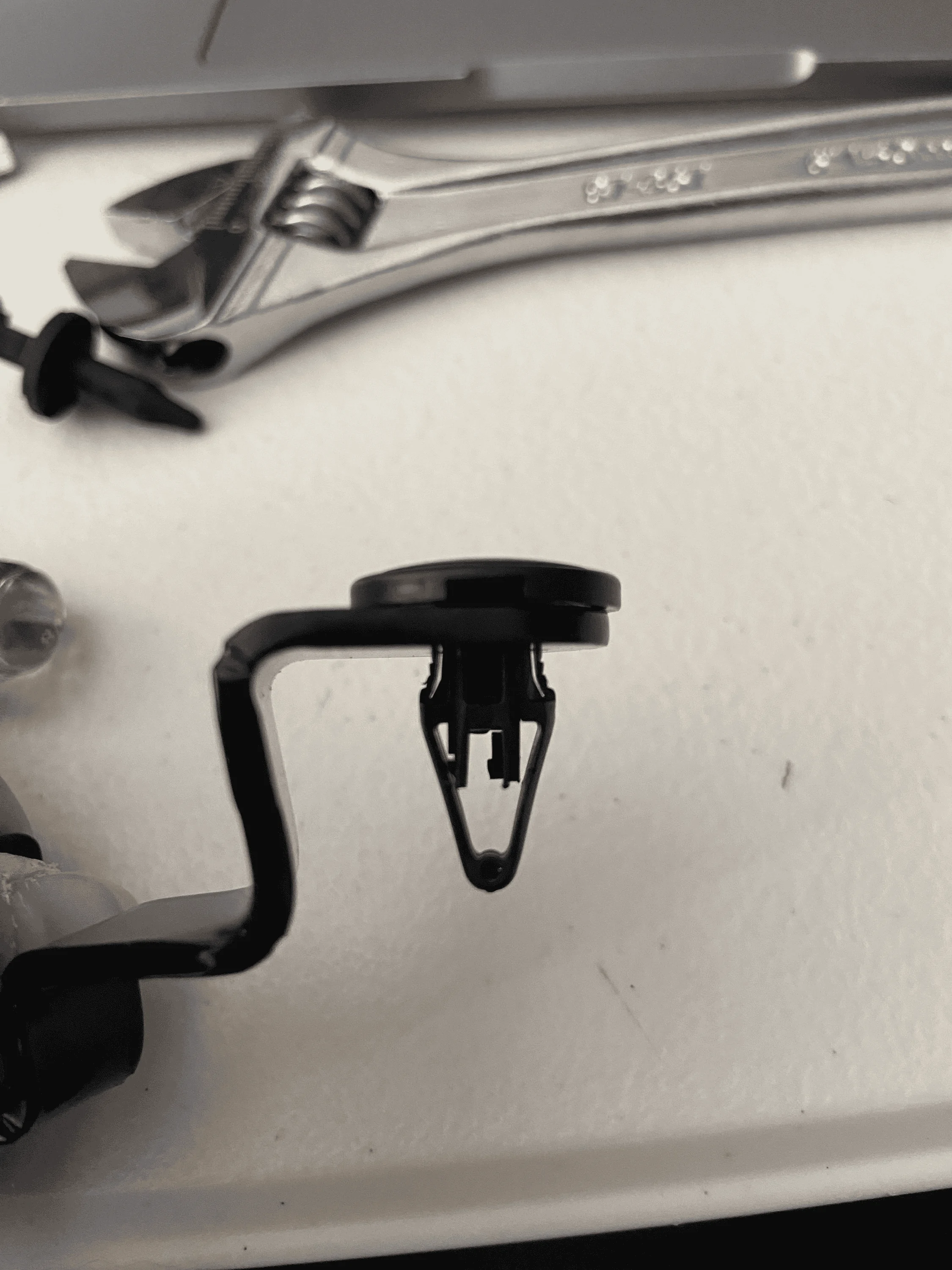

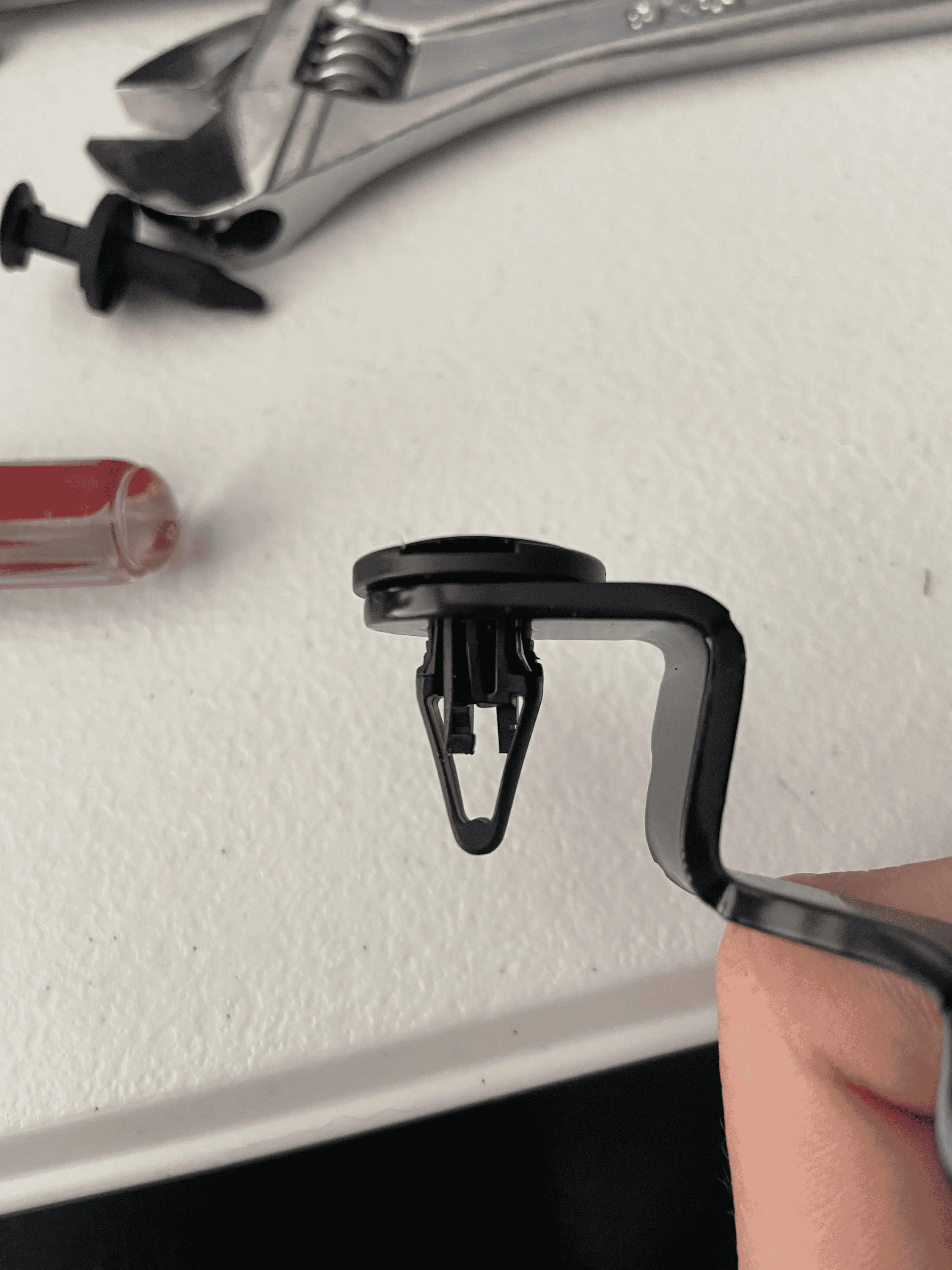

This is the 8mm pushpin rivet that comes with the Ford Performance oil air separator (part #W714400-S300). I accidentally pushed it in and now can't for the life of me get it out... or is this one permanent
edit: I'm a doofus, had to use one of those trim removal tools to get the little pushpin out of the big one first, then you can squeeze it and it slides out lol
