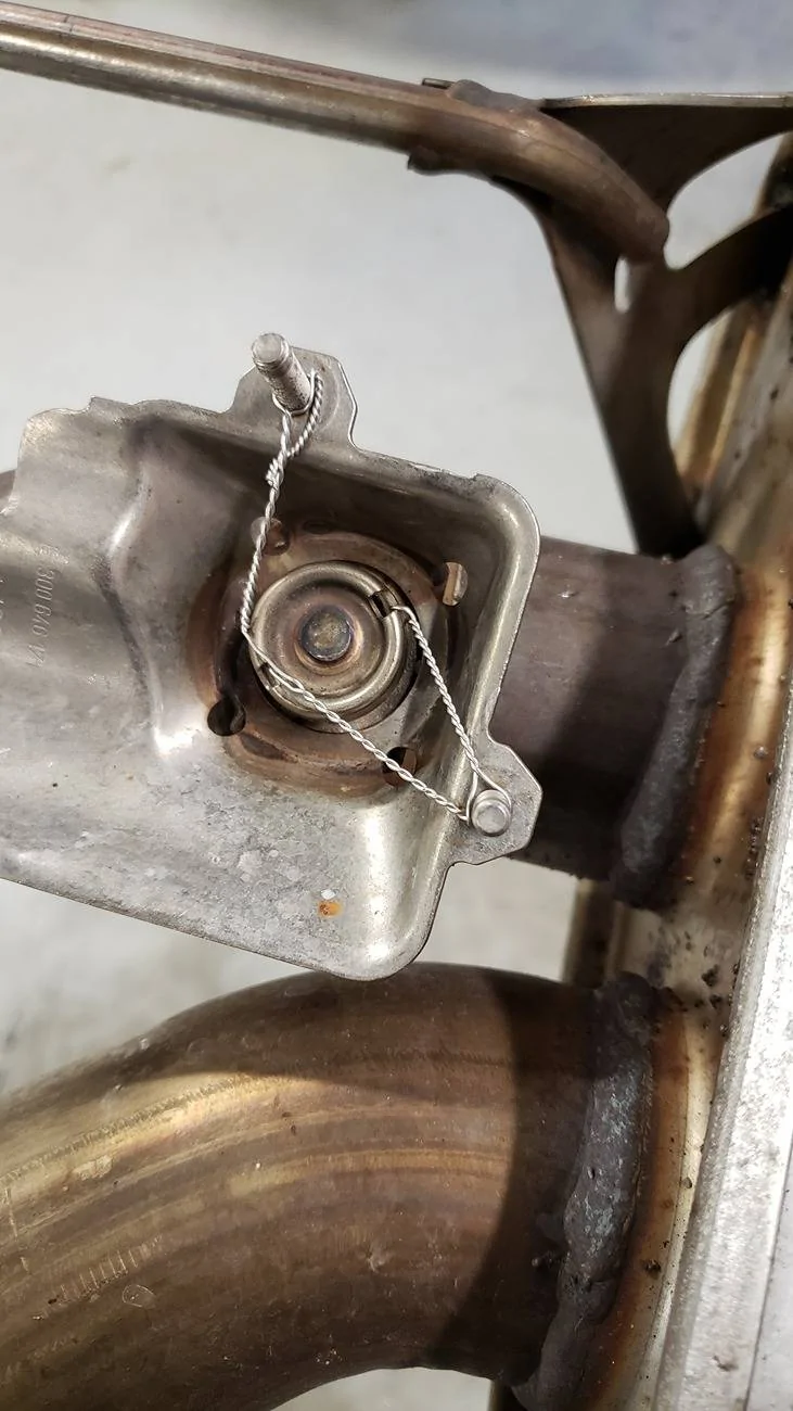

Well - you could always pull the valve motors and wire the valves open all the time..... works great on the Mule.
