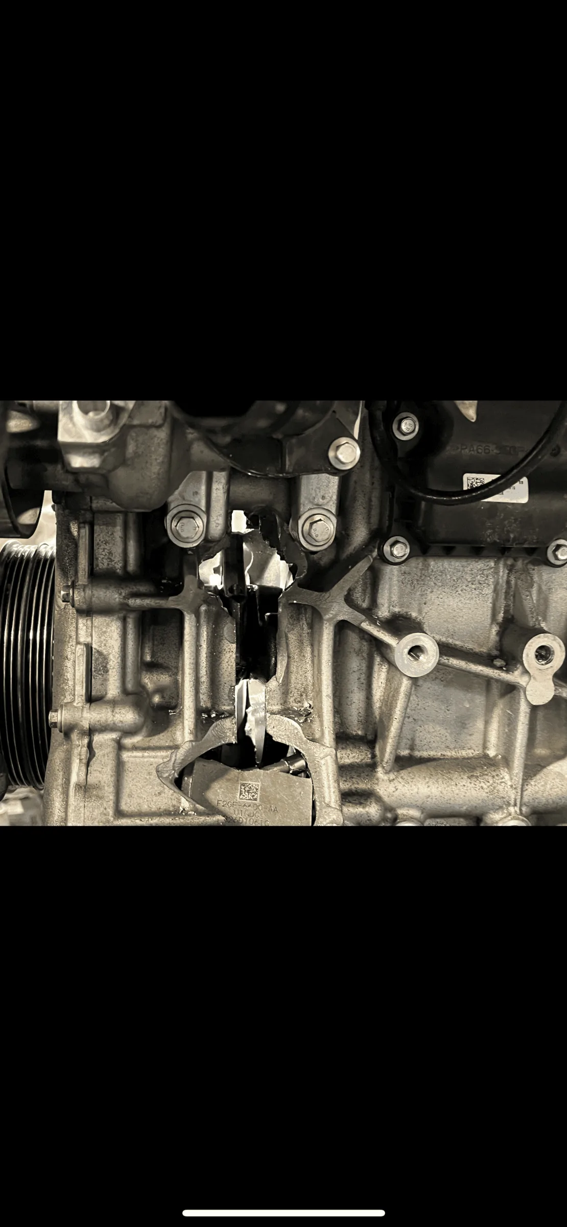

2018 10r80 ecoboost here.. bought the car used at 27k miles put roughly 1000 miles on it since buying, only thing have done was mobile 1 oil change done by me (ASE tech), stock air filter, stock tune, as far as I know car had never been touched. ( bought from a woman who bought it new). Driving down the road going 45mph Under 2k rpm’s and boom cyl 3 decided to exit the block. Thank god still under 60k power train, ford is putting a factory long lock and turbo on. Figured I would put it in here for others to see a stock 18 with ecoboom….

Well ford seems to think it was a casting issue with the block, the oil I was running was made to help prevent LSPI (low speed pre ignition) but it does not mean it can’t happen still, since it happens at low speed at high loads. The issue I’m having is I was letting the car do what it’s supposed to do from the factory just driving down the street. I was not in boost, I was only giving enough throttle to maintain my speed on a flat surface.. and yet the rod left the block.

you could make the rods out of the strongest material not invented and it wouldn't matter. The problem isn't the rods, it's the detonation or other mal-ignition that found the weakest link in the chain and took it out. Fix the ignition problem and your rods could be made of chilled butter.

Hopefully it is a new stronger refresh. I’ll check all the block casting numbers and stuff when I get it back. Other turbo motors may have had it but this is the first motor I’ve ever seen just throw a rod out of the block cruising down the road.
