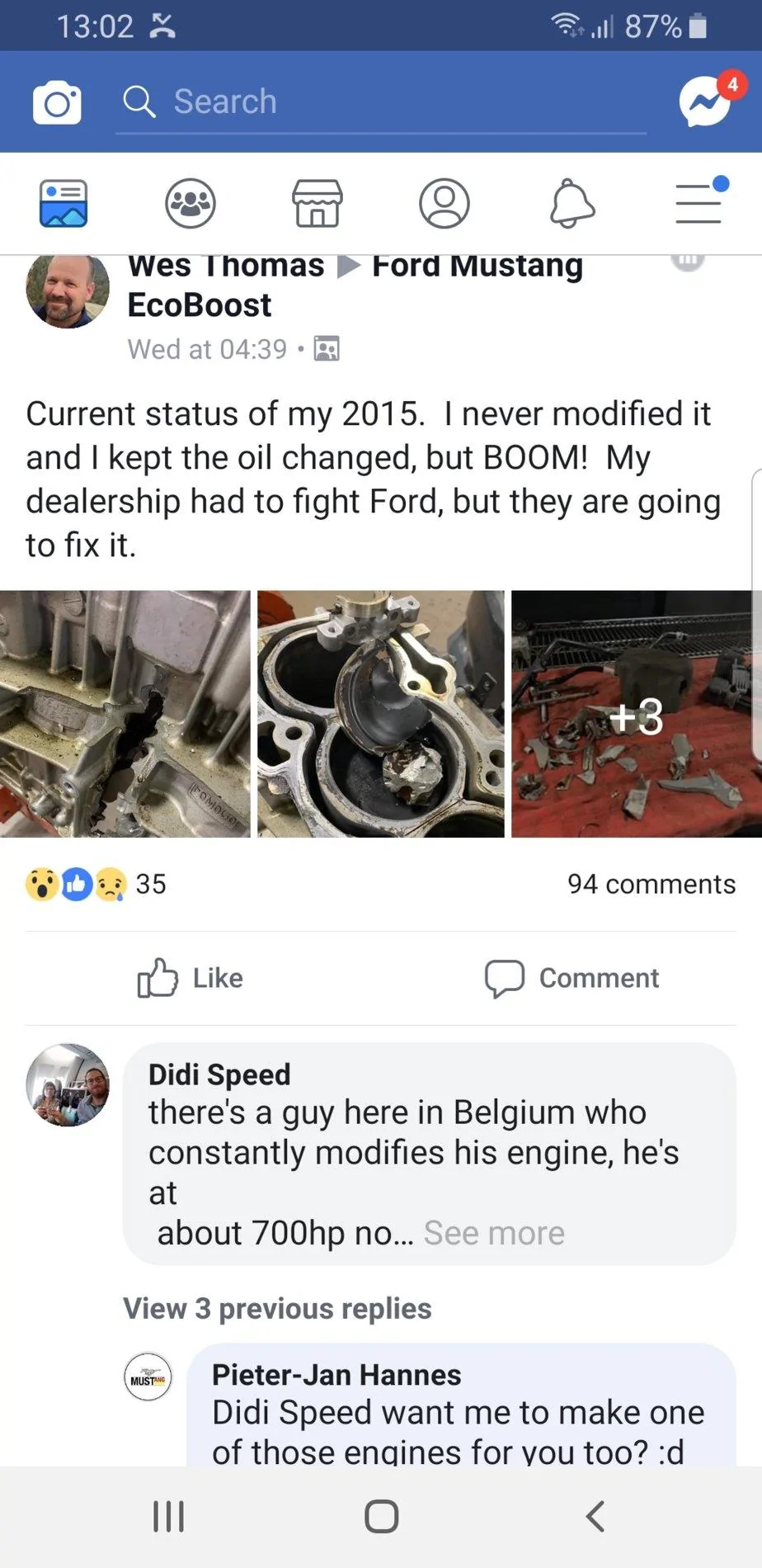

I'm on a couple of the Facebook EBM groups. My original post was made after reading about someone's engine making it's last revolutions with just an aftermarket induction. And now a new post from a 2015 owner. Engine is stock and regular oil changes. He now has a pile of metal parts. Plus another owner posted that his is dead. The car has a tune.
Some are covered under warranty, some owners have to pay for a stock replacement and others look to the aftermarket. Has the 2.0 block with 2.3 internals been a proven combination to eliminate the chances of an EcoBoom?

A blown motor, on the FP tune, was just posted on FB with pics. It had the tune and an intercooler and was just installed two days prior to popping. It took out Cylinder #2 and had a code for a Cyl. 2 misfire. What's interesting is that it bent the rod and it didn't snap. This now makes (2) cases that I've seen with bent rods. That can sometimes save the block but his cracked the piston and did a good bit of damage to it, so the entire motor is being replaced by Ford under warranty.

For those who support that stock EB don't go boom. One of several that I came across on Facebook during the last couple of years.
I don't think anyone is saying the stock EB doesn't go boom. I have seen a few threads of bone stock failures over the years but they are rare. So how common is the Ecoboom depends on whether or not the engine is modified or ECU tuned and by whom it was tuned or modified. There are some tuners with a lot of Ecobooms and some with very few. There are also some user error failures.
There does appear to be more 2015 ECU tuned failures and it could be the more aggressive factory tune is a contributing factor. The 2016 and 2017 appear to have been re-tuned by Ford.
There have been a few members with failures that claimed stock engines but were actually ECU tuned or modified. I find it interesting that the post from Facebook says he had to fight Ford for replacement? If it was stock and under warranty why did he need to fight Ford? Maybe he was doing his own maintenance and couldn't provide maintenance records or was it something else.
Our EB is bone stock and my wife uses 87 octane(top tier) when commuting to work. Going on 4 years and 30k miles without a single mechanical issue.
