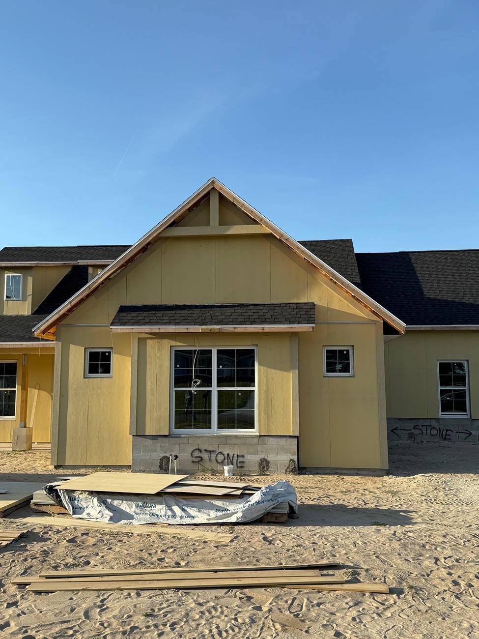

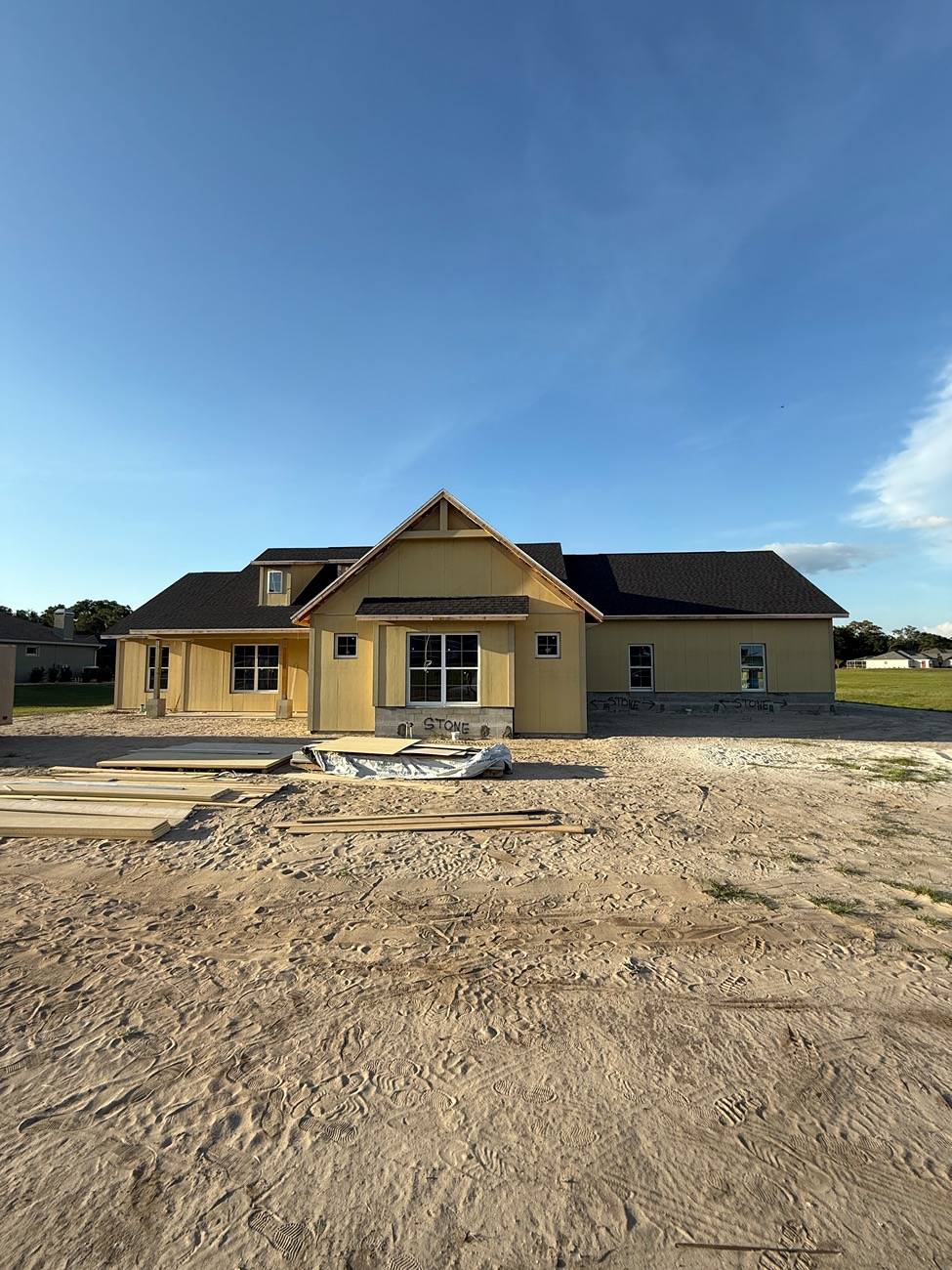

Pics of exterior decorative trim which is actually wood beams wrapped in cement board. They will be painted a wood tone color and be low maintenance as compared to actual wood trim. The yellow material on the front of the house is called cladding (a cement board material). It’s still missing batting strips that will be spaced evenly across the front fascia to give it more of a farmhouse look.
Here’s a pic of the boxed tray ceiling in the great room.

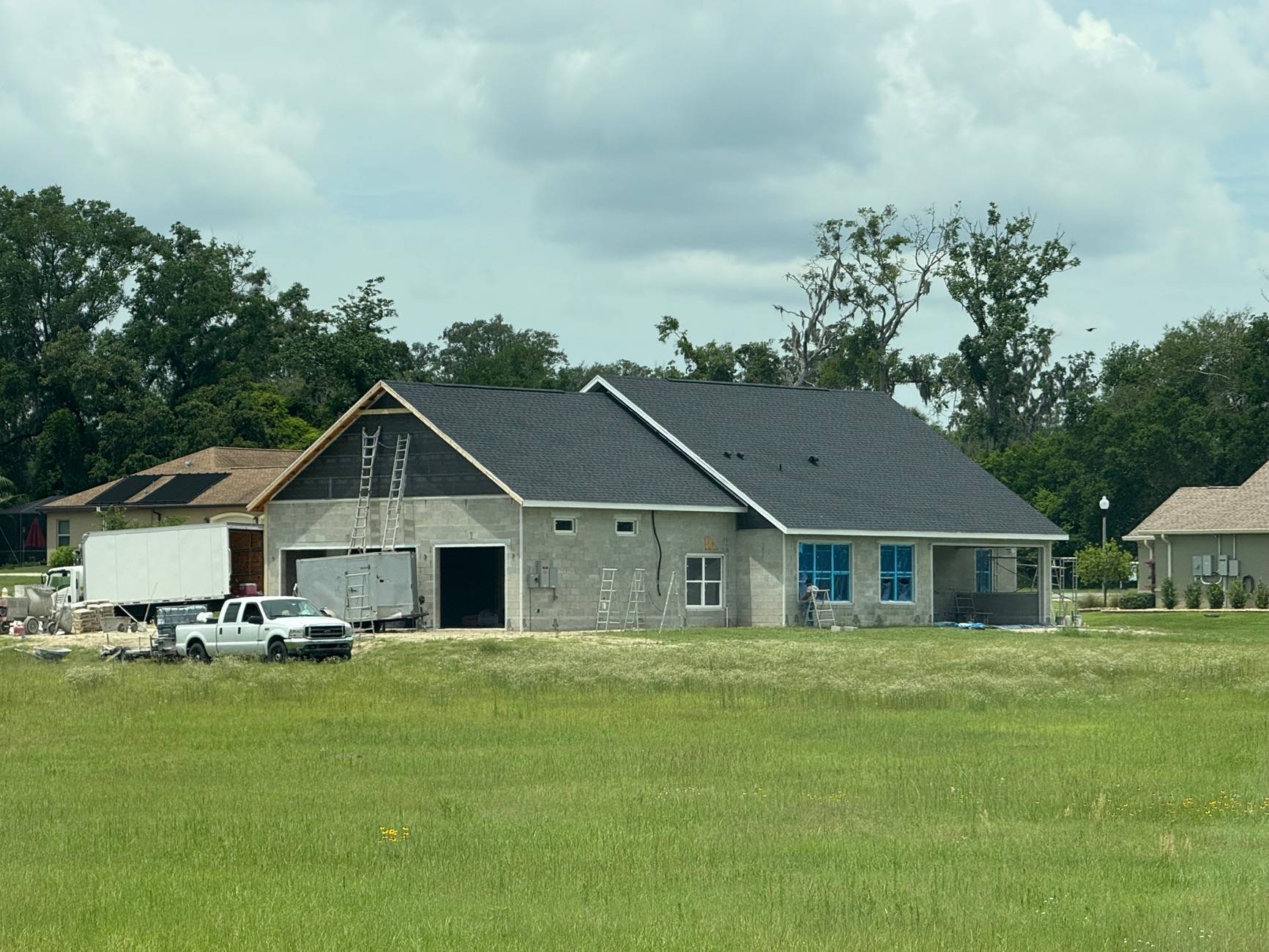

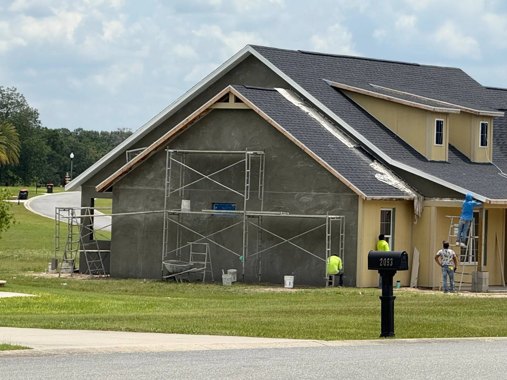

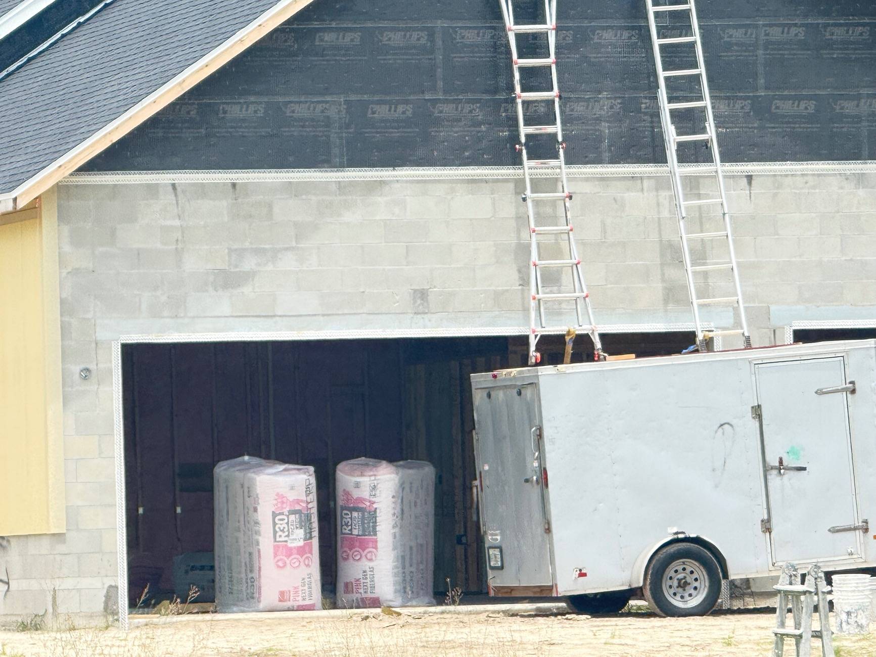

Stopped back by this evening to take a closer look. The stucco crew is serious about getting their work done. They were still going at 6:30 this evening.
The shop area should be very comfortable with all the insulation added, once I install the mini split in there. The garage doors will also be insulated. It’s safe to say that I should easily have my Polar Bear Club (PBC) membership reinstated, lol. What is the PBC? It’s a silly club name that my buddy in Kansas City came up with for having a super efficient cooling system in the garage. I didn’t make the cut in KC with my little portable AC unit, but did become a member at the last house, lol.
The white insulation looking material is the soundproof batting.

Curious how stucco is done there. Did they just use a fastwall application straight to the block(that’s how we do walls here)? Did they bed any mesh to the brown coat? Our homes are typically stick framed(my specs as well) so they get wired for the brown coat and we mesh the brown as well. We use acrylic for the topcoat, not elastomeric. The uv inhibitor in elastomeric is gone within 12 months due to our elevation. Do they sweat it(water it every day for several days) before the color. Nice build, sure you guys are excited.

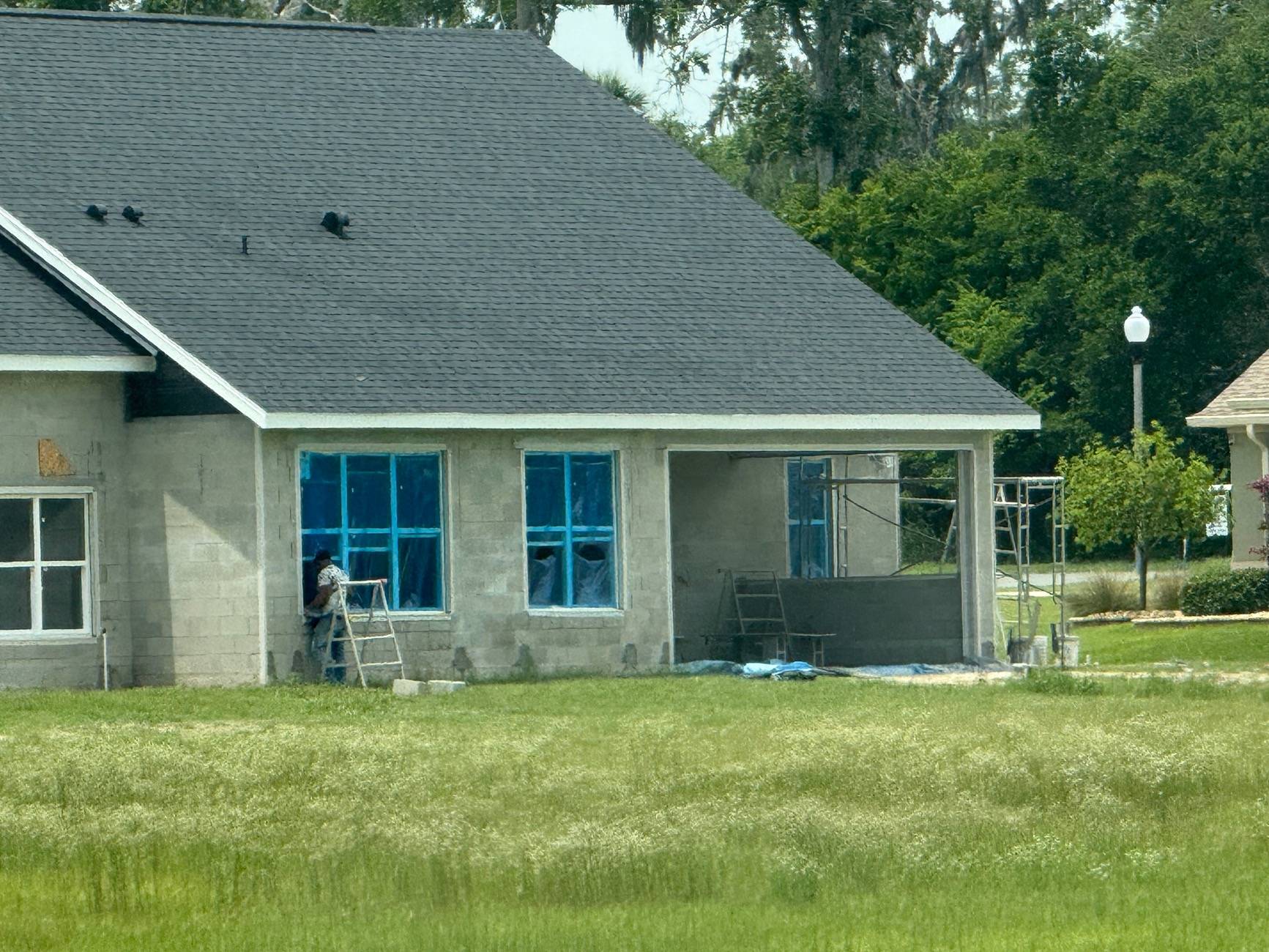

@Inthehighdesert I didn’t get to see how they started out during the stucco process, other than the the application of the lathing up high (non cinder block areas). As far as the cinder blocks go, I looked into it a bit and research says it is to be applied directly to cinders with a bonding agent, followed by dampening.
When we stopped back by yesterday evening, the installers were working on the back of the house. It appeared that they were working in stages, as the application looked smooth and damp (with no rough texture yet), whereas the side that was damp in the earlier pics was dry and did have the rough texture to it.
