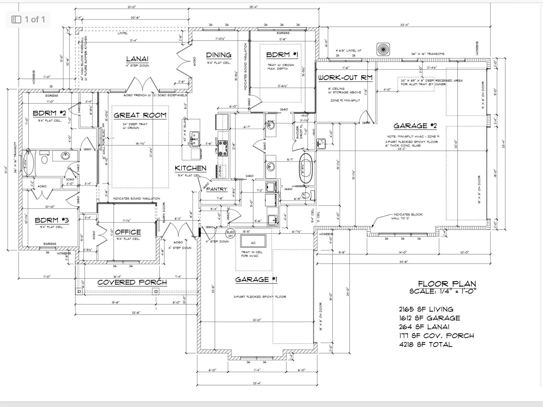

Floor plan diagram (rough draft). Some changes were made afterward such as deleting the French doors from the lanai to the dining room. Ignore the SF listed on the diagram. Actual SF was listed in one of my earlier posts.

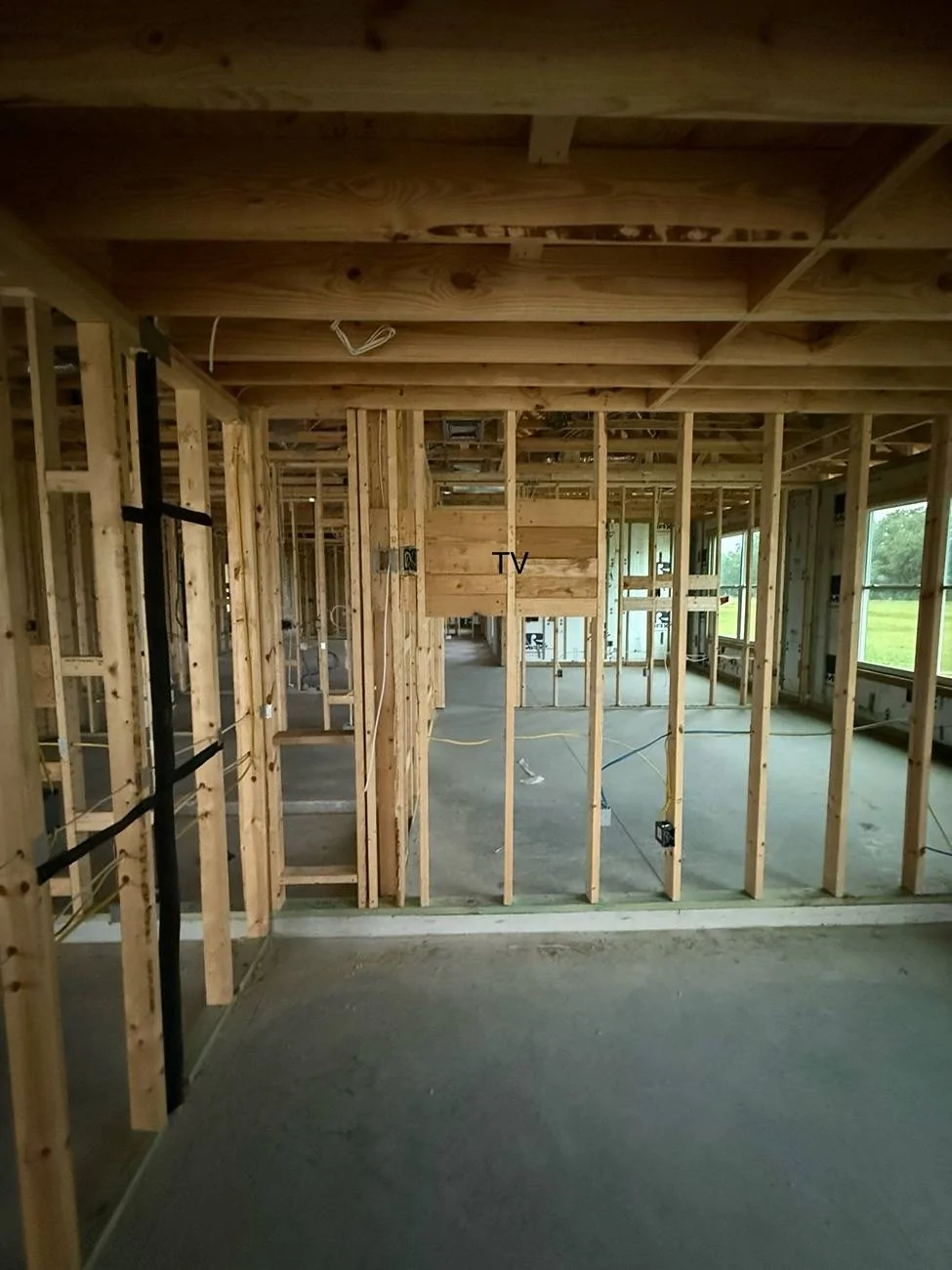

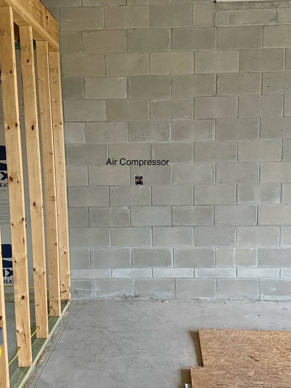

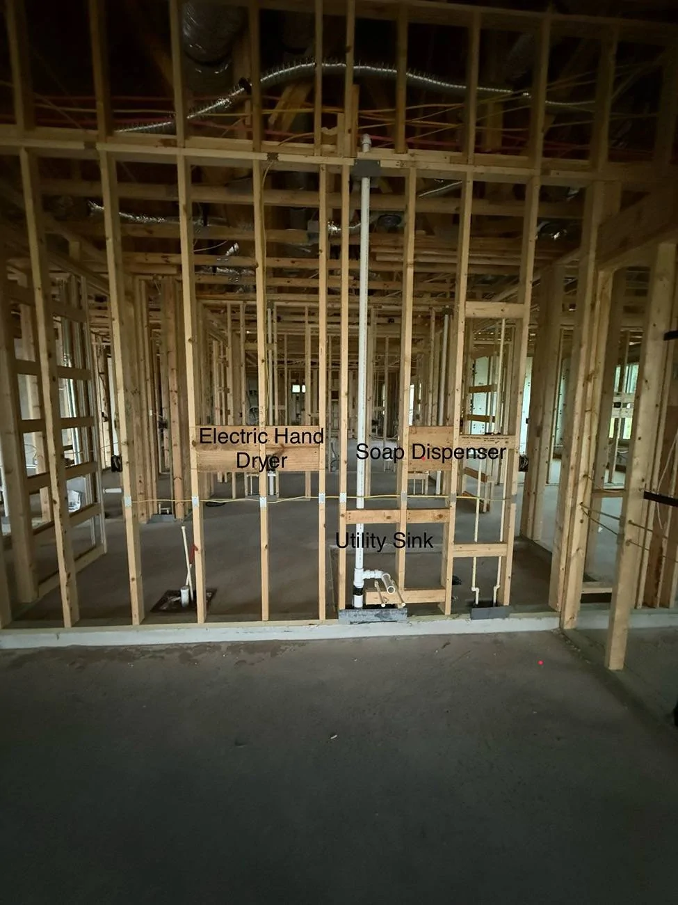

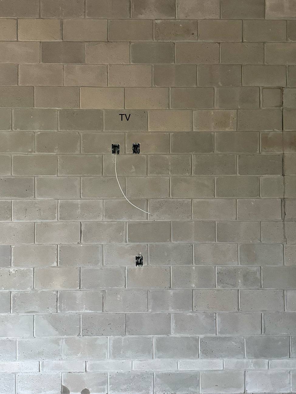

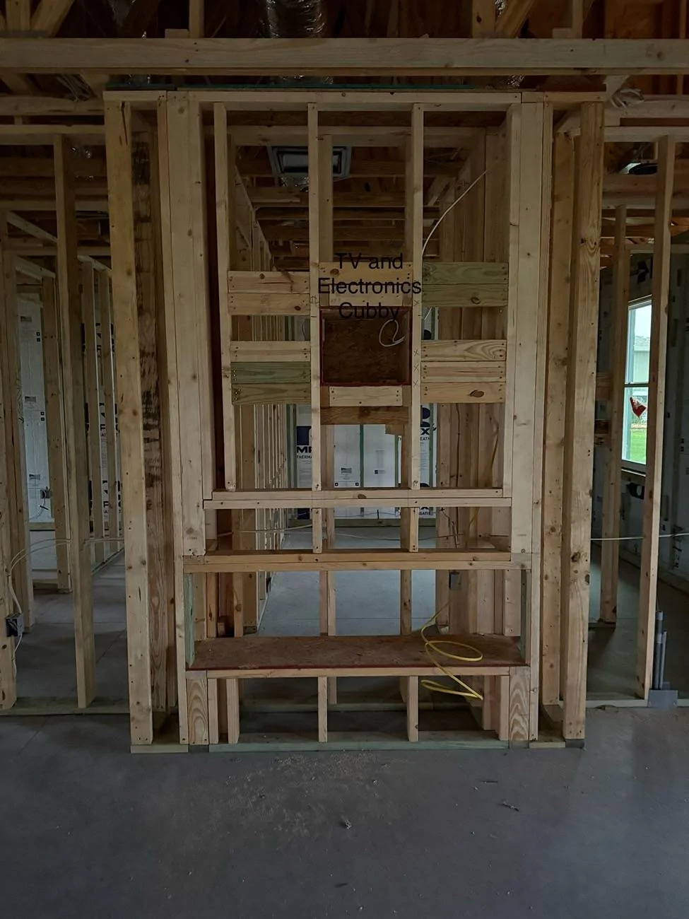

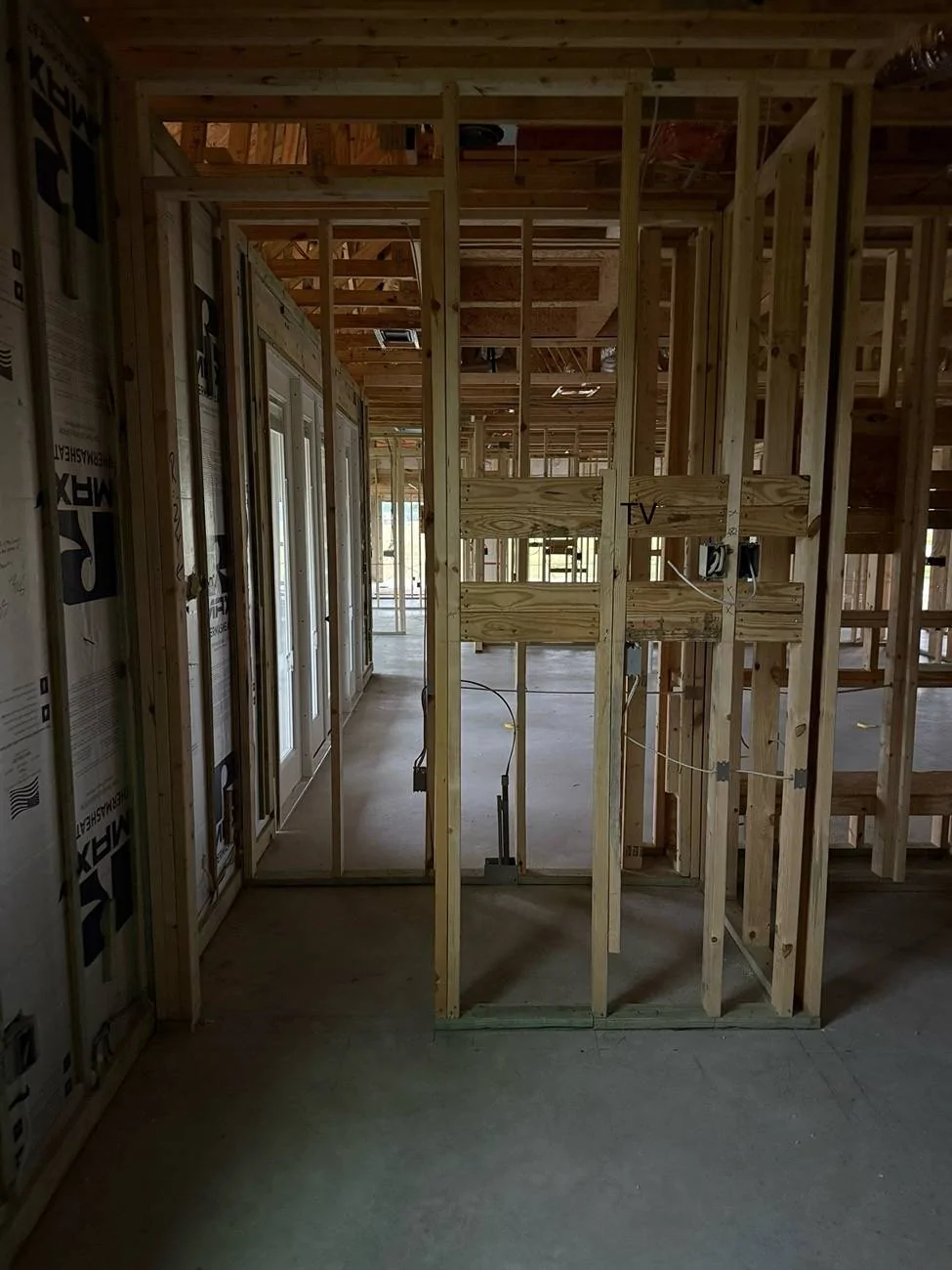

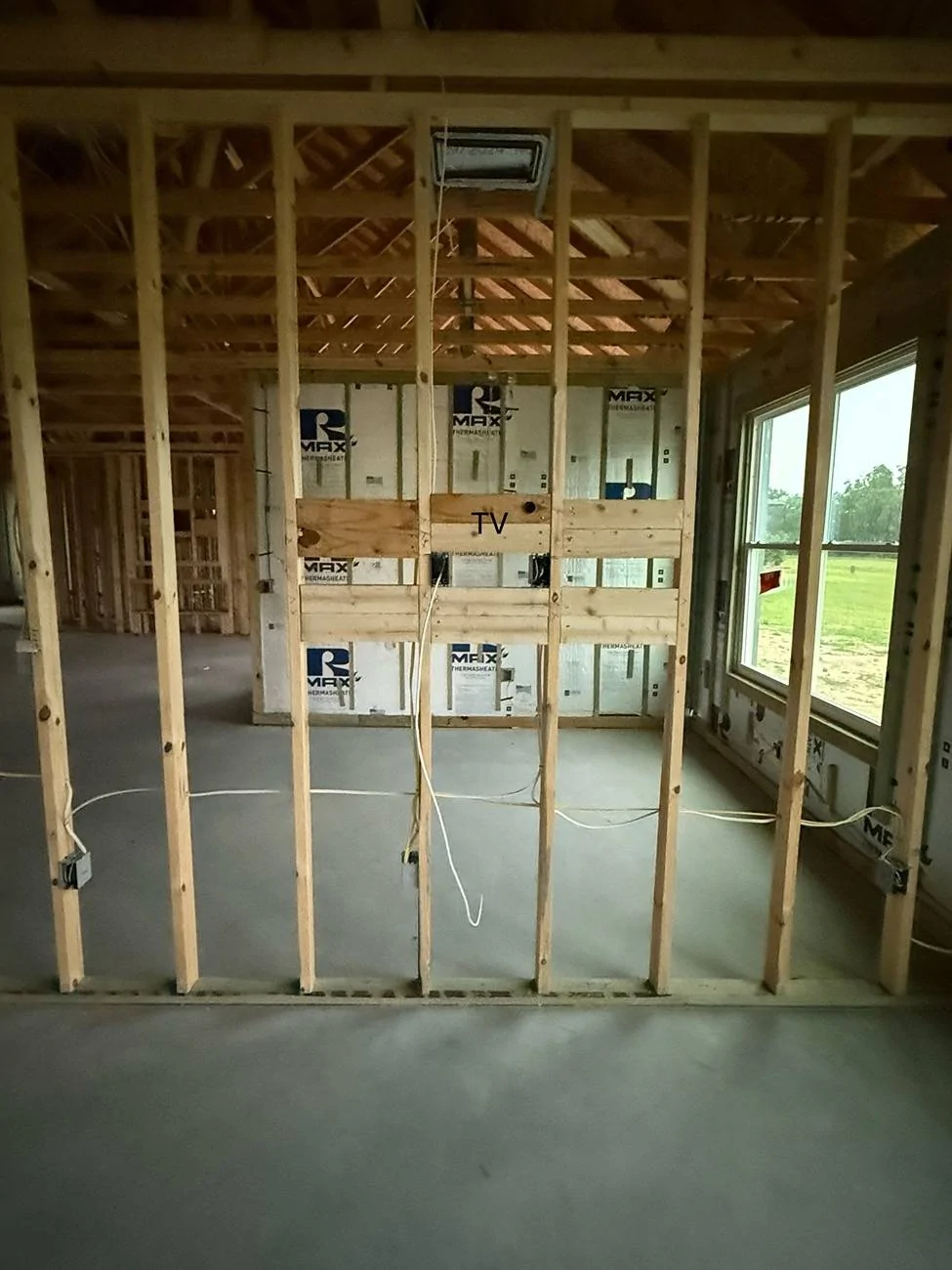

I’d like to point out a very simple, but important detail that was done to make life a little easier for me when it comes to mounting TVs and other items to the walls. I asked the builder to add horizontal bracing in certain areas throughout the house, so that I can easily hit solid mounting points and not have to take the long way around locating studs. I’ve already taken and recorded measurements to help me locate the bracing once the drywall goes up.

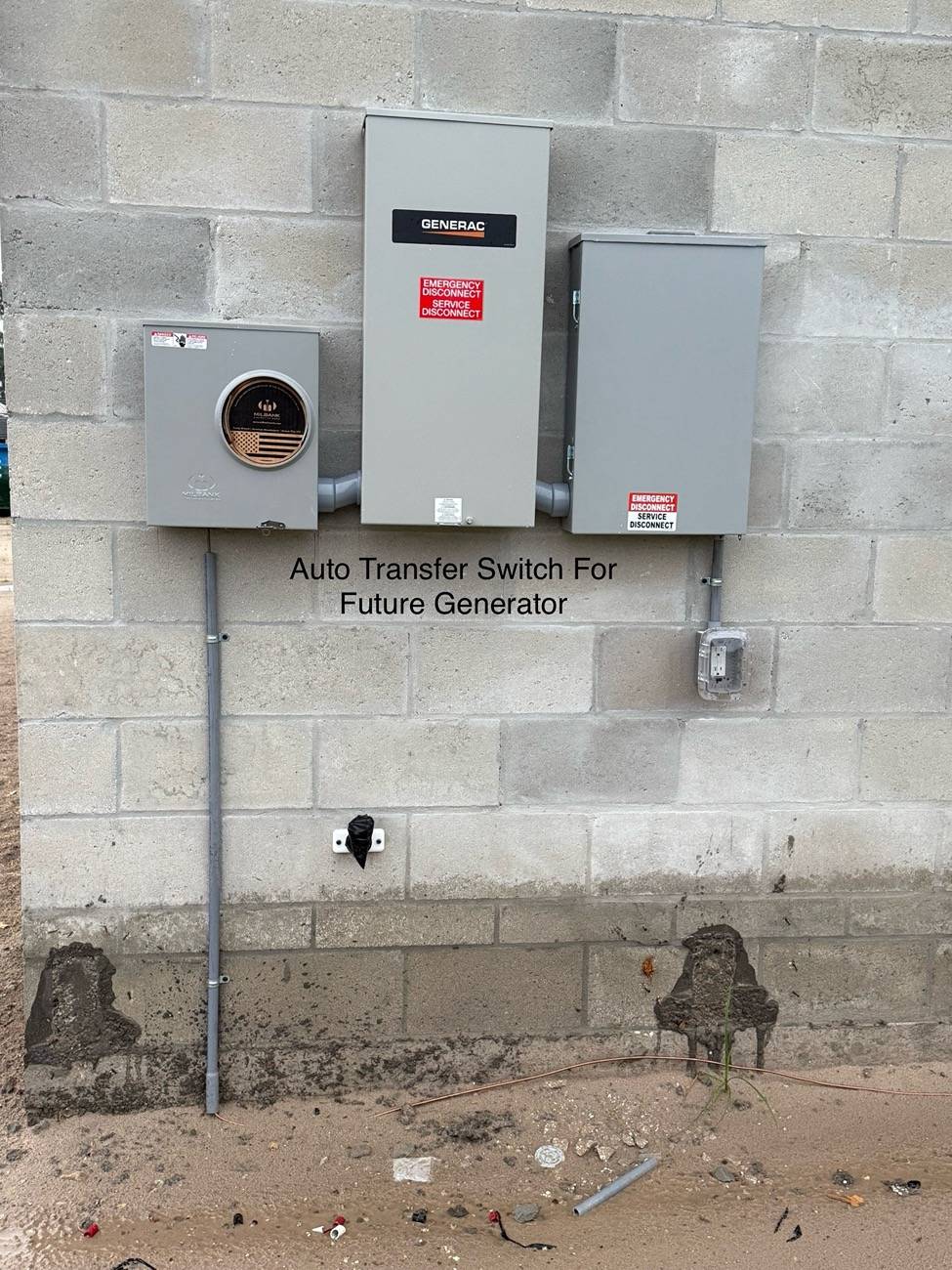

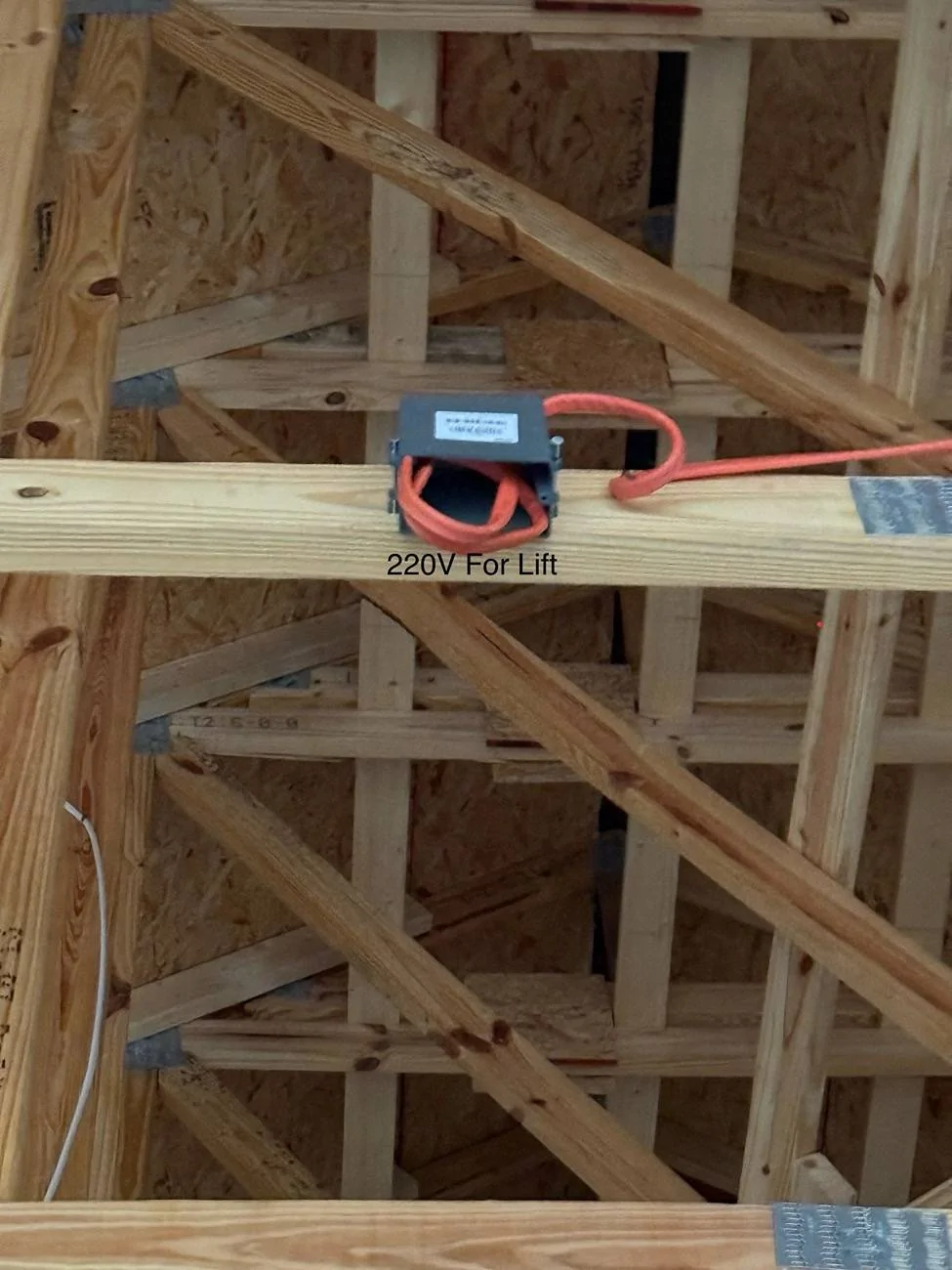

In addition, I had a few dedicated circuits added in the shop area for my hand dryer, air compressor, 2 post lift and mini split, as well as an auto transfer switch for a future generator.
Toilet paper and towel racks! You can thank me later.
Put about half a dozen outlets in the entertainment center. Seems you can never have enough. And don’t forget to pre wire for surround sound speakers.

2019 Bullitt
Toilet paper and towel racks! You me later.
This^^ is a good idea. I’ve had problems with the drywall anchors loosening up in the past from the repeated removing and replacing of the towels. A solid anchor point for those would certainly prevent that
There’s 4 in there now, but I can always add a power-strip if needed.
I get where you’re going with all of that but I’m a different kind of guy I guess. I think hanging TVs are the worst eye sore in a house. Can’t stand them and will never hang my TVs. Eye level is where they should be. My neighbors are gonna love me once I get it all hooked up.
