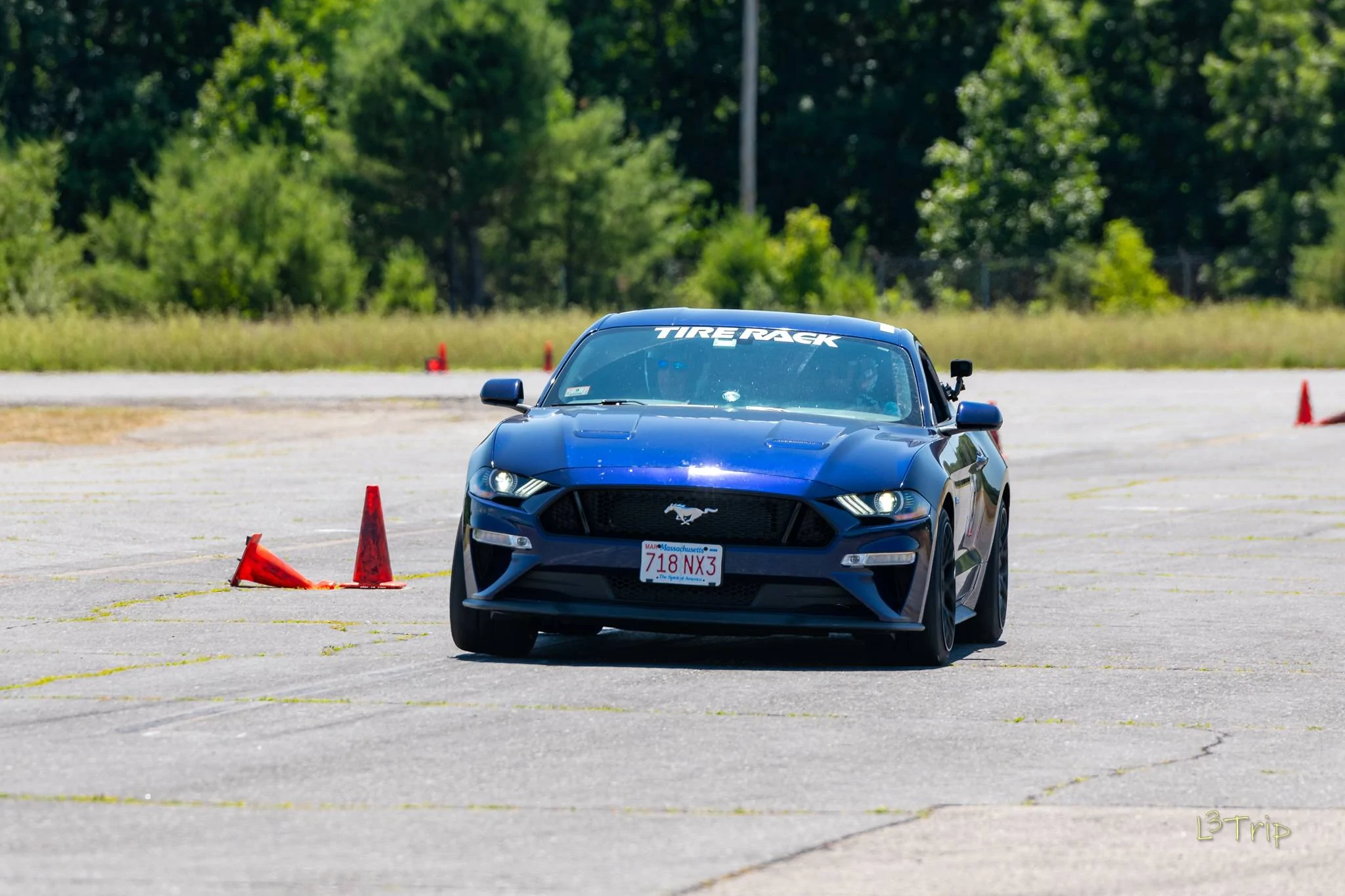

200 lb/in front springs are Charmin Ultra Soft. I’m certain there is plenty of body roll.
This is 250 lb/in and a 35mm front bar on full stiff:
The car is floppy.

okay, i had no idea (in new to these cars) so if that's the case then its probably the alignment like others have mentioned. its gotta be something simple since its not very modified.
man that car is gorgeous.
