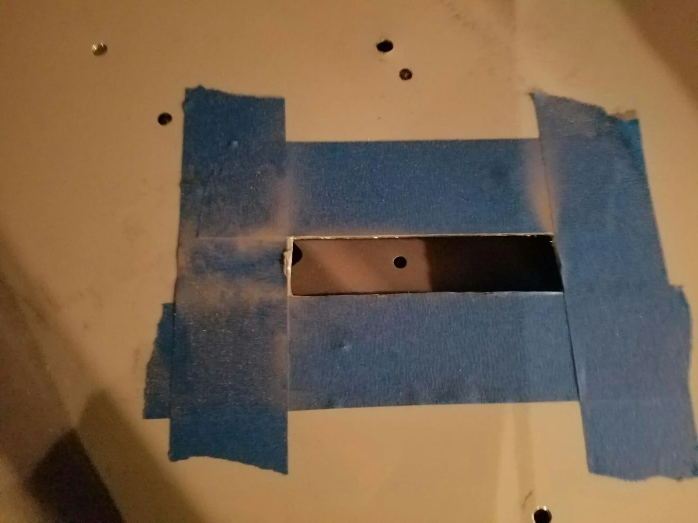

Well it does if you want more surface area to bond the two parts together and prevent failure....nothing to do with reversing the mod lol
Yeh, exactly that. My guys was keen to cut the smallest hole possible and worked more on taking as much of the under-casing of the vent away to leave as much glue-able area as possible.
He didn't figure on me being a prick and leaning on the bonnet just in front of the vent though!!

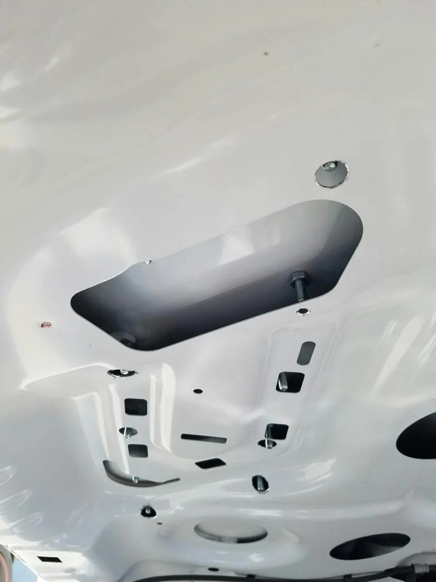

You cant bolt them. We are having to do a bodge job because ford didn't supply our cars with them and the hood is not designed to take them. Did you find a way to bolt them?
I did bolt mine down thru the top skin of the hood..i also used the drake heat extractors that I modified
..i would not recommend just using epoxy bonding glue or just 3M tape especially when these cars easily go over a hundred twenty miles an hour you're just waiting for something bad to happen.
Nice one, not sure how I'd get a bolt into mine, but a good idea.
