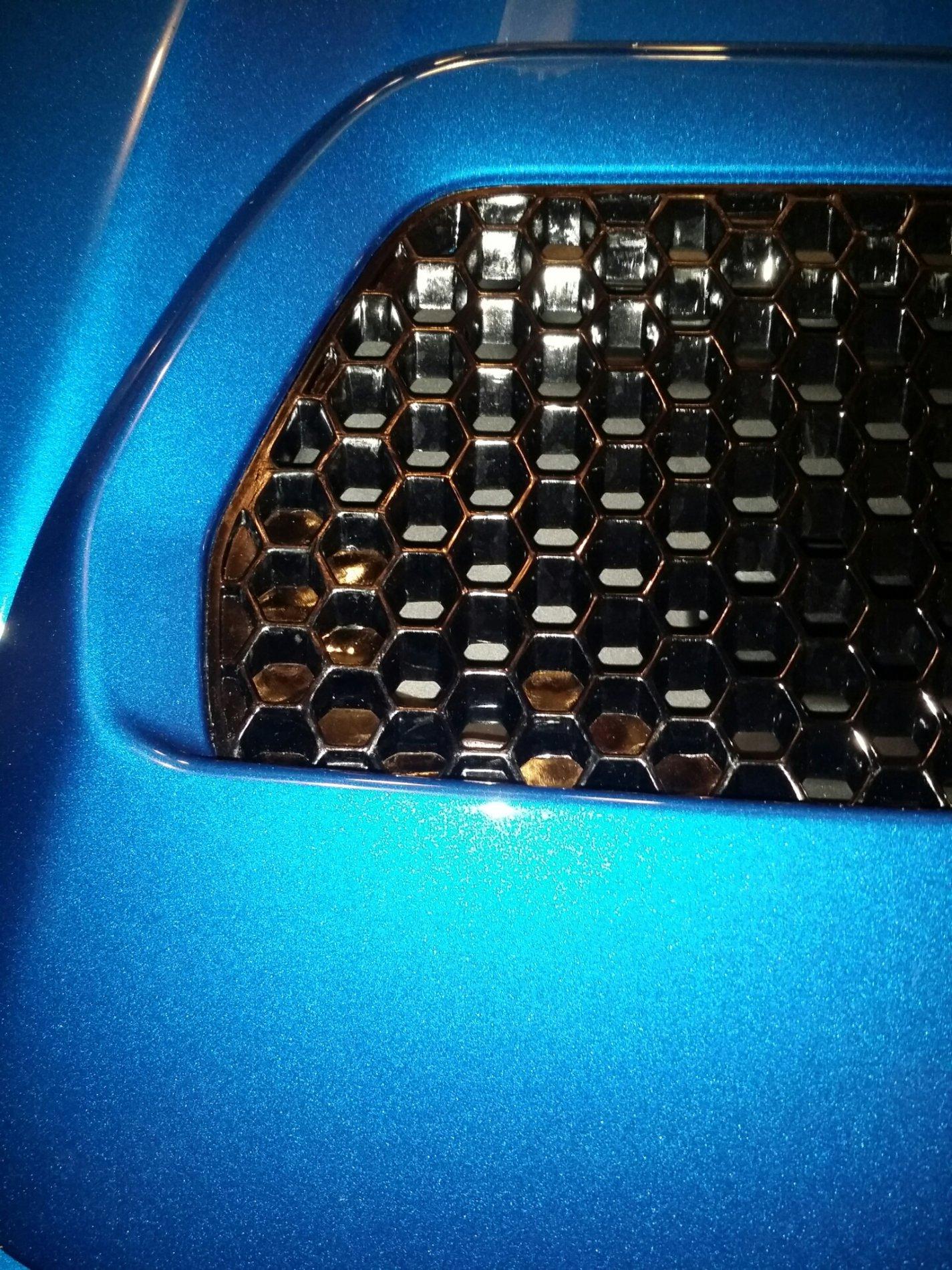

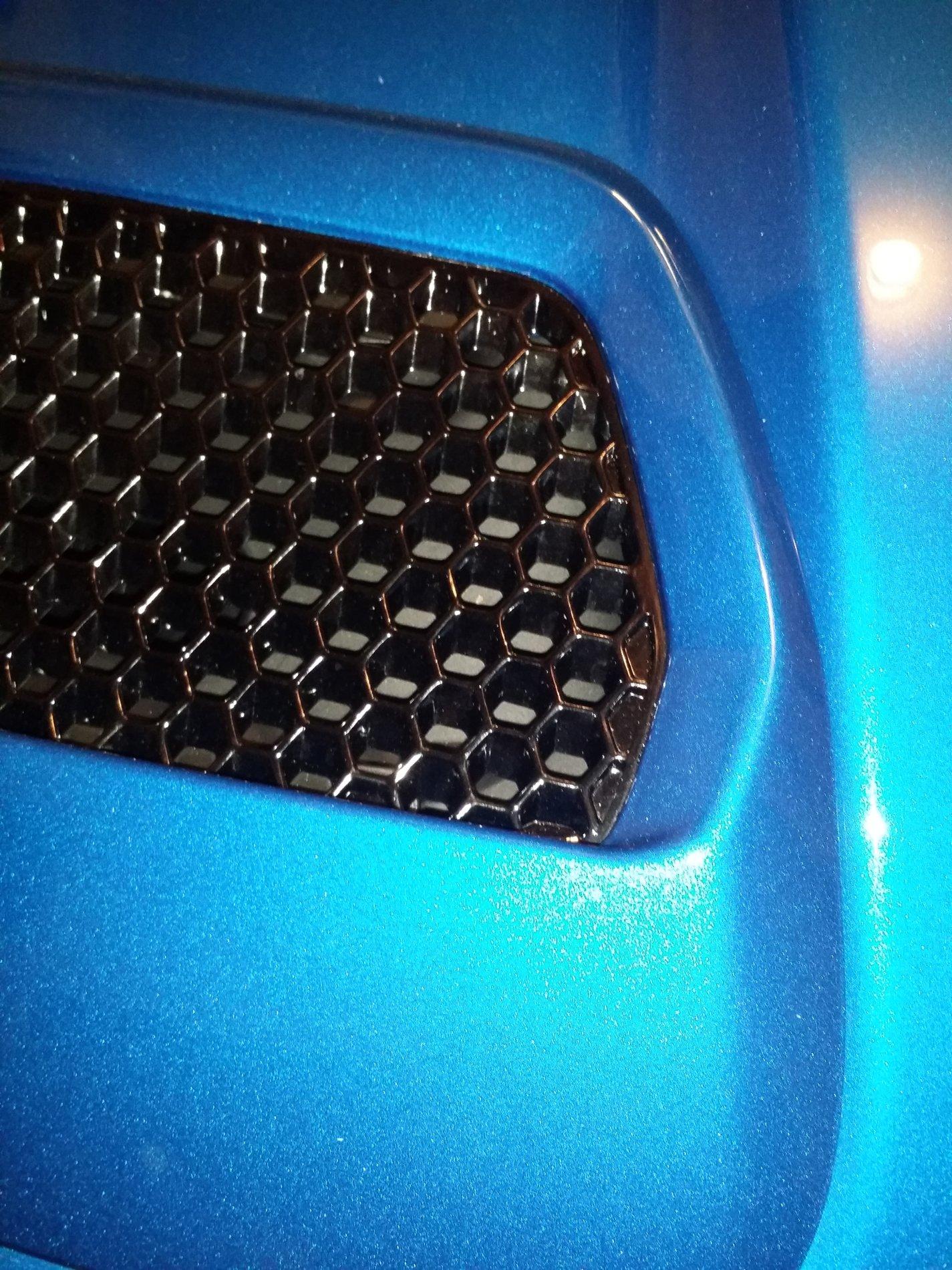

I was looking at the hood vents today. Checking them to see how they attach because I will be removing them to get PPF on the hood. I noticed the drivers side looked different than the passenger side. Some of the drivers side holes are plugged with plastic like it wasn't molded properly.
Passenger side. Looks good.
Drivers side. Not so good.
The honeycombs in the front left corner are closed.
Are they all like this? I would like to know before I take it in to the dealer. It's not a huge deal but it does look odd depending on how the light hits it.

Looks like simply excess plastic from the casting that needs to be removed. They do not at all look different and certainly not worth a service call. You may get some giggles if you took it in for that.
When you take them off I’d imagine the plastic excess will be paper thin and likely come off easily with a sharp blade.
I thought it was mold flash as well but I tried pressing a flatblade srewdriver into them and the flashing wasn't going to budge. I will see if I can clear them out from the back side when I take the vents off the car. Thank you for confirming it's not normally formed like this.
Thanks - I just checked mine and all are open so it is definitely flash. Good luck.
