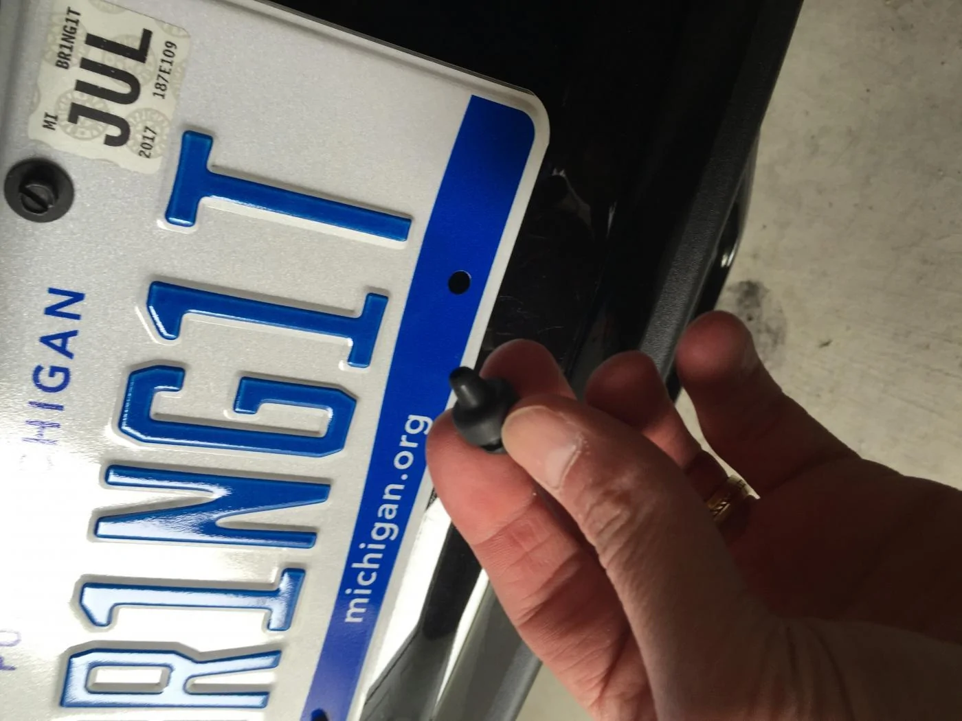

My fusion came with rubber mounts so I bought some for the mustang, only issue is it required drilling holes.

In lieu of drilling holes, pick up a package of Industrial Velcro. I bought mine at Lowe's. Place a strip in the center, bottom, of the plate and attach the plate to the car as usual, with the top screws. It will prevent the plate from flapping around and protect the finish. I cleaned the paint and plate back, with alcohol first. I had it on all winter, and took it off, with the plate, for Spring cleaning. No paint problems. Reinstalled new strip.
