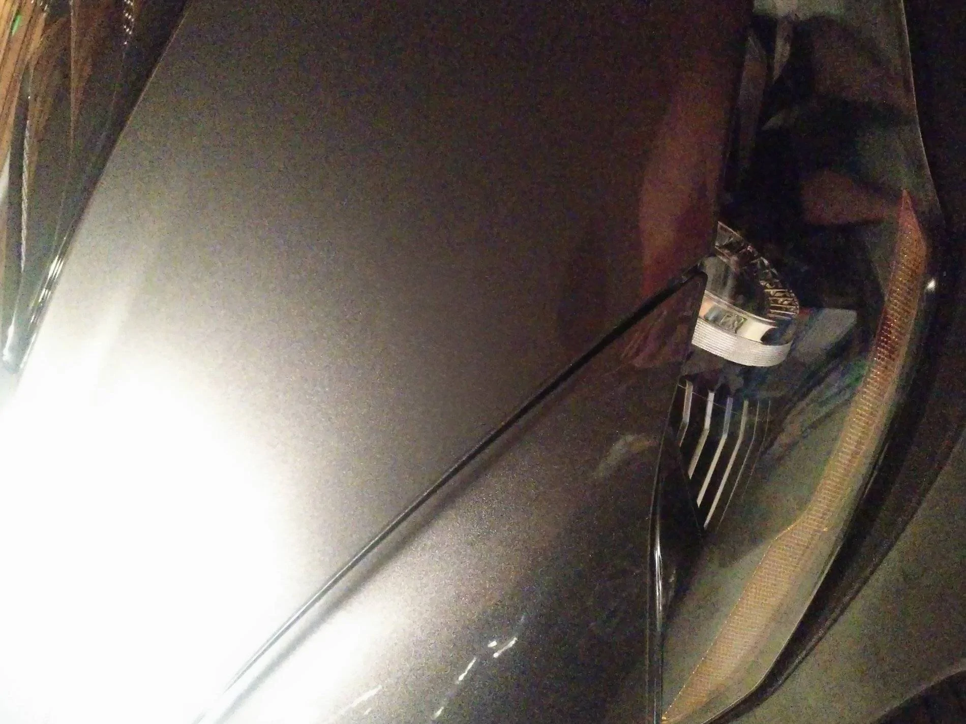

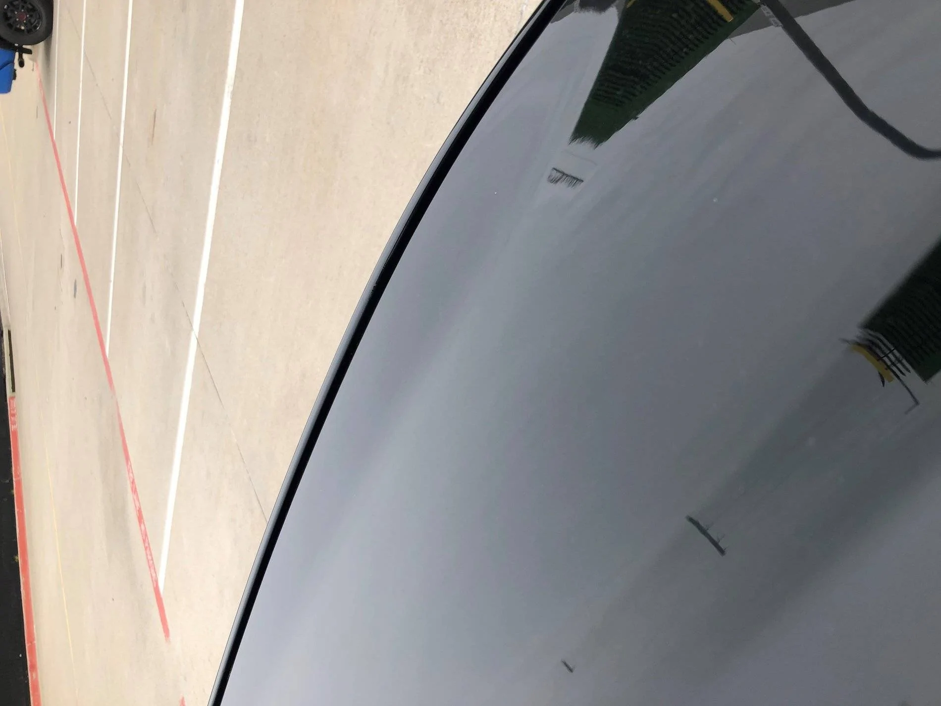

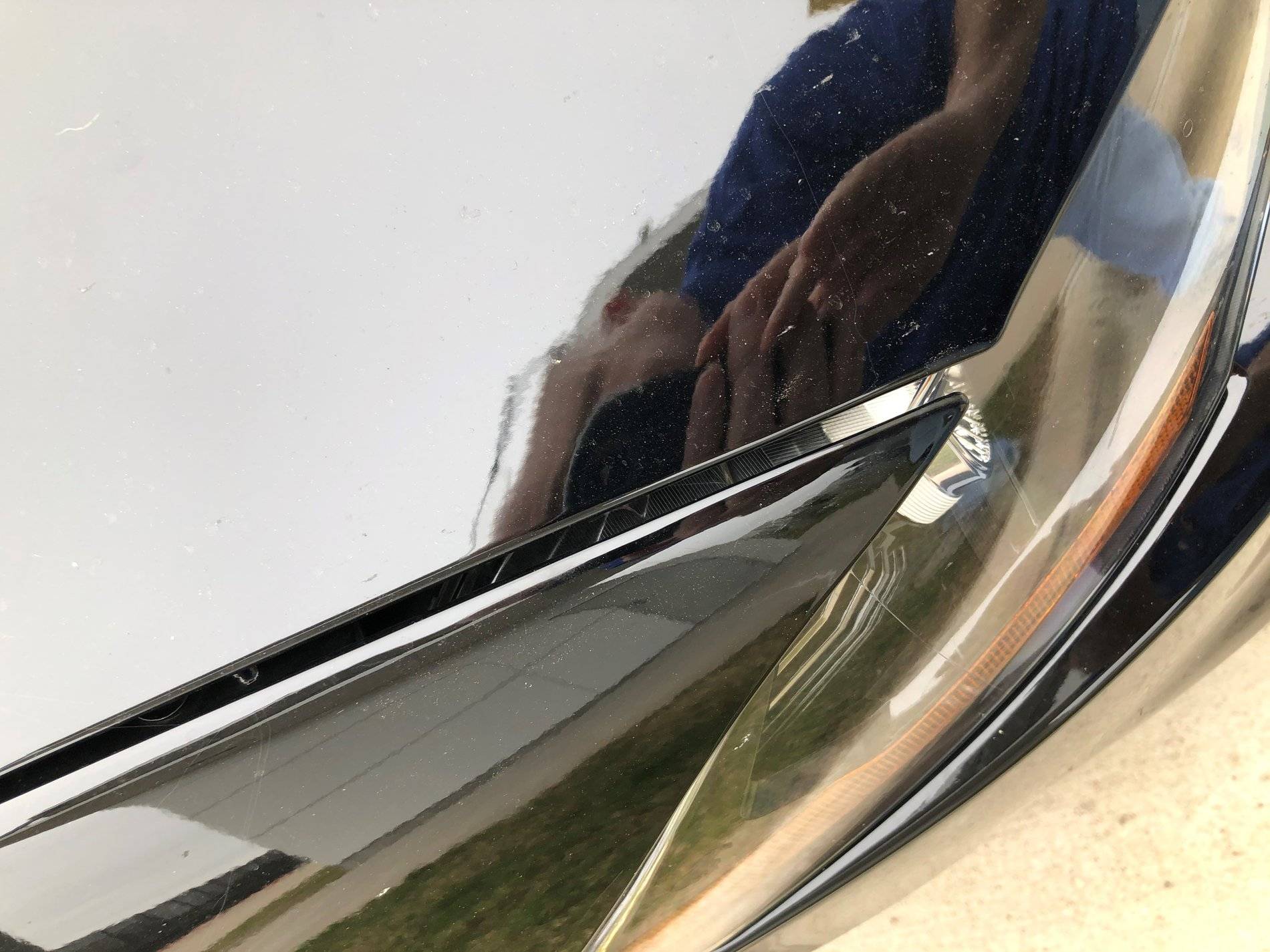

2019 GT - most of the panels on the car look OK, but these gaps in my hood and front fender can't be normal ??
I took this in to the dealer to be adjusted and first they told me this was 'normal' for Mustangs, and their 'fix' for the driver side height they just cranked that rubber hood stopper up, which just threw other things out of alignment.

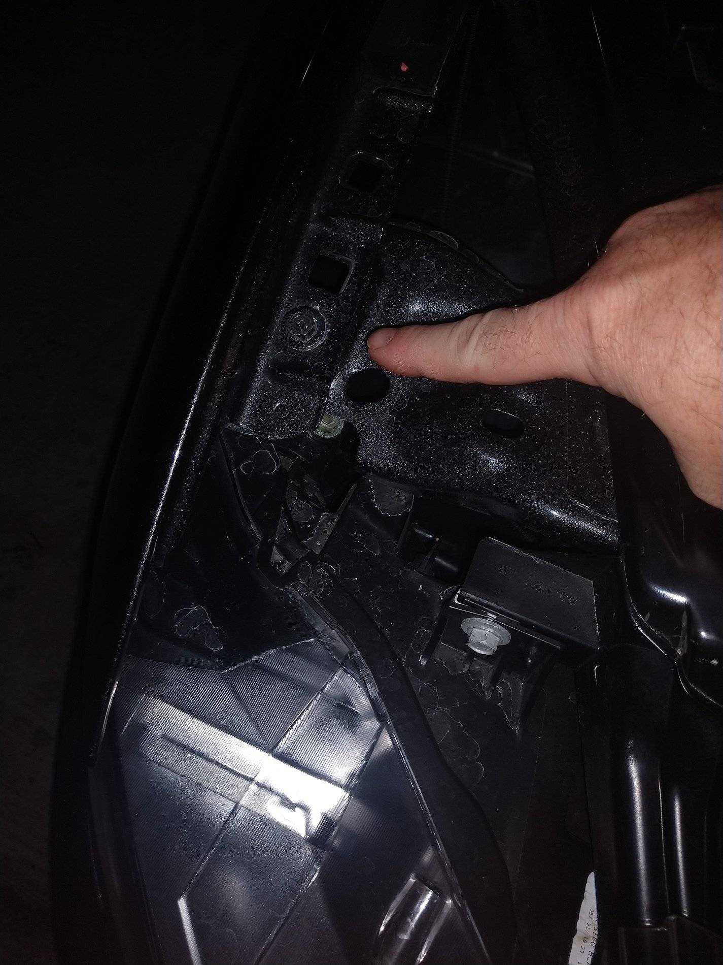

can you take a pic of the bolts you loosened? i will do this too
I losened this bolt maybe 1/8th inch and simply pushed the fender in and retightened the bolt down. This gap was over 1/4inch before and now it's identical to the other side of the hood....perfect
