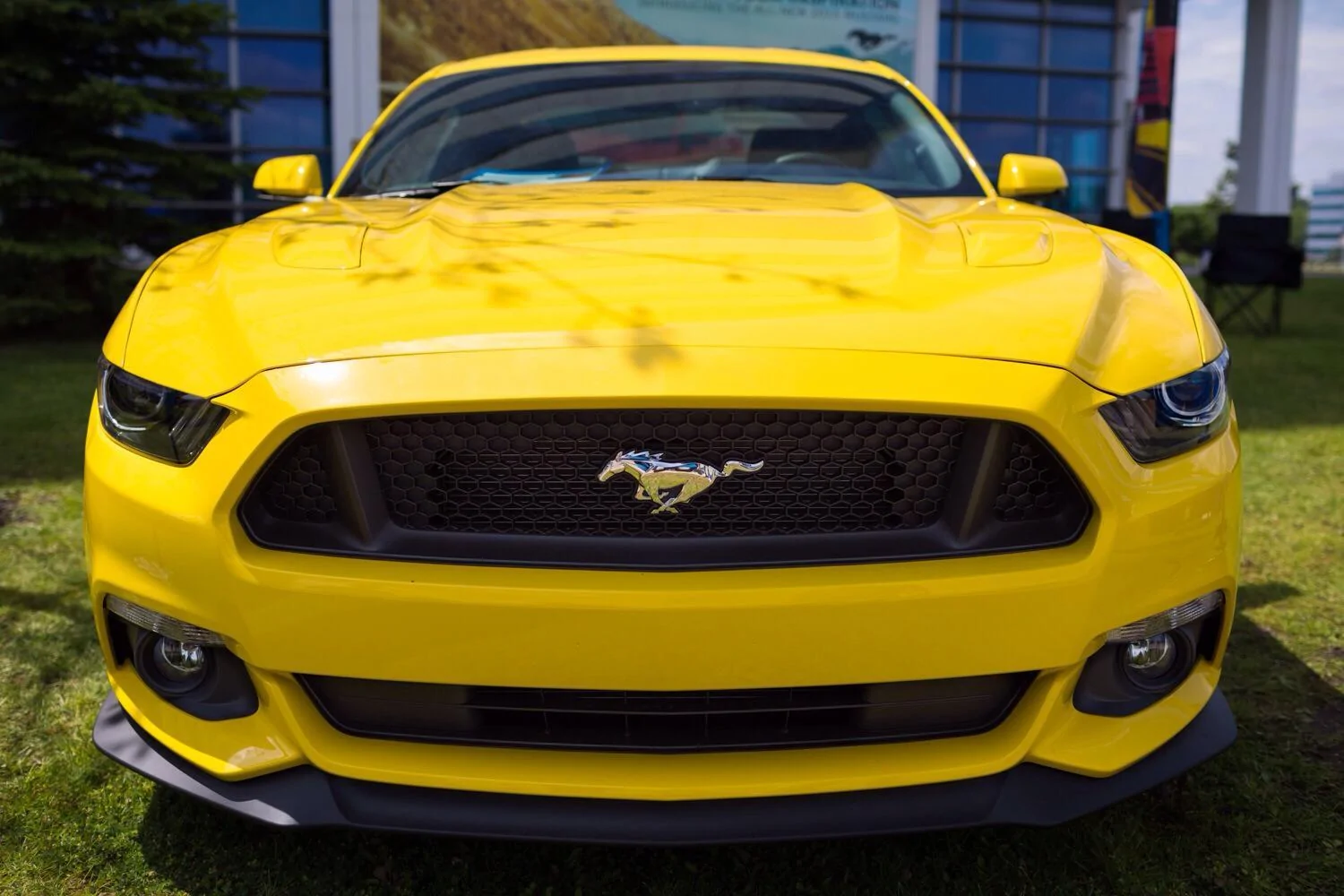

I've personally inspected these four right from the transport vehicle.
and deem them acceptable for-sale. Made my dealer aware of panel issues (sales guy was / are clueless) I'll be buying from his lot.
There's no-way I'm going to purchase a new car and then take it to a body shop... NO WAY!
