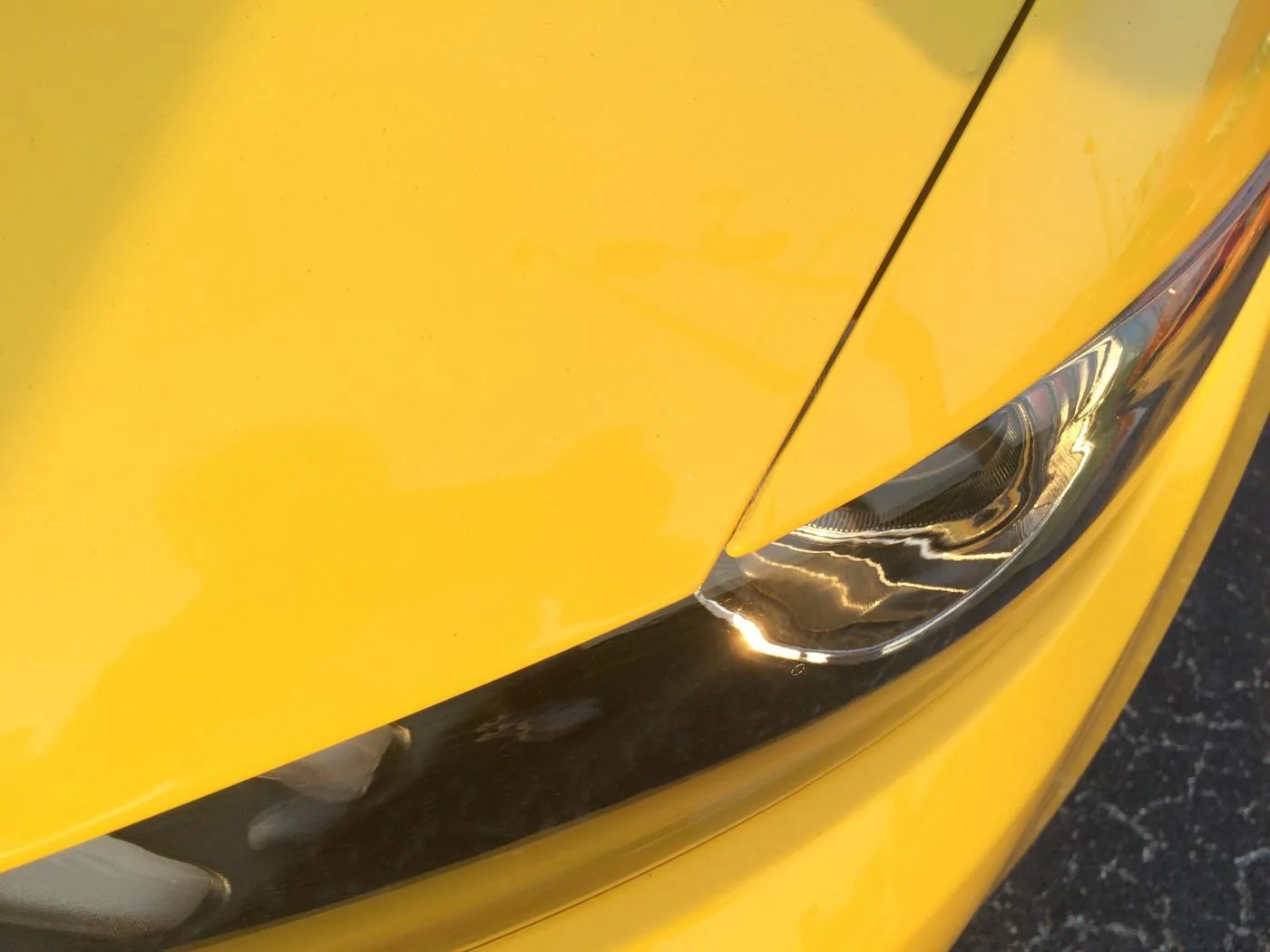

Two days ago I saw this misaligned hood on a new GT on the dealers front line display in central Florida. The hood and fender were so close you could not get a business card between them. The paint was chipped and would need a touch up. The door and fender panels looked to be OK, but I couldn't open the door to check. My car is being built this week.......hope they have figured out how to assemble the car by now

Yeah I really hope Flat Rock figured things out with these alignment issues.

for what its worth, this car might've been built during their December disaster...cars after that were greatly improved in the fitment quality from what ive seen.

That hood fender issue is an easy fix. Loosen the bolt securing the fender in the front and pull it out a hair then tighten the bolt if the paint isn't rubbed it's a 5 minute fix. My dealer did the fix to my car and it's now fine.
