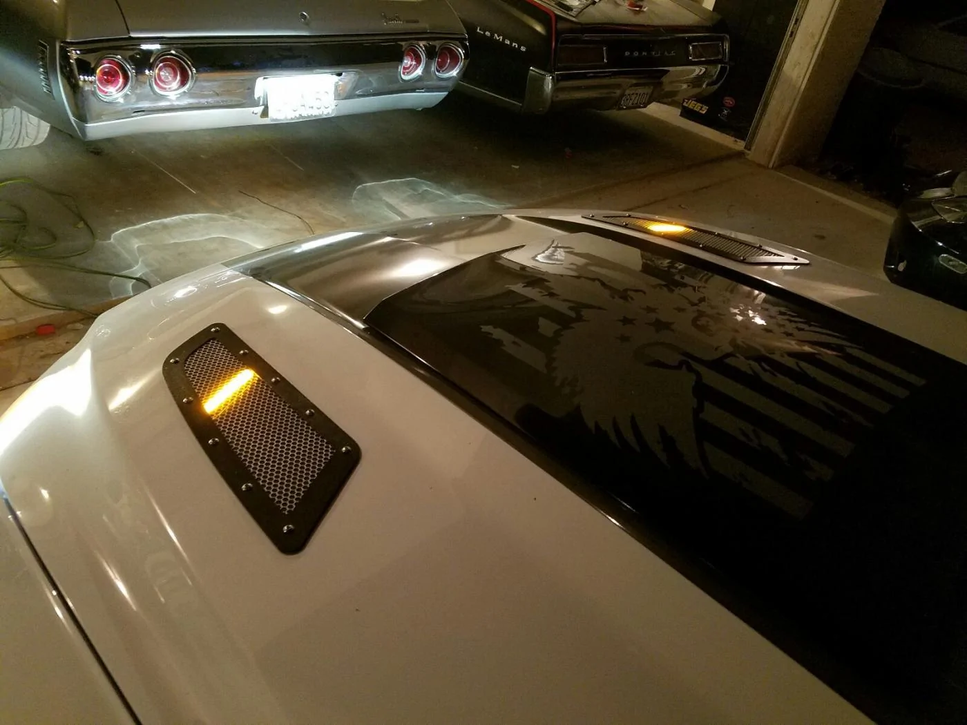

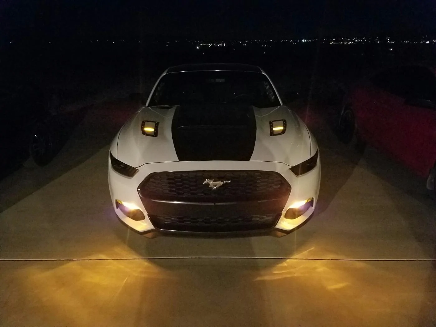

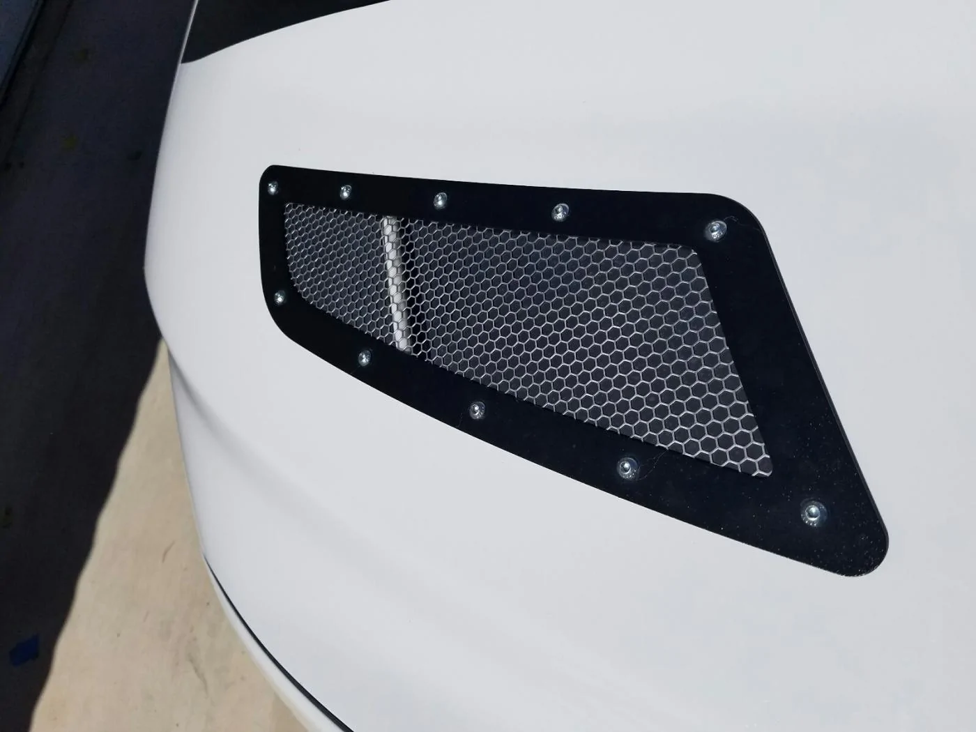

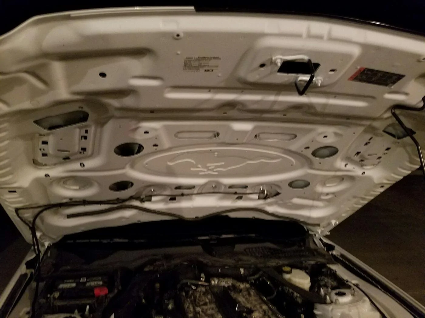

DRAKE Heat extractors on a EcoBoost Hood ..WITH LED turn signals

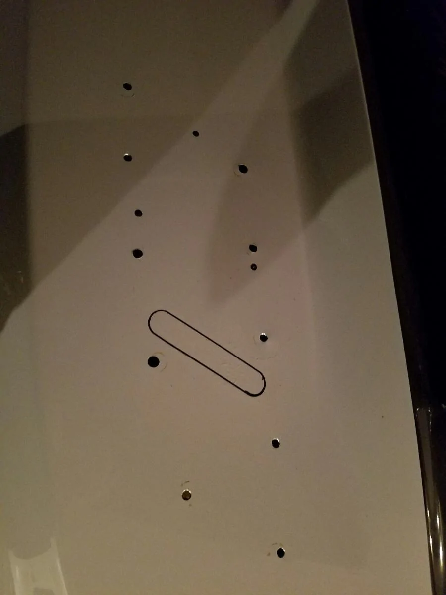

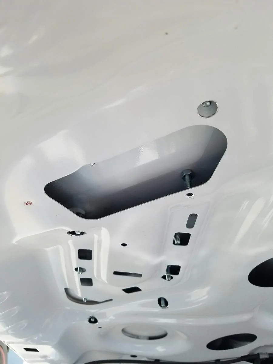

Yes it was work ..but not to hard to make the Drake heat extractors work on the EcoBoost Hood.. ther was some modification that has to be done to the heat extractors before you can put them on the EcoBoost Hood..so that it will fit perfectly flush..I had to order new longer button head bolts... because you will be Drilling 10 holes per each heat extractor on both sides . Where is the GT Hood it's only that the 3 bolts that holds the heat extractor down..you won't be using the front suppled mounting bracket that comes with the Drake Heat exchangers . Also you will need to notch. The inside backing plate that goes under the mesh screen so that all the bolts can go thru the hood ..... and that's pretty much all that you have to do to the heat exchangers to make them fit flush ..once you get them in the exact location that you want them use the Heat exchangers themself as a template .. use a Sharpie as reference to all the points to be drilled .once you take the heat blanket off the bottom of the hood..you can see the stamping for the Factory heat exchangers location.this will give you a good reference point...I can't stress this enough. Measure and double check your measurements before you attempt to making holes..
Elvis66
Sep 17, 2016
1,498
1,585
High Desert California
Brandon
2019 mustang GT ..2014 Camaro ..72 Chevelle ..67 LeMans..97 4runner..2001 tundra

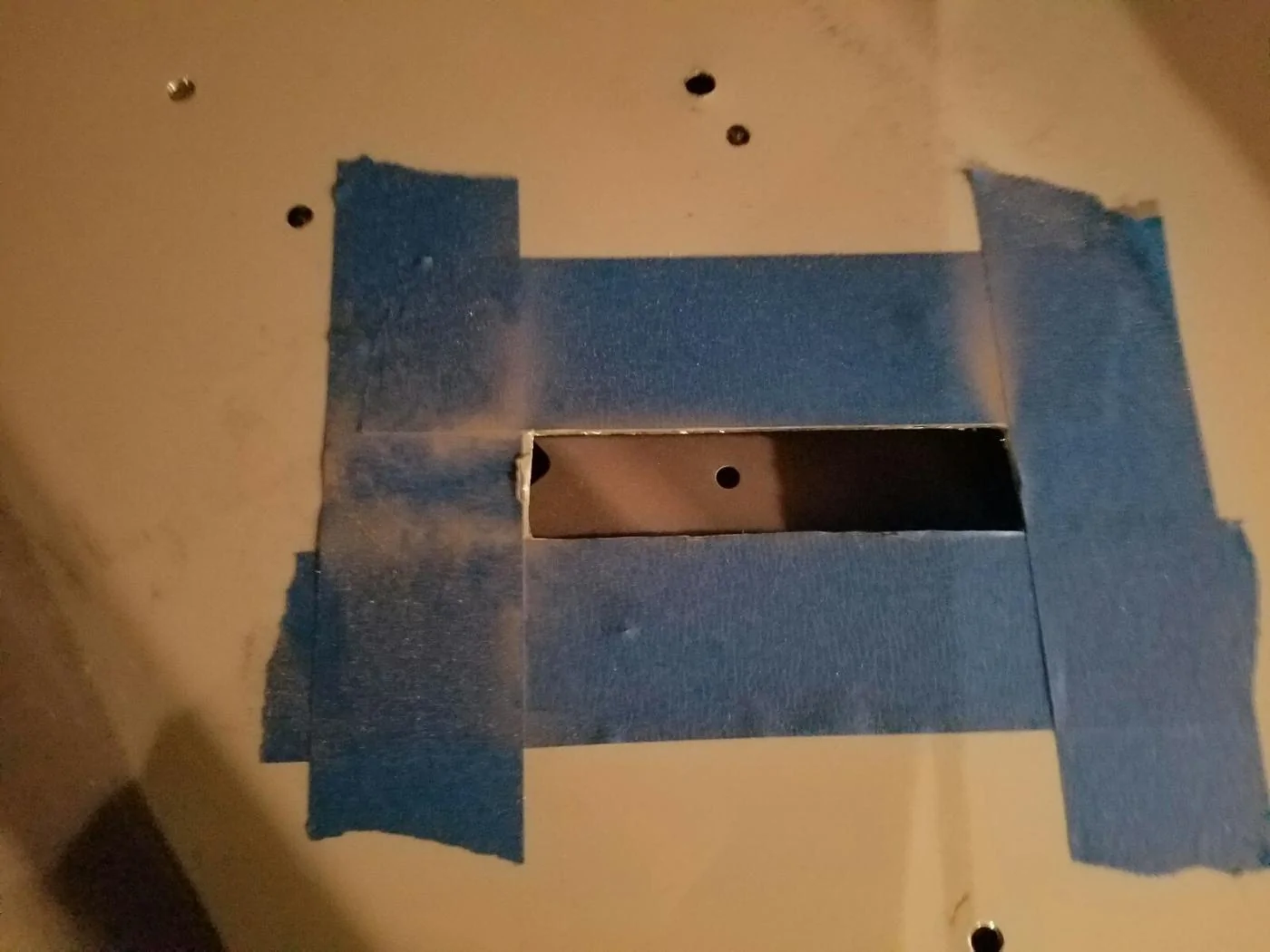

I recommend using a step drill bit because it makes the holes really nice without pulling up on the sheet metal. The supplied backing plate that comes with the heat exchangers has an opening for the airflow.. use this as your template that you will be cutting. I recommend using a small little metal cutting wheel that you can use on a Dremel so you have control and precise cuts..mask off surrounding areas with good painters tape.when your cutting .. use a face shield or eye protection... after that I bolted everything together was really happywith the out come .. no more hood fluttering.. after that I figured would be a good time to add the hood turn signals...Starkey Products makes an amazing kit .. with a little bit of modification with the Drake heat extractors I was able to make them work

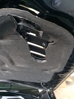

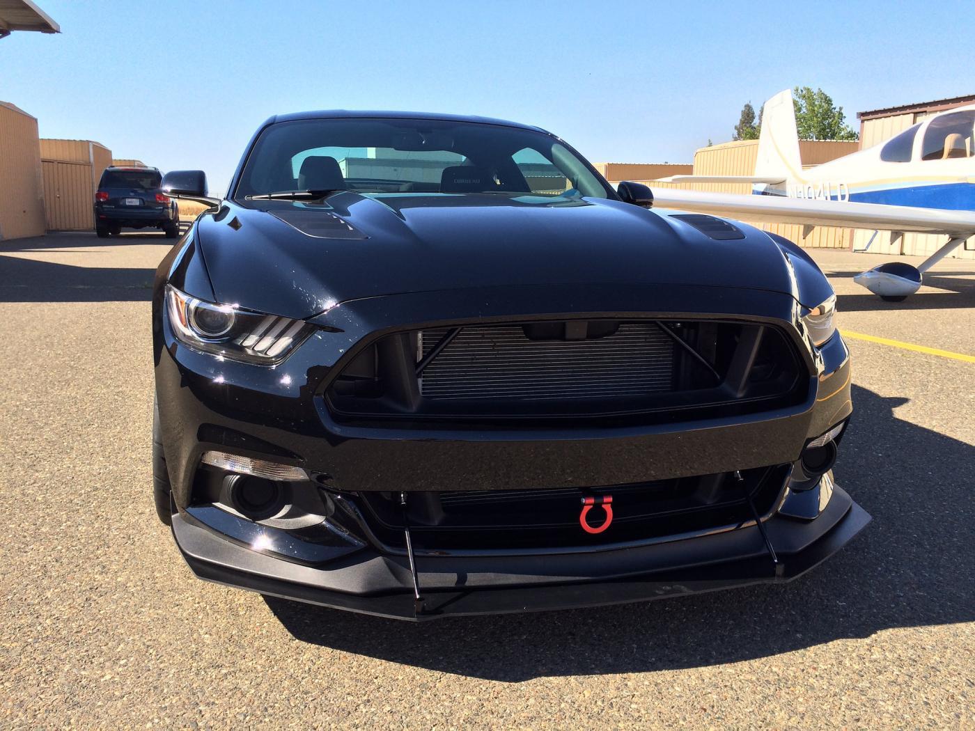

I've got a gutted stock grille with way more air incoming than stock, and no appreciable hood lift/flutter at ~125mph on the long straight at Thunderhill 3mi course. Key was my gutted Roush vents - meaning I cut out the bottom of the vents, hood opening, and hood insulation. You can see the effective difference in outlet area in the pic where I'm holding the stock hood vents next to my setup.
Helps keep the beast cool with that much air moving through, also did Reische 170 deg thermostat to start at cooler temp.
