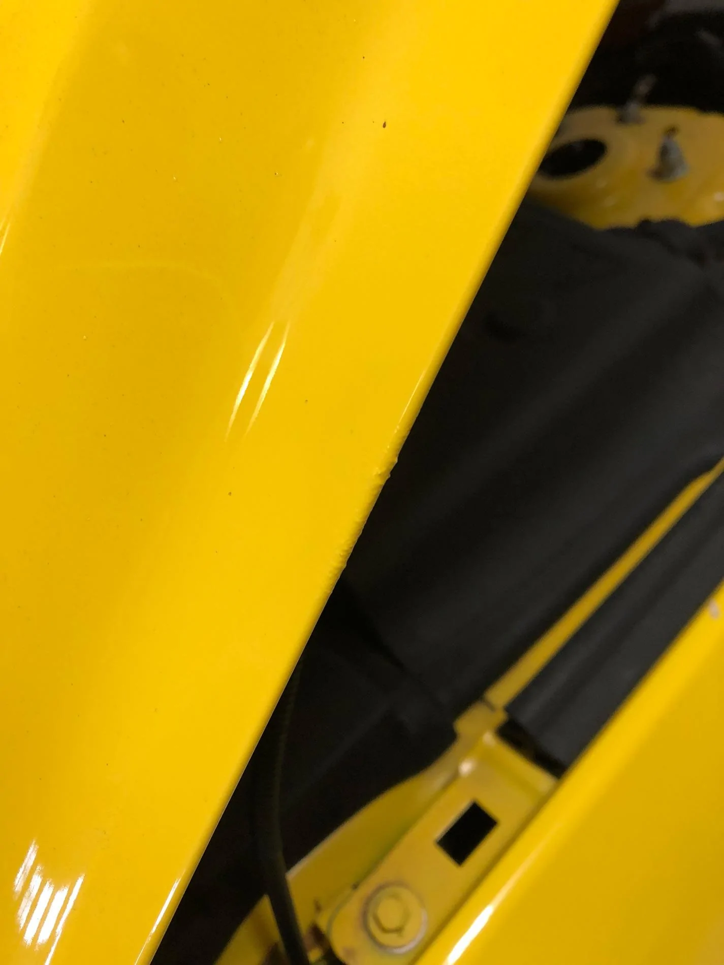

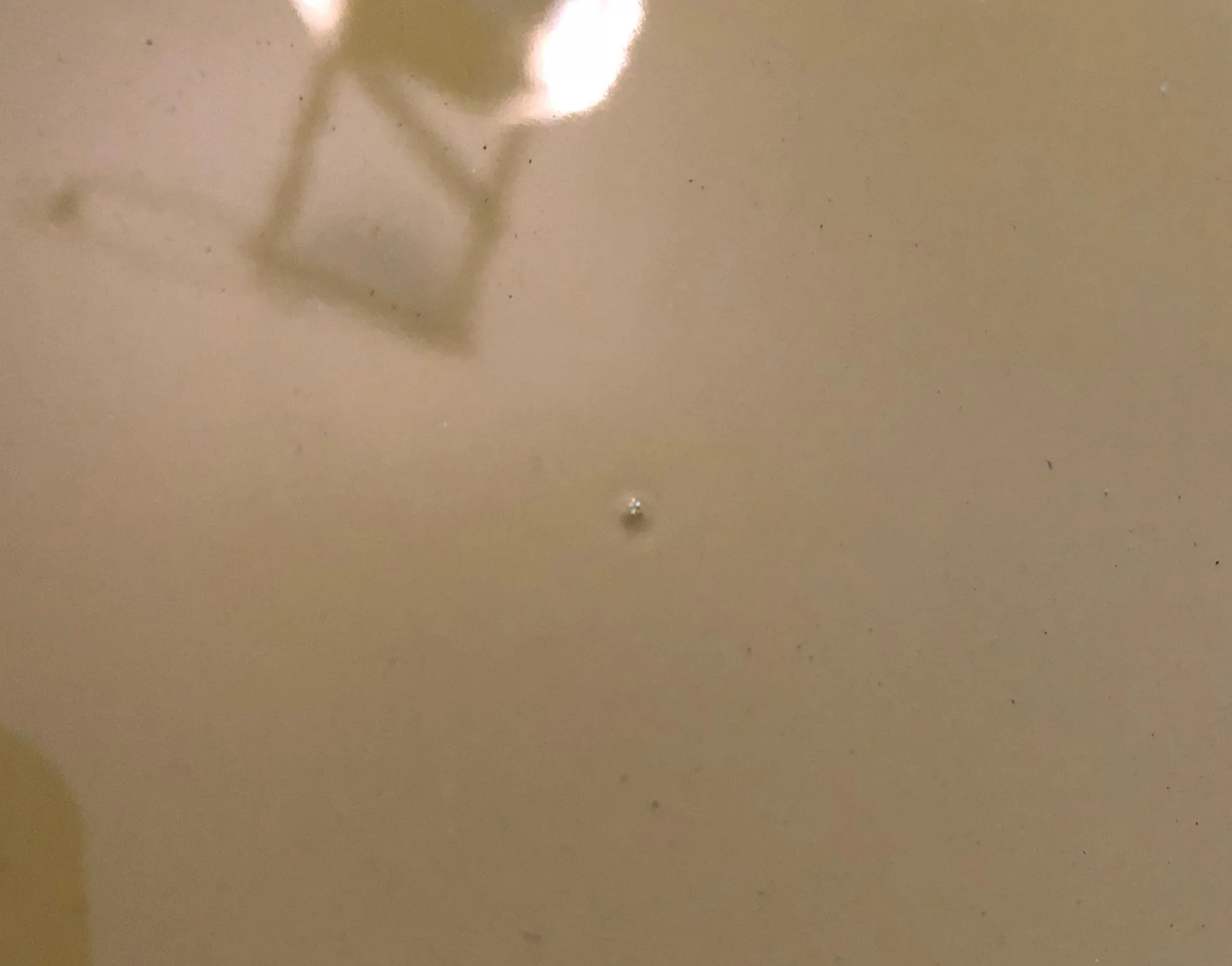

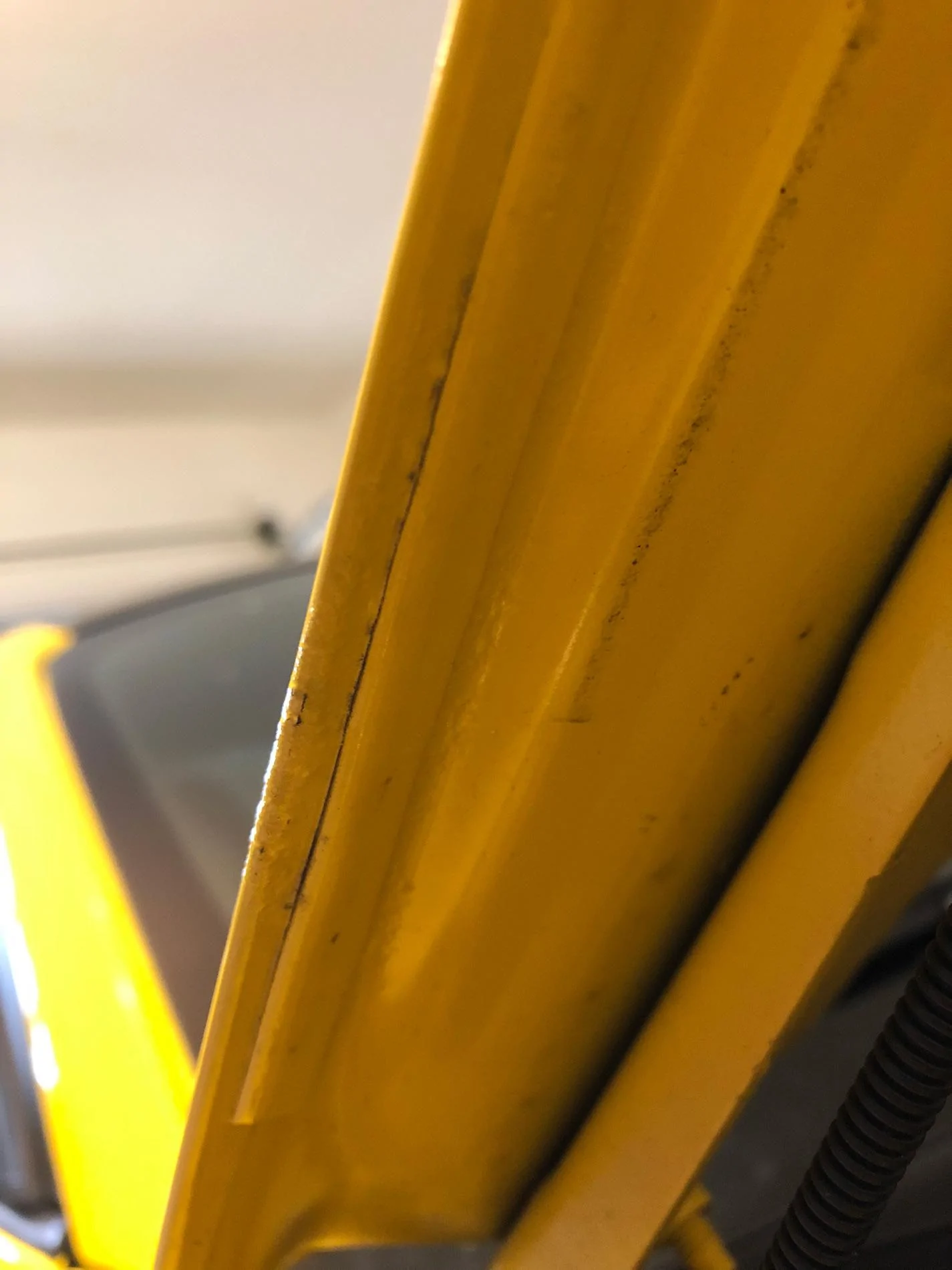

So I picked up the car last Monday. It was raining and they parked it outside, so it was all wet which made it very hard to REALLY look at the paint. I spent a good 10 minutes going over all the edges and surface areas and it looked pretty good (aside from minor orange peel which I was planning on polishing out after it cured). Well, last night I finally had a chance to look at the car while it was dry, and this little gem popped out. I guess I'm taking it back to the dealership and going to be without my car for another week.
(The car is slightly dirty right now, that's all the black specs.)
