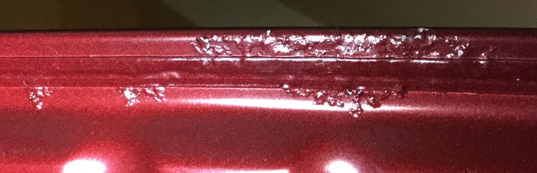

Car is going in tomorrow to have the hood replaced by Ford.
All under warranty. 2015 with 16K miles.

The corrosion is in the seam where the aluminum skin is folded around the hood. The only way is to replace the entire panel.

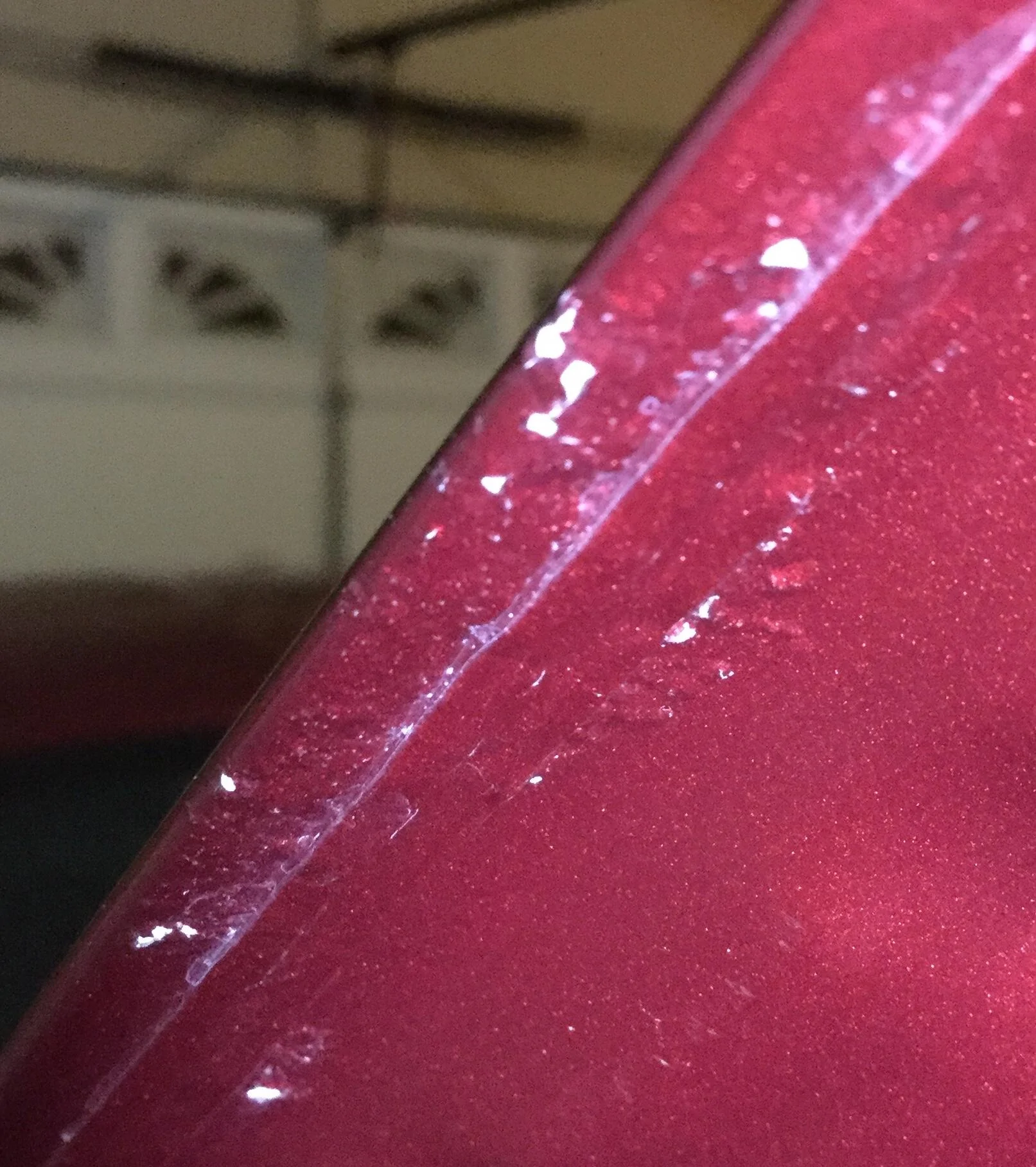

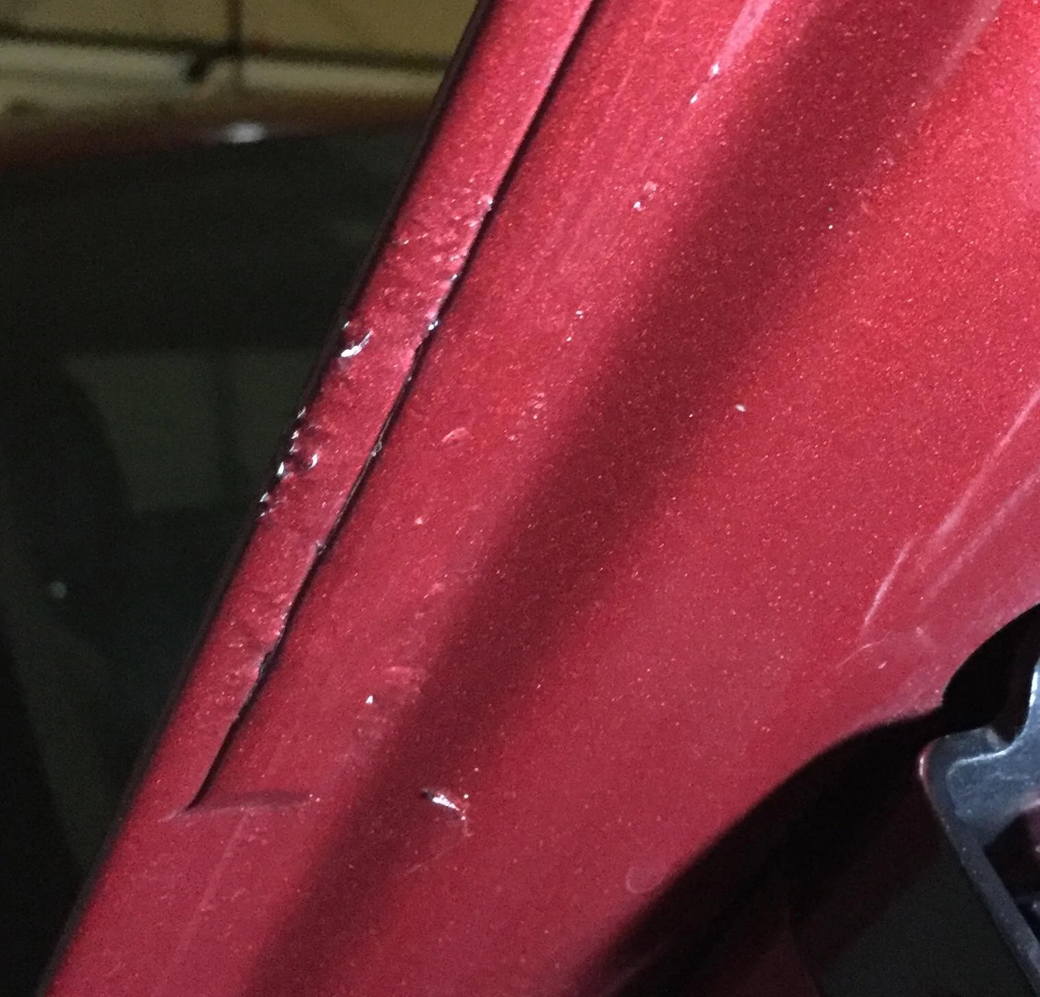

My 15 Ruby Red has the corrosion breaking through and dropping white powder.....2 weeks till my 3 year warranty expires...time to take it in. I am Pissed. Was trying to keep paint all factory and keep the car for 10 plus years....now I am sure any repaint will look like crap in a few years.....only 19 k garage kept, only in rain a few times....
Galvanic corrosion doesn't need water to occur. It's a chemical reaction between aluminum and steel.

Mine has been submitted to Ford by my dealer for full hood replacement.

UPDATE, so far Ford has denied warranty claim, Dealer says they want to see holes or erosion in the metal. So if we scrape paint off, and there are divots in the aluminum I can resubmit claim.....will update in a week or so...

My dealer was no questions asked. They sent the pictures to Ford and just took care of it all.
It is a known issue within Ford.

Dealer took care of mine no questions, just took photos and submitted the claim to Ford.
Also, the original plan was simply to repaint, but I was told there was electrolysis which would resurface if only repainted. The whole hood was replaced under warranty.

Wow ford refused mine but it s very small compare to your situation. It s very obvious here. If you or the dealer scratch one of the buble and manage to see a white powder it will be a proof that is galvanic aluminium corrosion that occurs due to iron contamination.

IMO, Ford should do the right thing in your instance, because that is CLEARLY a metallurgic issue, which will only proceed to get much worse as time passes. Even if the car never sees moisture or salt to add to the existing corrosion, that metallurgic reaction just continues on its own - very much like once a metal body panel has been breached with rust. The only way to resolve rust or metallurgic issues is to cut it out or replace the panel.
