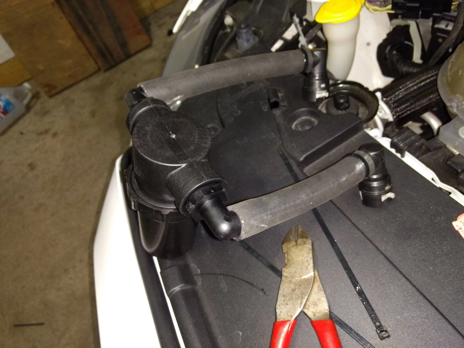

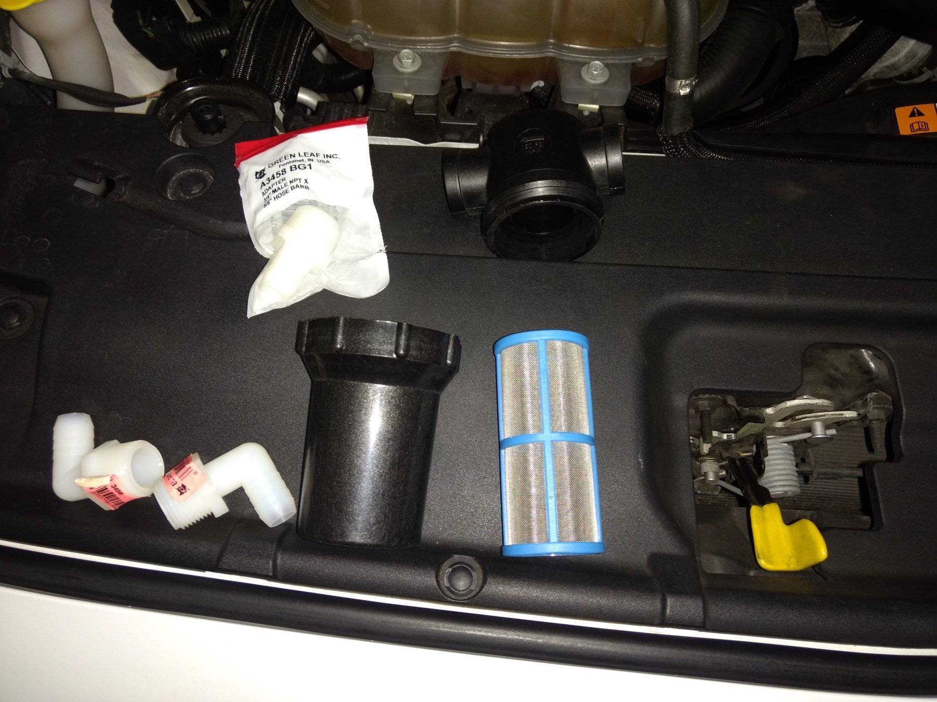

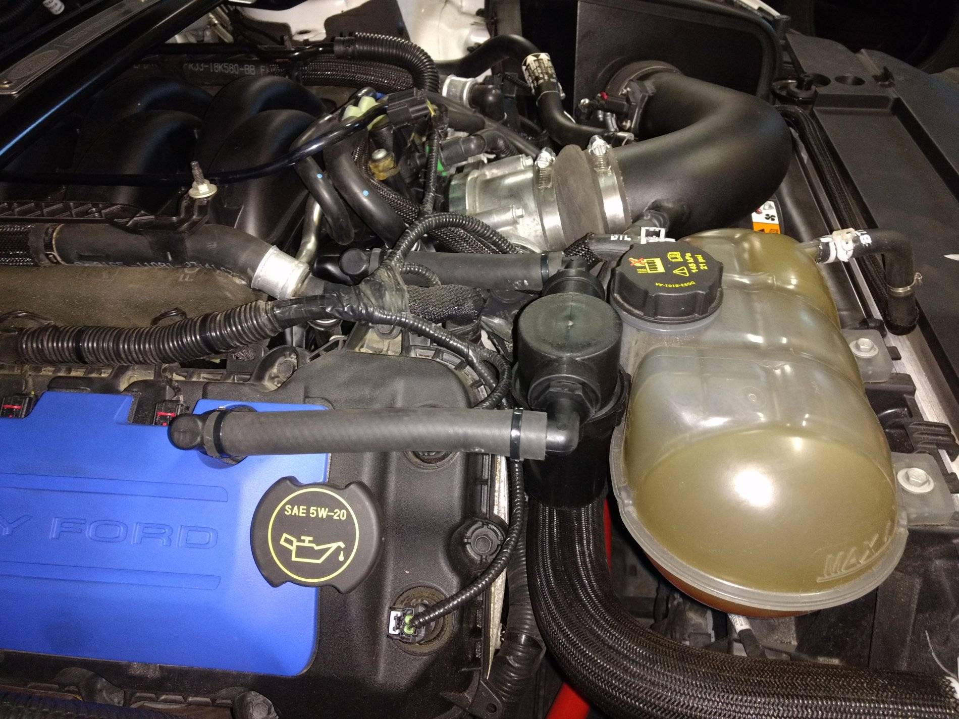

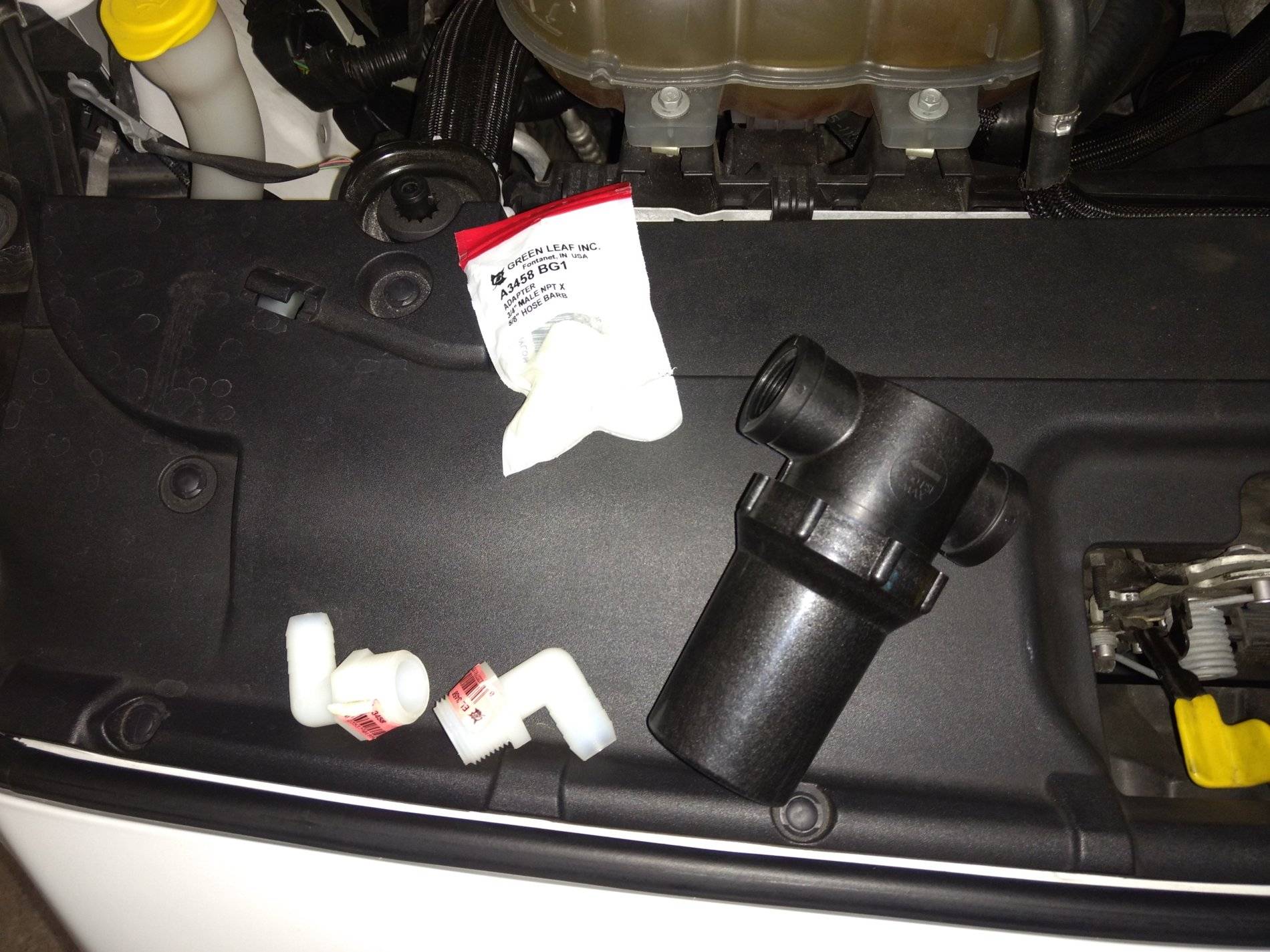

So I spent $29.96 for my homemade catch can. Looks pretty good I think. I got my parts from tractor supply and AutoZone for the hoses. Used the quick connects from the stock line. The can itself is made to flow in one direction, and has a built-in filter. It's used for farm chemical sprayer's I think it's going to work pretty good.
