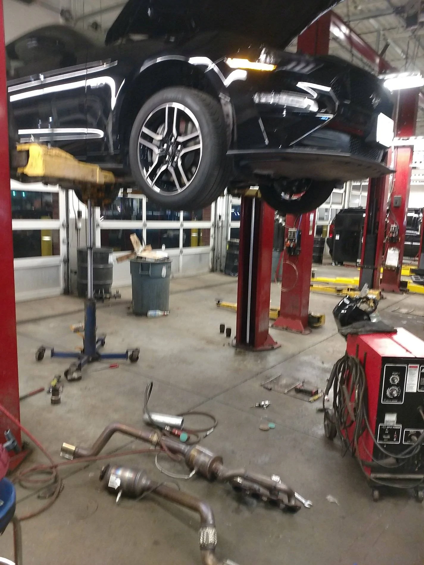

2019 Ford mustang gt

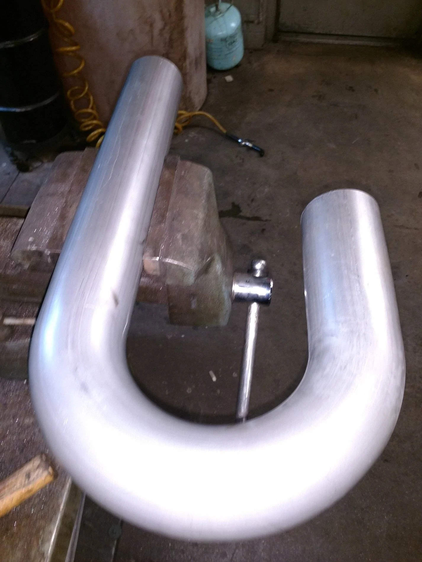

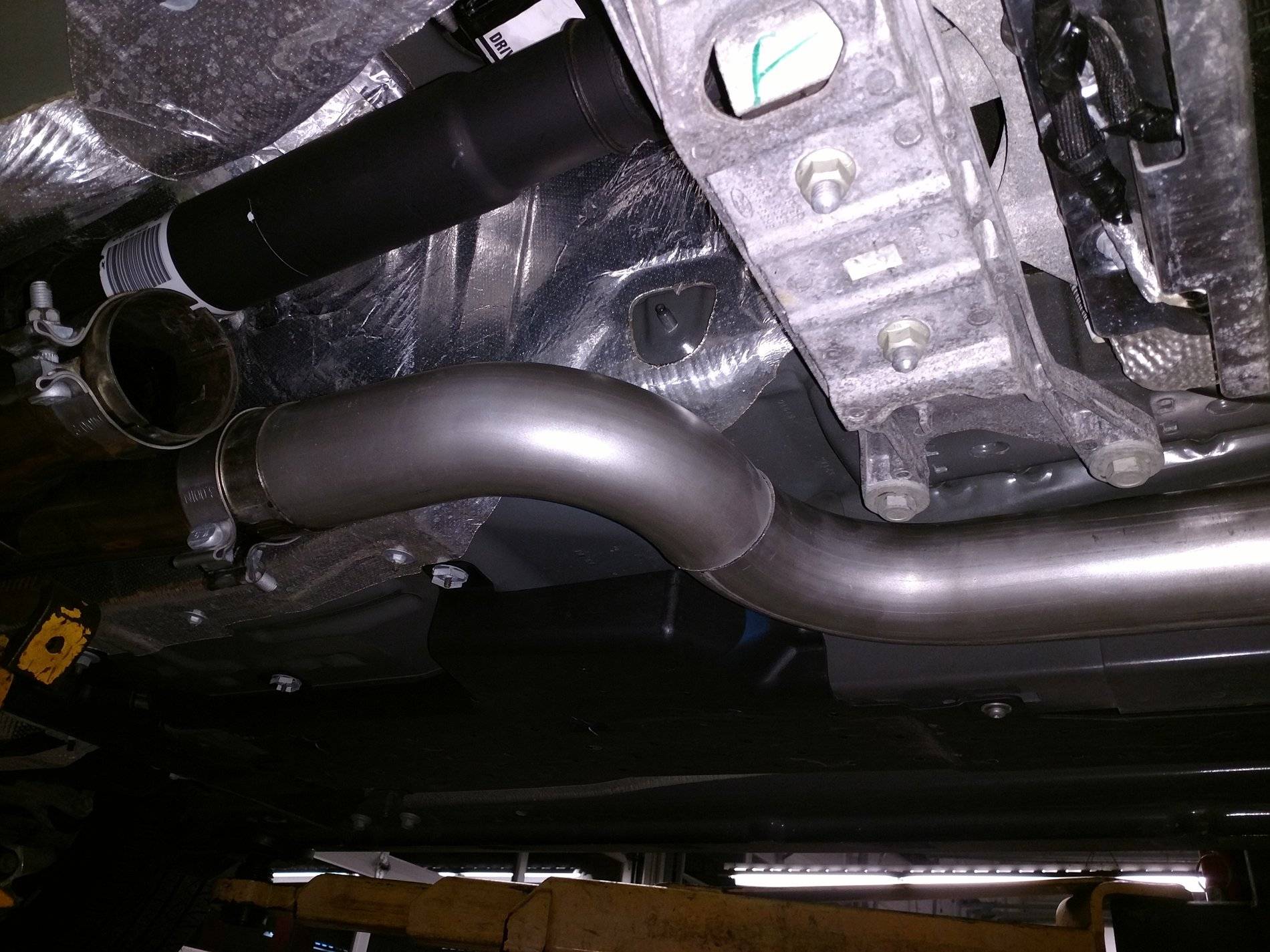

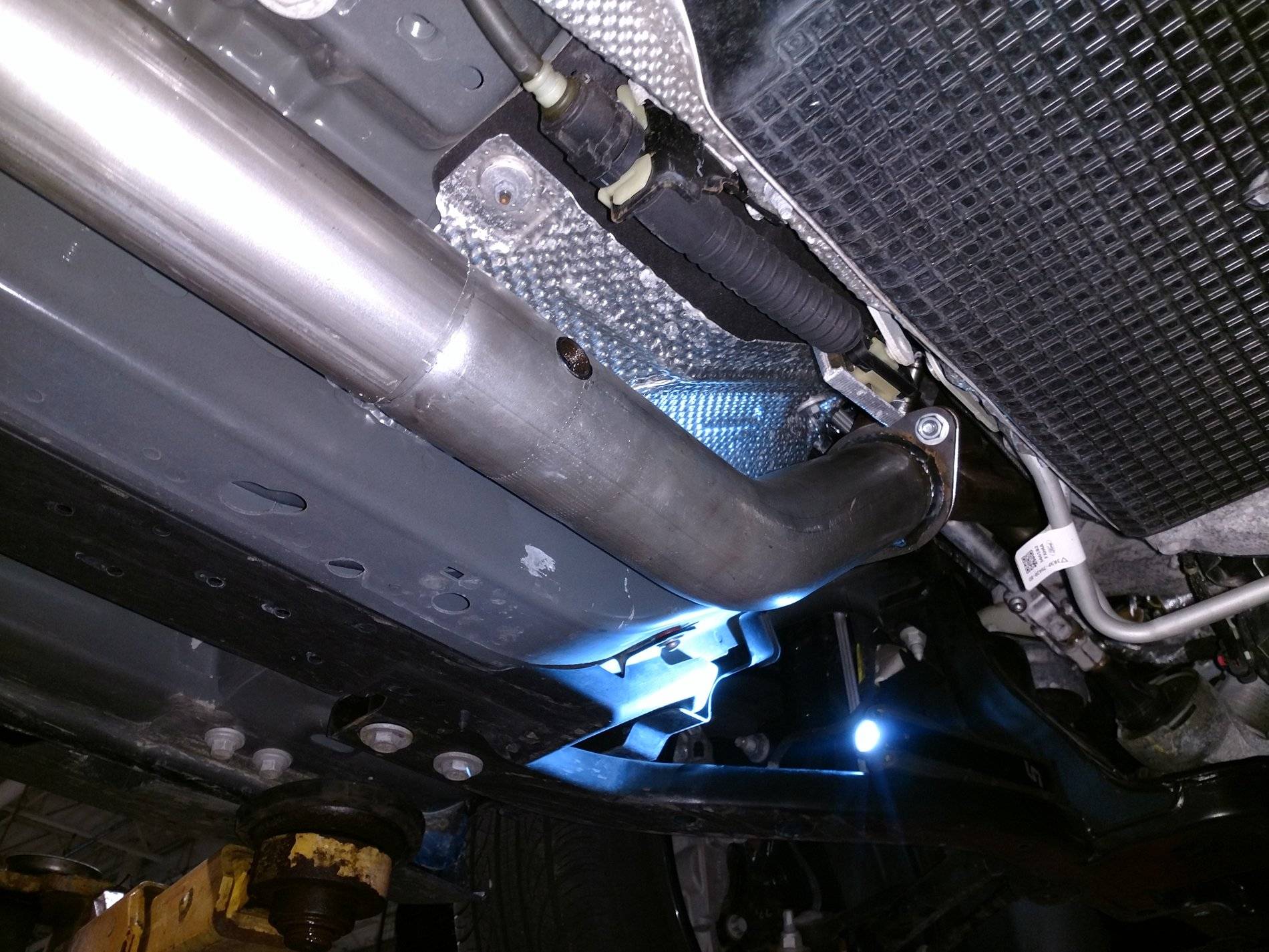

Used 2014 drivers side manifold-.$30
2014 summit brand cat delete pipes $90
Two 3 inch u bends $40
Boostenon114
Boostenon114
Jan 7, 2020
North Canton, OH
Craig

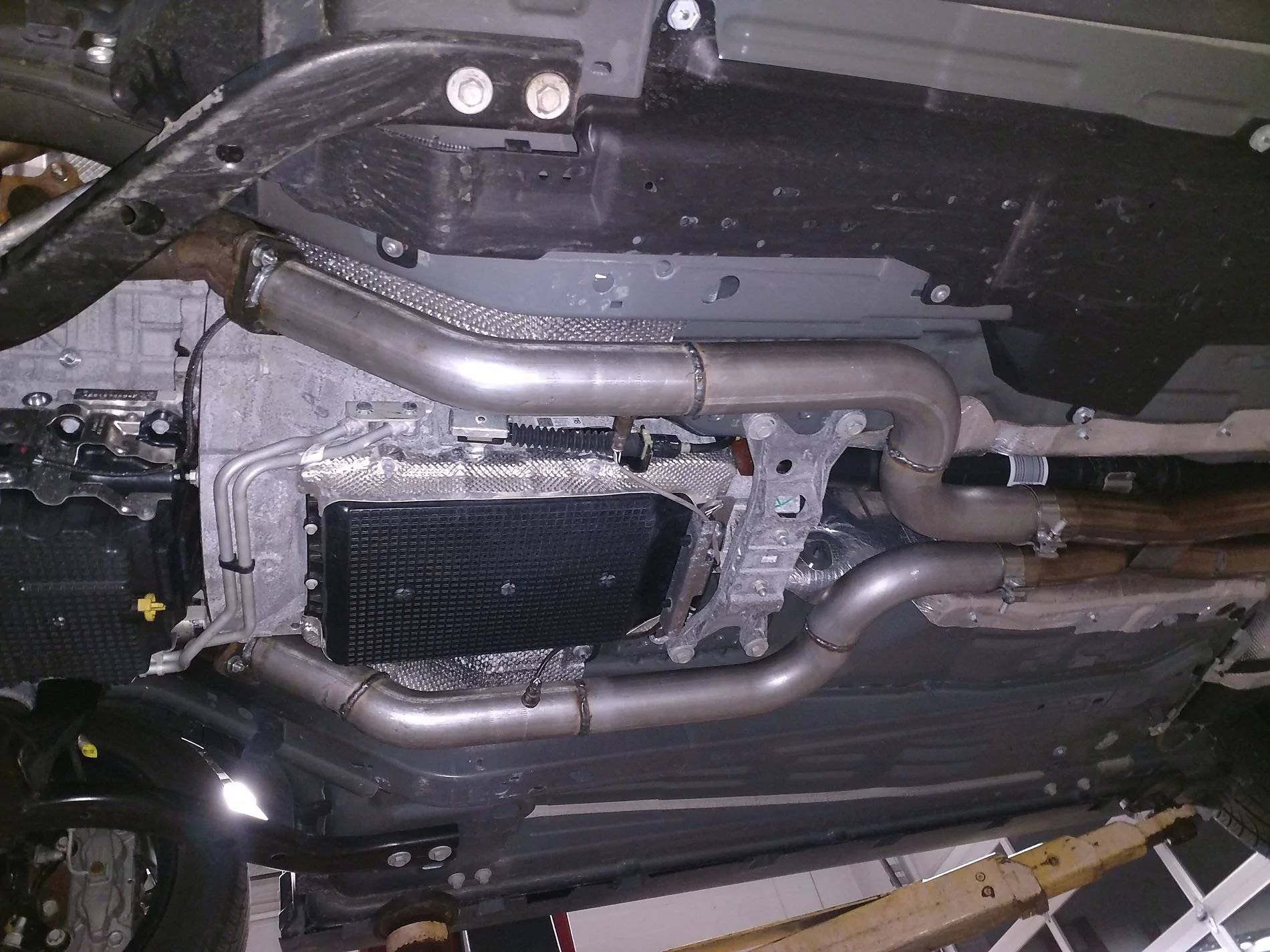

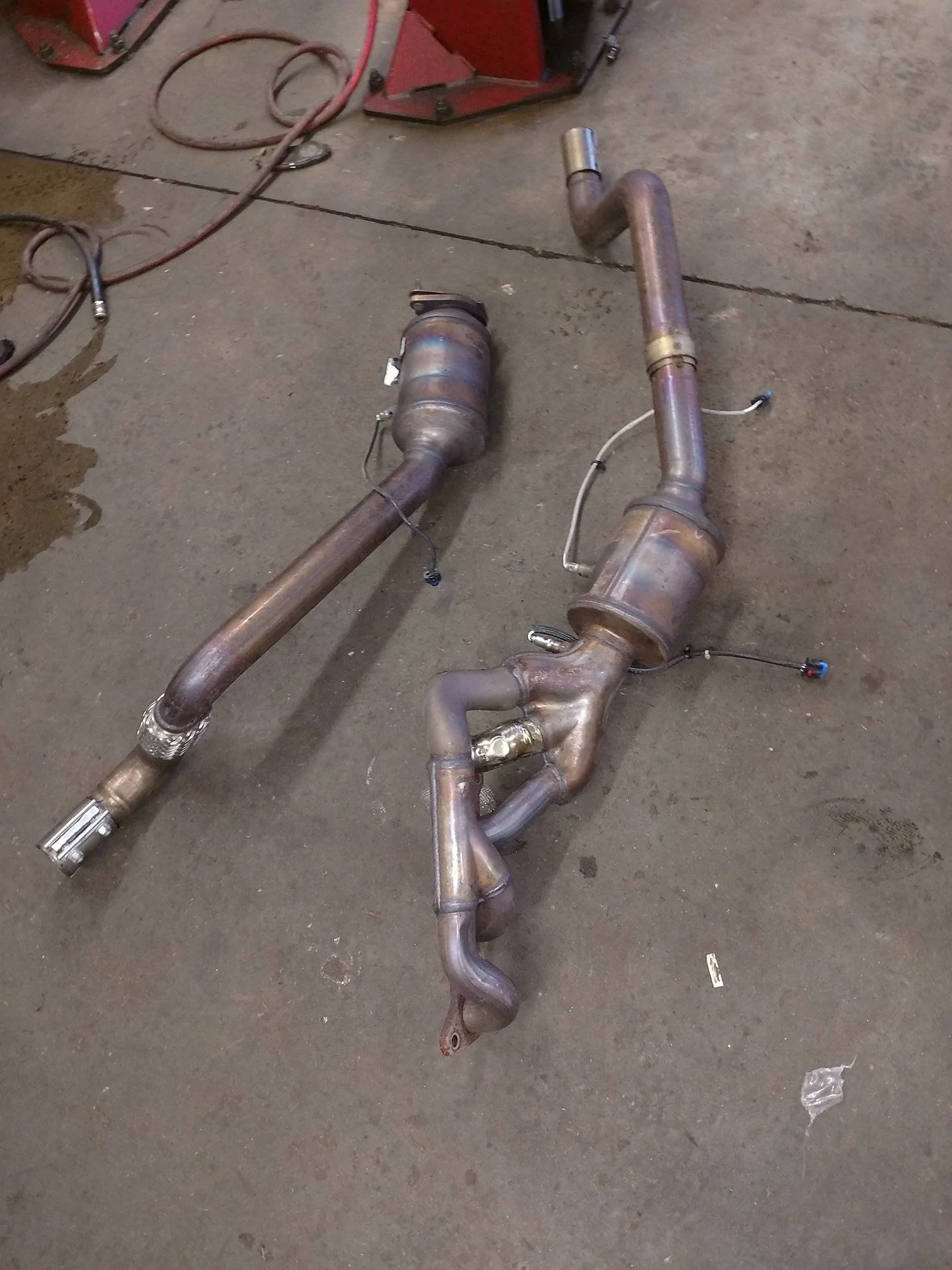

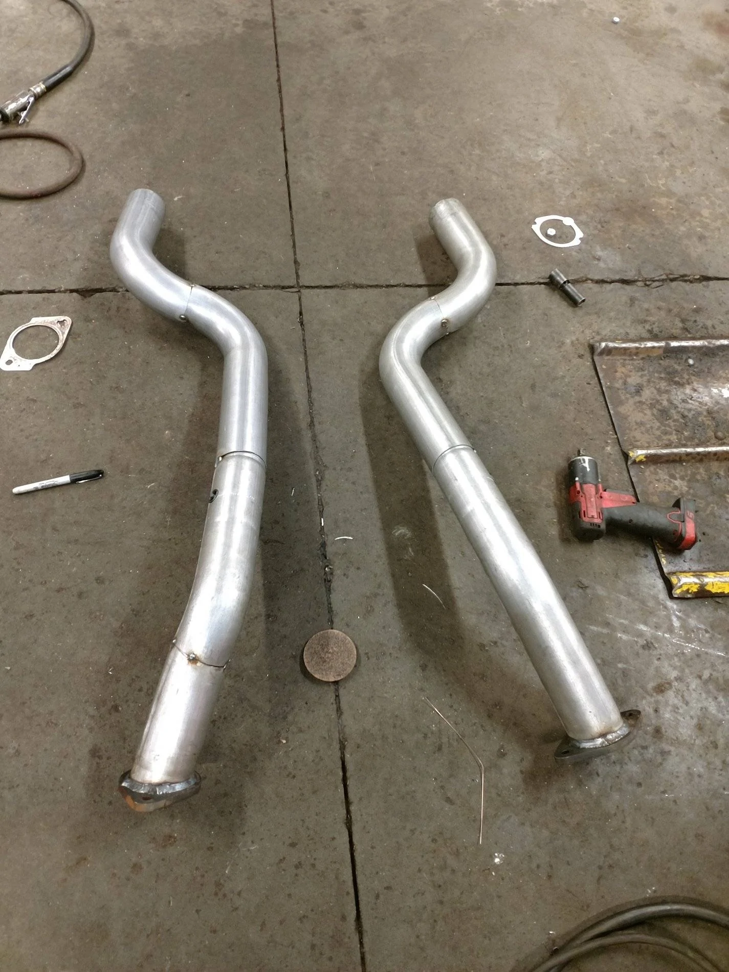

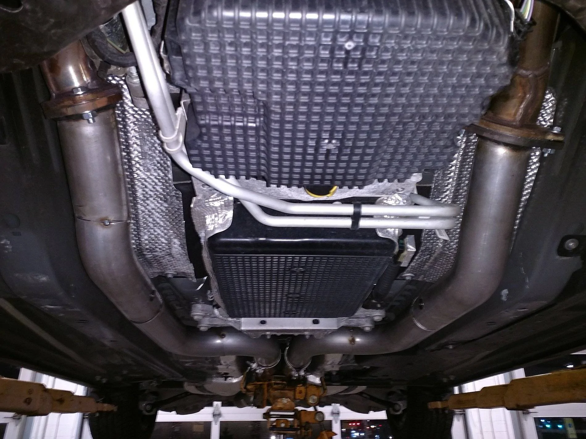

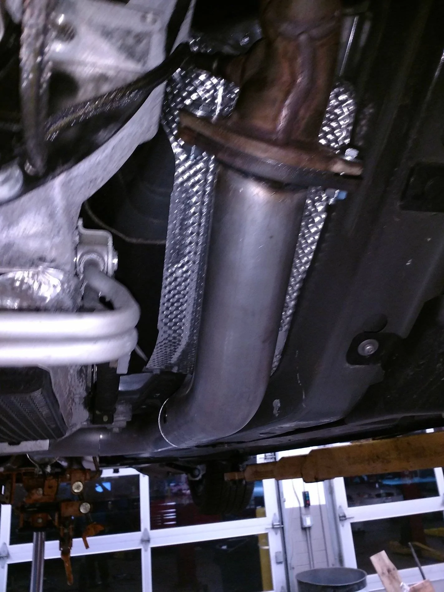

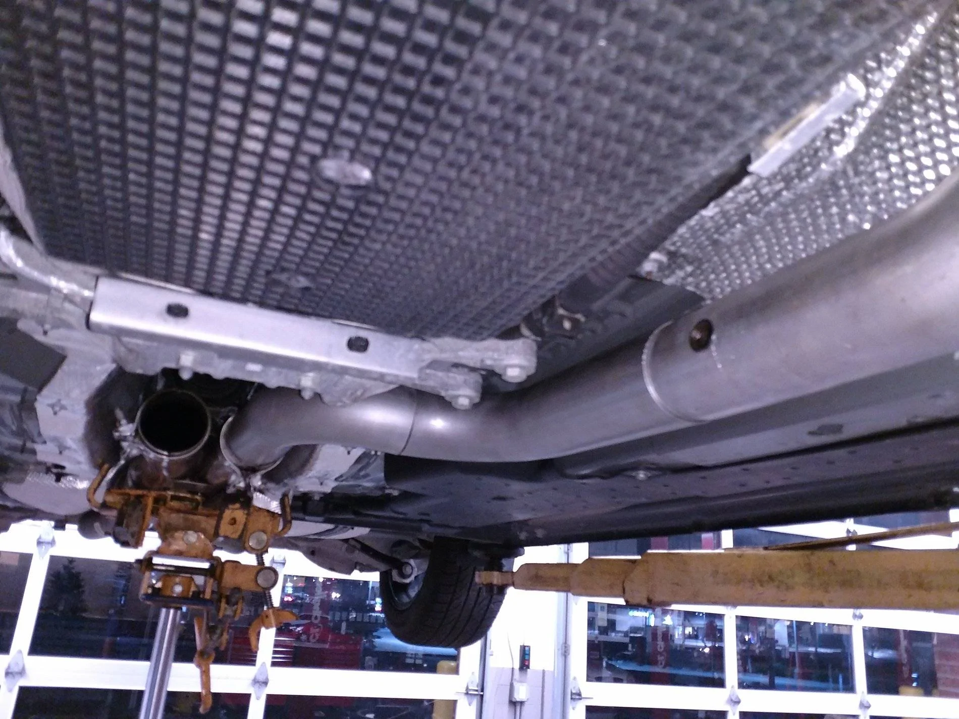

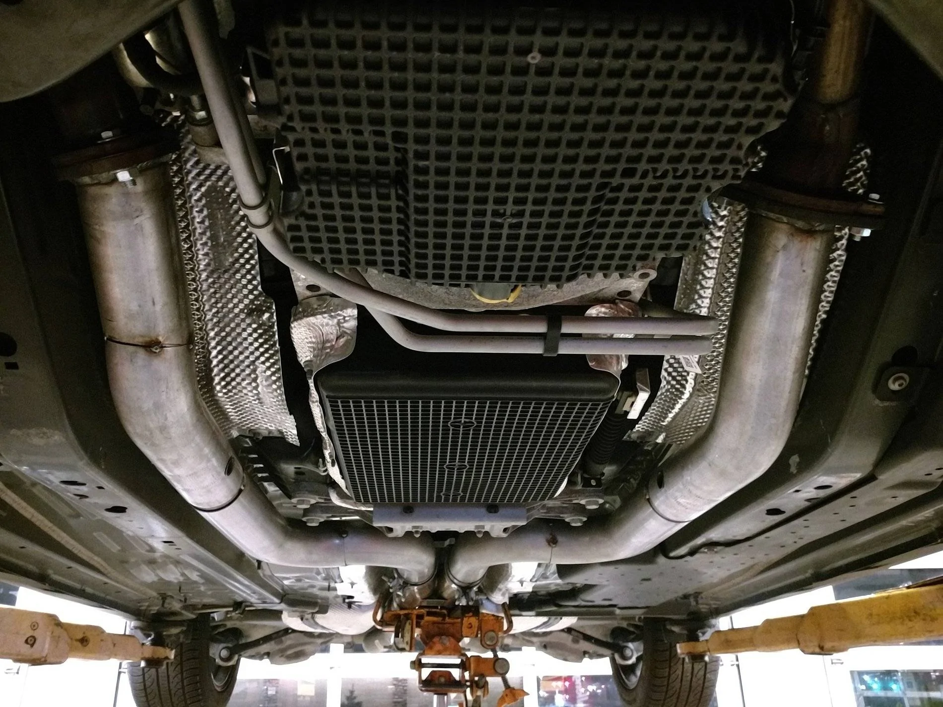

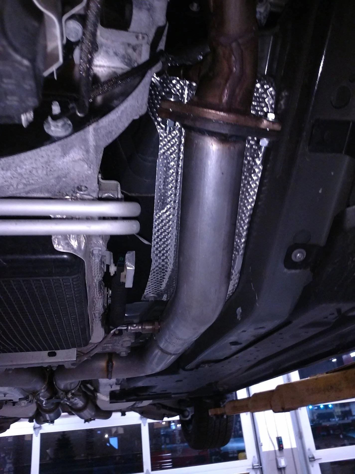

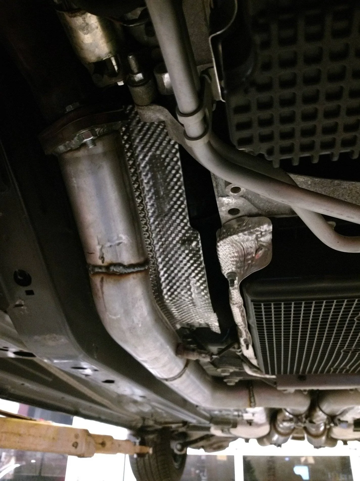

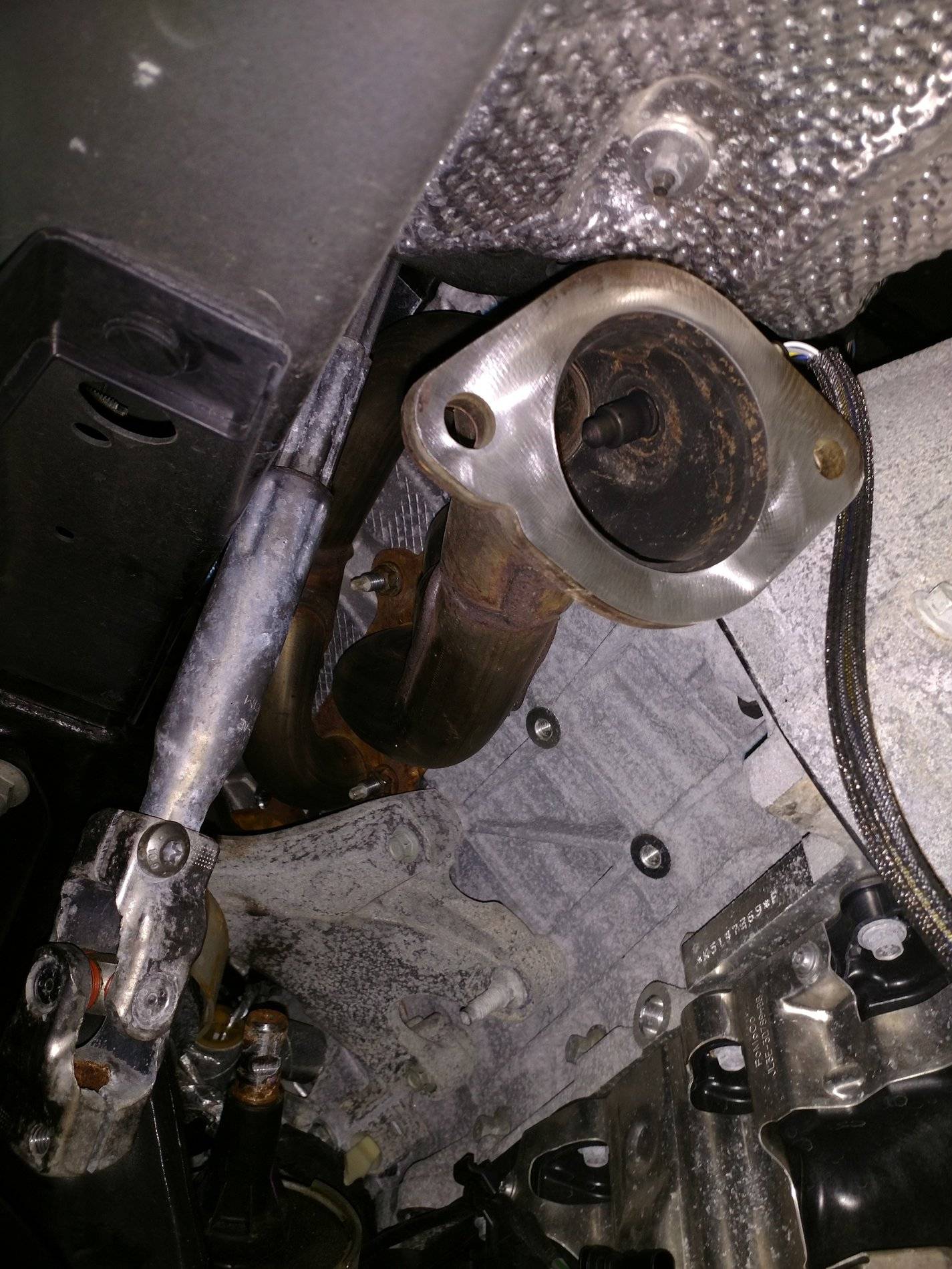

Drivers side down pipe only needs very end cut off. Then you cut the u bend in half and flip, then cut to length. Passenger side down pipe has to be more modifying to fit. 3 hours to do and around $160

***reviving old dead thread***
I like the work to do a custom cat delete here but it makes me wonder why is there no aftermarket option for this? I know with headers you can get a delete or "high flow cats" but I haven't found an option for just a regular cat delete for the 15+.
I know when I had my 2012 gen 1 coyote there was a cat delete option which was great instead of having to do a full header install to remove the cats. Also, from searching the forums it seems people are against doing just cat deletes unless your boosted/plan on boosting. What's up?
-EDIT-
Just freaking noticed after studying these pictures more that the reason you have to change out the header is because the damn driver's side cat is welded to it! WHYYYYYYYY?!?!!?!? Now it make more sense to me, lol.
Yes, Ford made the drivers side as one piece on the Gen3 for some odd reason,
As for why there are no retail cat delete options? Thank the EPA for their crack down on emission defeating mod's over the last couple years,
There are no earth shattering gains from deleting the cat's. My 2018 A10 dyno'd 42xrwhp on pump 93, With a PBD E85 tune, MBRP LT's and 3" O/R Outlaw exhaust it dyno'd 465rwhp.
So I gained 40rwhp from LT's and E85, which did show in my trap speed. I went from 118,xmph on the 1/4 to 122,x. My ET still sucked @11,7xx as I was tuned using SCT and Trevor told me I needed to switch to HPT to get the A10 dialed in.
I would also advise using stainless steel for exhaust parts, that looks like aluminized steel in the pick's up there.
