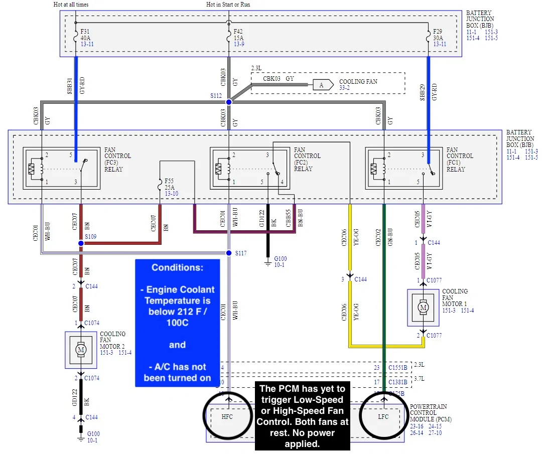

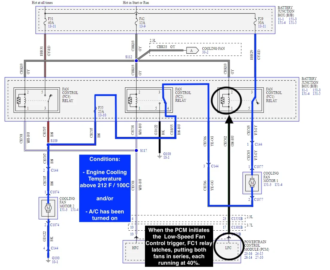

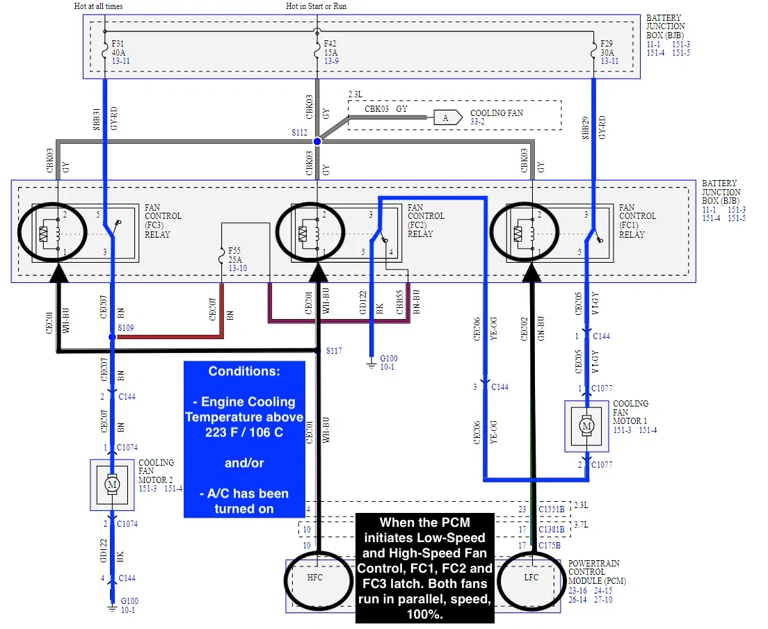

Issues/Concerns:
1. Fans coming on immediately at car start. They should not, unless the A/C is on (See Dallas. :whew:).
2. If temps are approaching 223F, the fans should then engage at high-speed, 100%. They aren't.
I'm attaching some diagrams that help define the logic and map the layout in a stock setup.
If CHT is below 212F / 100C and the A/C is turned off, the fans should be off.
If the CHT reaches 212F / 100C or the A/C is turned on, both fans will engage in series. 40% power.
If the CHT continues to climb to 223F / 106C, both fans will engage in parallel. 100% power.
That both fans are working, IMO, that clears the fans themselves.
When did this issue start? Can you correlate that to anything involving the Lund tune?
Before considering the replacement of parts, I'd discuss and confirm with Lund the tune's fan logic.
If Lund's programming seems correct, maybe start by checking/replacing the fan relays.

Issues/Concerns:

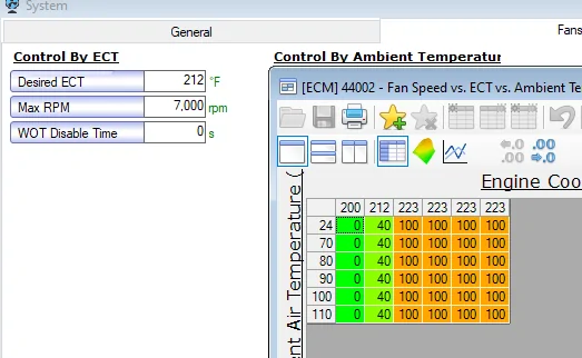

If Lund is programing them to come on sooner, that could be OK. But I wonder how their programming affects high-speed fan ops.
In the table above, notice the "40" and the "100" setting involving the Engine Coolant Temperature. If someone was cut-and-pasting 40s all through, that could stick them at 40%.
Looking at the diagram, this is my understanding of the relays:
FC1 fails:
- If A/C is turned on, or, if CHT reaches 212F, neither fan will turn on
Both fans are running at low-speed. I consider relay 1 good.
FC2 fails:
- At rest, relay 2 completes the interconnection supporting fans 1 and 2.
Both fans are running at low-speed, so that branch of relay 2 is good.
- Engaged, relay 2 terminates fan one at ground, so it can run at 100% speed.
That's not happening. That portion of relay 2 could be bad.
FC3 fails:
- At rest, relay 3 completes the interconnection supporting fans 1 and 2.
Both fans are running at low-speed, so that branch of relay 3 is good.
- Engaged, relays 3 supplies power in parallel to fan 2, so it can run at 100% speed.
That's not happening. That portion of relay 3 could be bad.
You could reach out to Lund. Explain yourself. Ask them to do a top-down review of the existing tune. Just troll it for anything that might be unique or unusual. While that is going on, replace FC2 and FC3.

Fan speed appears to be dictated by ECT as per Skye's HPTuners table, are you sure the high speed fan simply isn't being commanded to turn on? That would explain no voltage at fuse 55. Bad ECT?
That would make sense as well. ECT is inferred from CHT on these cars correct? I haven’t checked out the CHT sensor but the readings don’t seem skewed. From what I’ve looked up most ppl say that when they’re bad they make big temperature jumps in no specific direction. Mine always shows a gradual increase or decrease.
