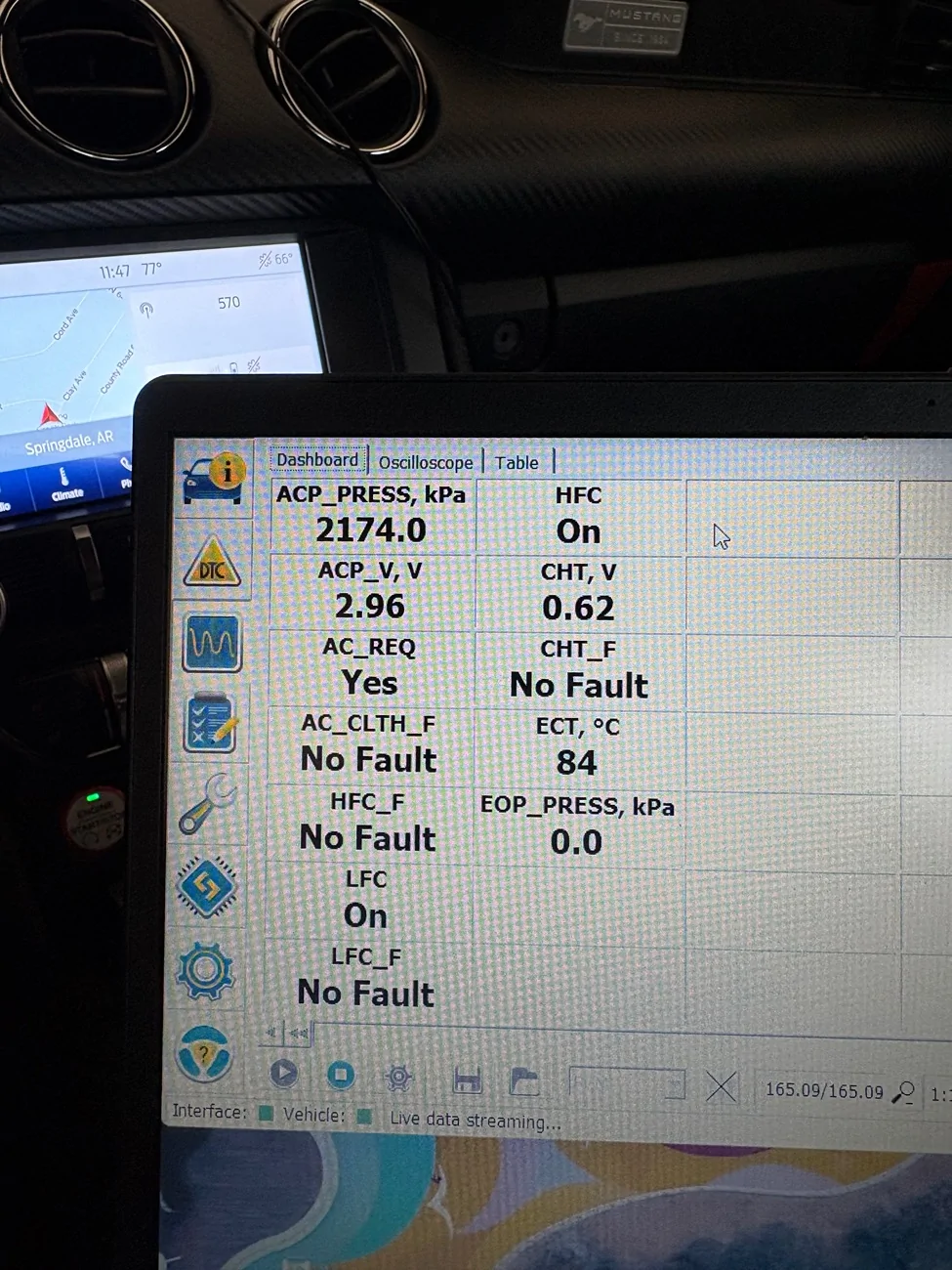

I ended up checking fuse/terminal 31 that y’all mentioned and it was fine. I put 3 new relays in it today and just let it run for a while. This is what forscan showed on live data when CHT was at 200. Says high speed is on and no fault detected now so I’m assuming they’re working again. This was with AC blasting.
Weird thing is when I do the KOEO test and KEOR it will still throw the high speed code. Maybe something about those test don’t trigger the high speed setting correctly. I would think the live data would show a fault if it still wasn’t functioning properly. When I go to read the DTC codes it no longer appears and seemed to be blowing pretty good when I got out to check.

Maybe it was something with the relays but I'm not 100% sure. Another thing I discovered was that the A/C pressure sensor wasn't reading. 2 of the wires going to it were damaged so I got a new pigtail and replaced that as well because it was showing a fault in Forscan. I'm wondering if that had something to do with the fans. Just from using google it looks like if the A/C has a fault it can affect fan operation.
I guess the real test will be driving it around again and seeing how CHT looks. I already have a 170 thermostat. If the fans are now functioning properly hopefully I'll stop getting CHT readings in the 230+ range.
