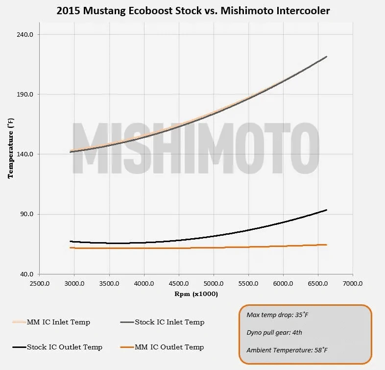

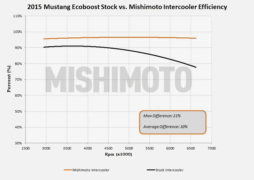

I do not believe HPP comes with upgraded IC, so if you have stock intercooler, consider swapping for a mishimoto or cpe or any aftermarket stock location intercooler. its like something like 30-50% extra cooling in same spot. I swapped mine out under belly pan.
the car has a diff torque curve due to slightly larger turbo and tune, but if it has a better IC. it will do much better holding the power. still limited due to the stock IC being massively tiny. for grandmas etc its fine, but you'll be heat soaked everytime you stop for more than few seconds, and it'll always pull power on a wot assuming its not winter or cold out.
double check to see its size.
here's the link for info
https://www.mishimoto.com/ford-mustang-ecoboost-intercooler-2015.html#features
and here's, the links for R/D of it. dyne etc
there's 5 parts to this. but im only posting the 5th part
https://www.mishimoto.com/engineeri...rt-5-finished-product-and-final-testing-data/
Conclusion
This concludes out project! We have a very robust, efficient intercooler solution for the EcoBoost Mustang. A summary of the testing results are noted below.
  • 30°F–35°F drop in outlet temperatures
  • Intake temperatures held at no more than 7°F above ambient
  • Minimal pressure drop
  • Average efficiency of 96%
  • 165% increase in external fin surface area
  • 58% increase in core volume

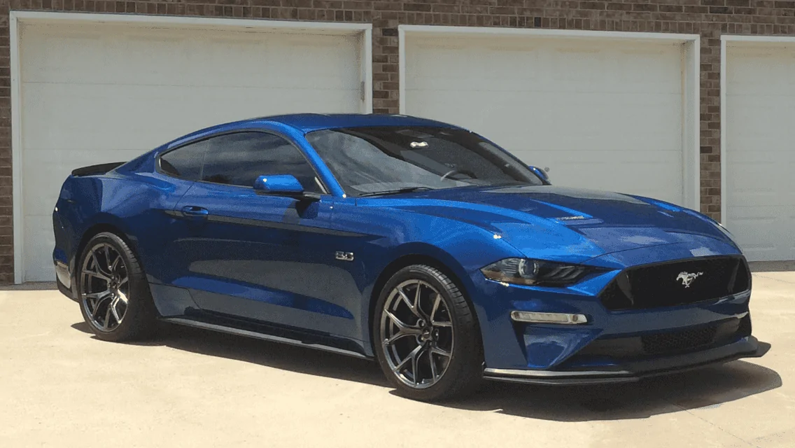

that. is. GLORIOUS. pp2 or did you add those wheels?
2018 PP2 301A, active exhaust, and Recaros. A little over 4 years and 21K now, and it puts a smile on my face every time I fire it up. I can’t imagine a Mustang with anything but a V8. The active exhaust is glorious. I also have a 2013 F-150 with the 3.5 TT, intake, down pipes, and full cat back. It will beat a lot of cars from stop light to stop light with a boosted 4x4 launch (including my GT). But that wonderful exhaust note of the Coyote just can’t be beat.
