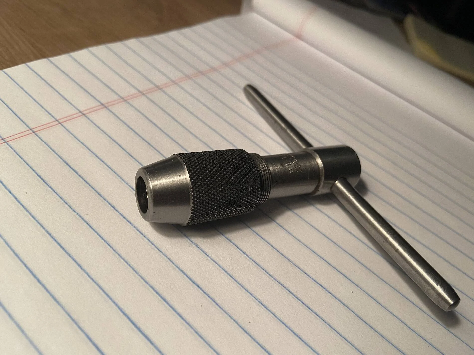

Those that used the harbor fright tap kit. What size socket did you use on the end of the tap? I tried a 9 mm amd it just spun once the tap hit.

Not a HF tool guy, but the tap tools are all the same. Trying to use a 6 point socket you will need an 8 point 7/8 mm.
Or buy this

I got it In finally! Phew!! I had a old craftsman tap set that had a t handle you could use a ratchet on.
