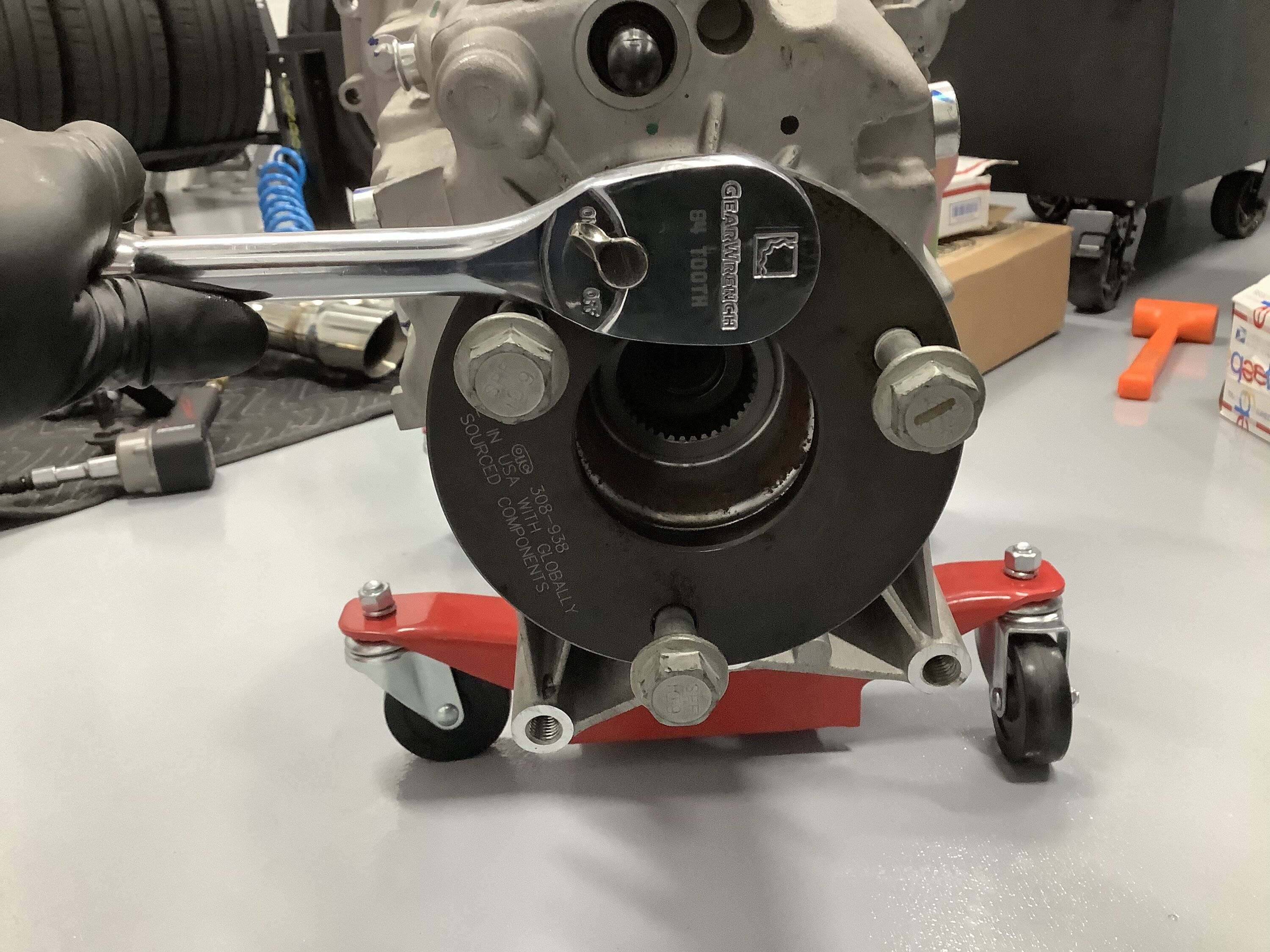

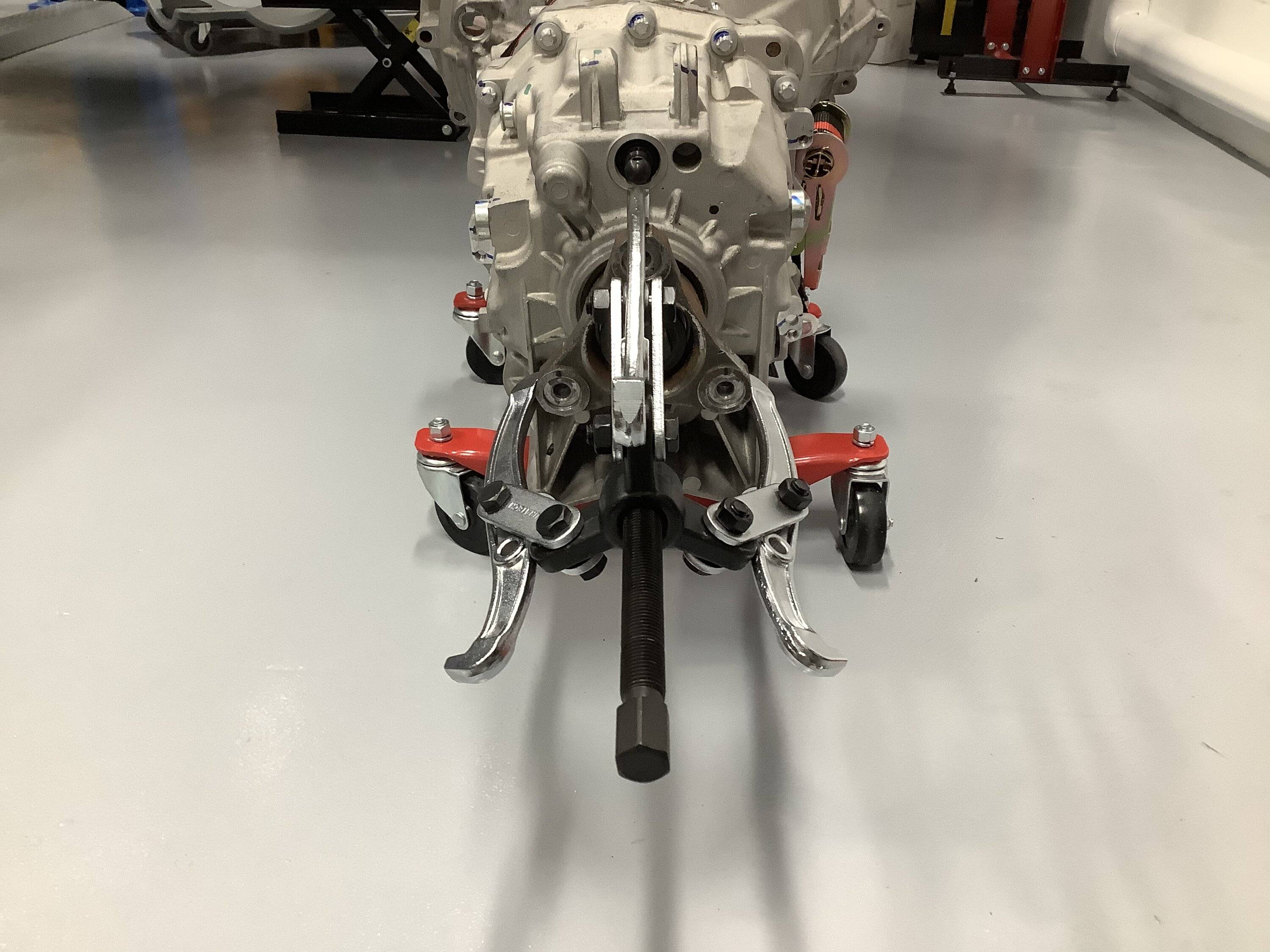

I know I'm way late to this party here but does anyone have any advice on how to get the goddamn flange off. I'm using a puller with an impact driver on tbr puller and I've been going at it for like at least 3 hours and it hasnt budged
NGOT8R
Jul 19, 2020
154
9,401
7,900
Adrian
2019 Bullitt
30MM deep well socket, an impact gun and 3 jaw puller is needed to remove it. A flange holder (which can be purchased on eBay) will be needed to hold the flange when torquing the bolt down during reassembly. I also used 175 psi air to break mine free. You have to keep the pressure high on your air compressor and it will loosen a little at a time. You could also use the flange holder in the link below and two 1/2” drive breaker bars to remove and install.
