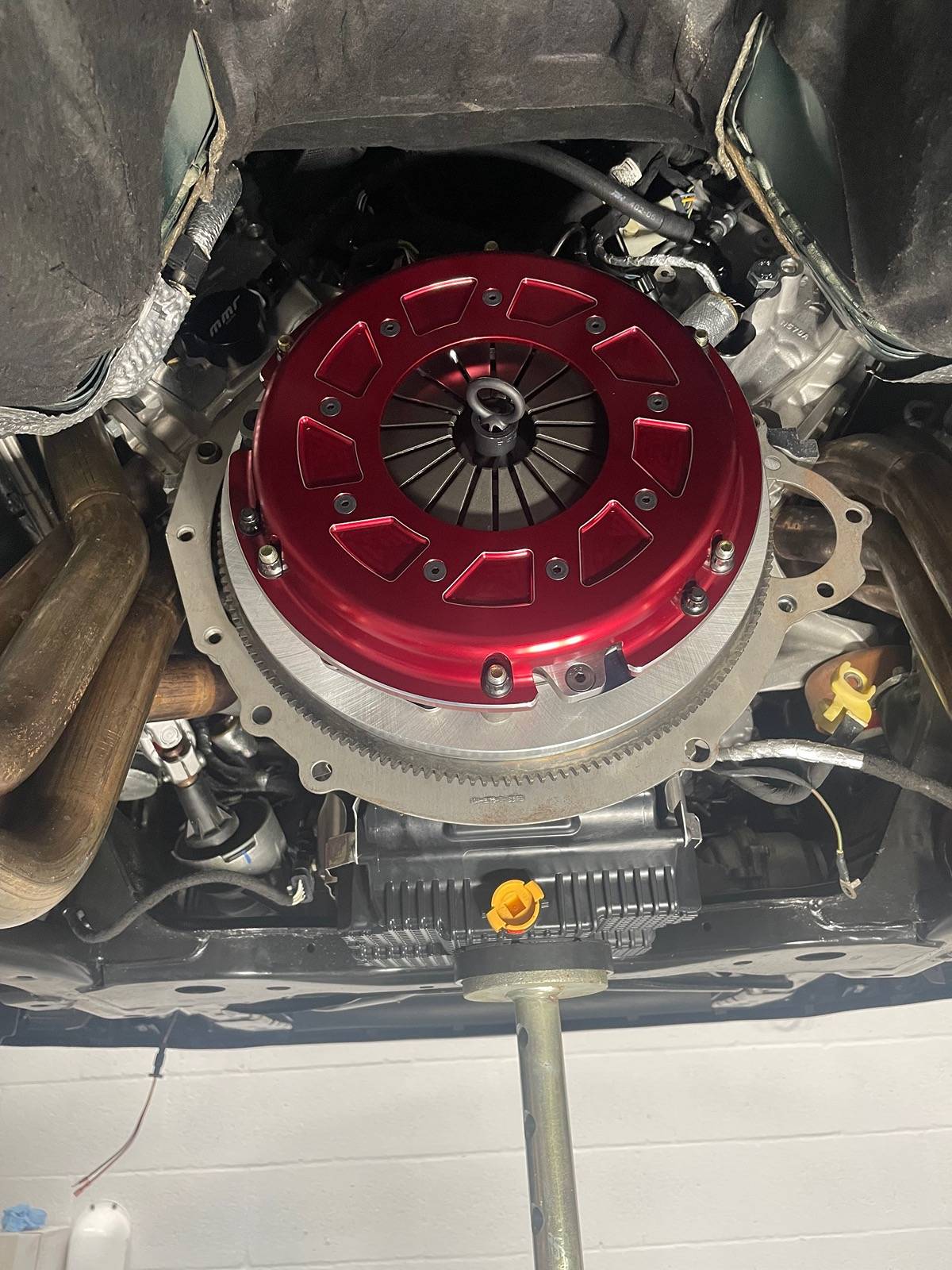

Take a flashlight and look into the inspection ports/vents in the bottom of the casing to see if an aftermarket clutch has been installed. Usually, the pressure plates are painted in a wide array of colors and you will be able to see this looking through the ports. Also look on the right side of the tranny to see if the counterweight has been removed. This is another sign that work has likely been done to the tranny.
