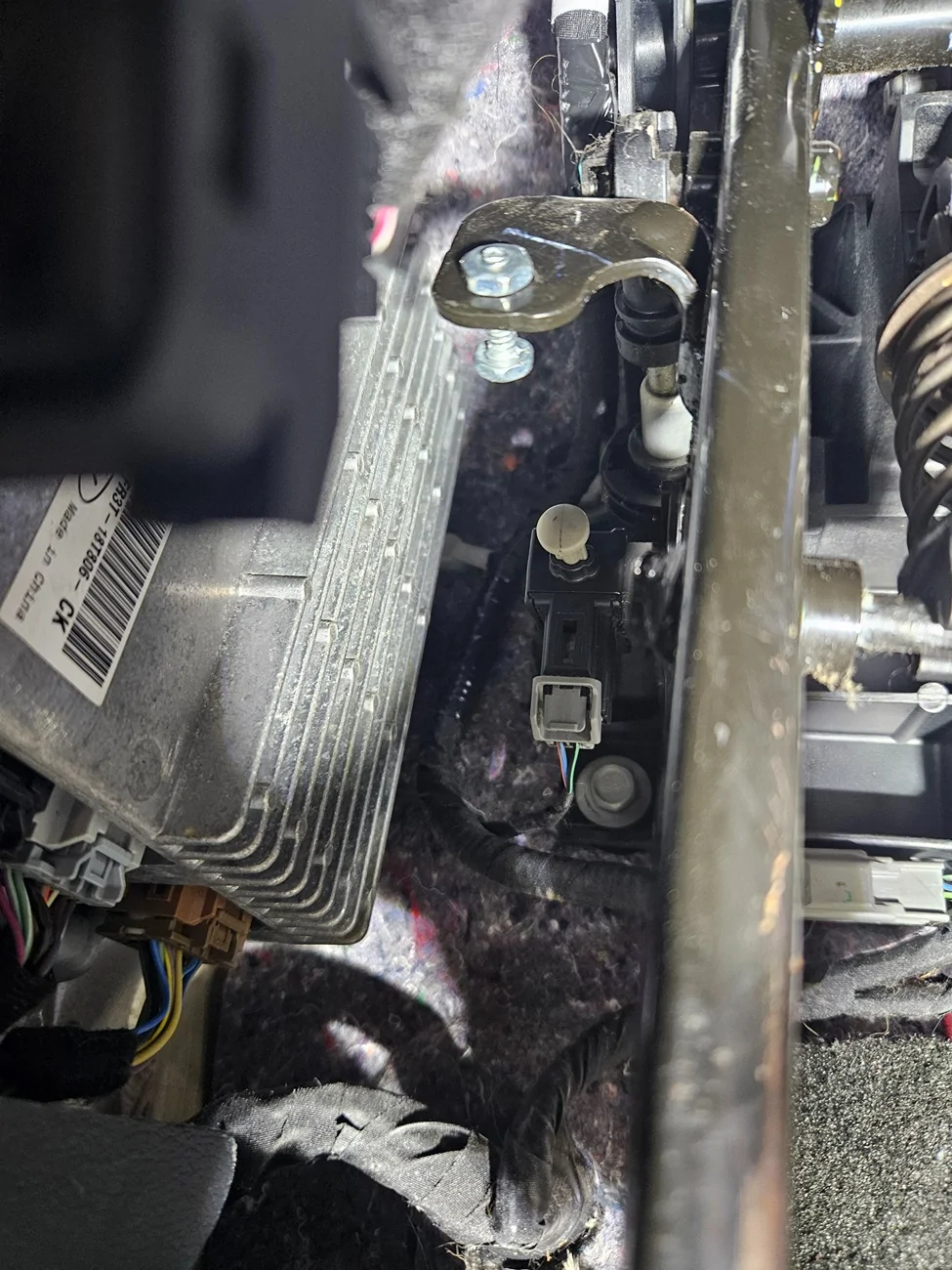

Help!!! Got stuck at gas station. Push button suddenly doesnt start car

Theoretically when that happens you can still start the car by holding the button

I tried holding the button and brake at same time and push starter button. It's way harder than you think, and im skinny.
I fixed it with a bolt and nut but theirs got to be a cleaner solution. BTW all no lift shift issues are gone. Posting this in case anyone else is experiencing issues like this.

Glad that worked for ya…mine was the starter, exact same symptoms 😉

No I meant holding the start button instead of just one push. Im not sure if it only works when the car detects an issue with the clutch switch, but on my car I killed the switch once and was able to circumvent the issue that way.

Yeah that holding the start button thing doesn't work. I read that article. Mine just kept blinking green. Im trying to come up with an unbreakable solution because how that clutch sensor is mounted looks flimsy as hell

I can't recall the post or steps, but I believe you need to have the parking brake on, car in neutral, and hold in the start button in for a few seconds. I know it definitely works because I had to do it.

I am. That's probably why the nylon spacer broke off. BTW, for sale in the near future..15 gt, never raced, never abused......lol
