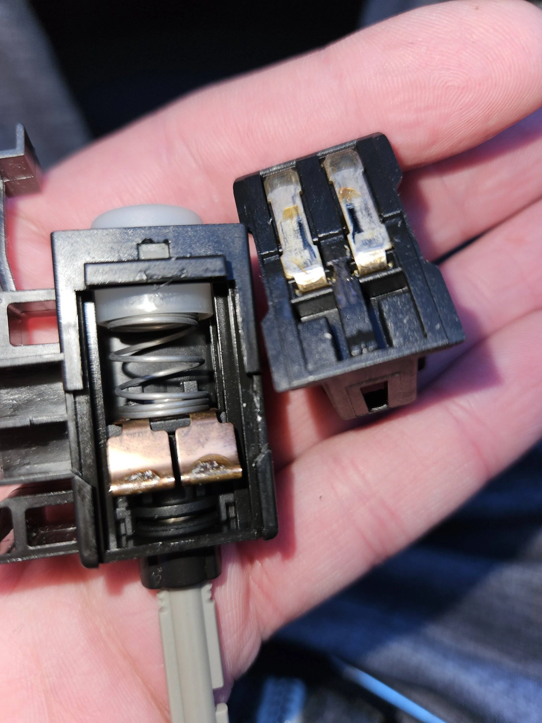

Thought I wasnt pushing the clutch down all the way but Ive been having some start issue with push to start. I have to hit it a few times before it will start. At first I thought it was me.
Today it would not start at all. Key is detected. With clutch depressed it just does back to off like its not detecting the pedal being down. Accessories turn on but it tells me depress clutch/brake even though I am. Is there a sensor somewhere down there or a bypass?
I have a steeda spring and perch in as well as a new cyclinder. Few months old. Not sure if that caused anything.

Well.. here I am again.. crappy clutch safety switch went (again) and now I cant start the car.. anyway to bypass this?
Or am I stuck until I get a new one?

Tried pushing it in with my hand and its telling me to start with brake. When I do that it fires for half a second cuts out.. so annoying. I just want to able to drive my damn car without the idiot switch..
Took it apart, contacts are fine. Reinstalled with the plunger pulled out. When I compress the clutch the light is green like before it broke but again still prompts me to press the brake pedal and I get only a half second start.. i guess taking it apart didnt help..
EDIT: cleared the stupid DTC with the nGuage and it worked.. so if you dont have a scanner or at least a bluetooth scanner and torque or similar app your screwed until you can find one or are towed out.
I was about to unplug the battery which I assume would have worked but unsure how long that would take if it at all.
Ordering my 3rd switch..

Here I am again same issue.. so stupid...
Does anyone know how to start after replacement??
It just keeps says read manual... but I have no clue what to do. Last time there was a code to clear. This time none.

Thanks. I already ordered another and pulles this one apart but cant start because the wrench light is on but no DTC.

So apparently a regular scanner like torque pro wont work. Only the SCT or Ngauge showed the code p0704. I dont know why that is. I still cant get it to start though it will give half crank and terminate.
Edit: pryed the prongs out and got it to work now. Have another new cheap $10 switch coming tomorrow.
This car will not start with the clutch in and bypassed btw..
This will be my 4th one I believe.. terrible.. if I was keeping the car I would do a wire bypass.. but you still have to have the clutch out.
All this new hydraulic bs (faulty clutch masters) and safety switch has caused me a lot of issues. Poor quality from Ford.
