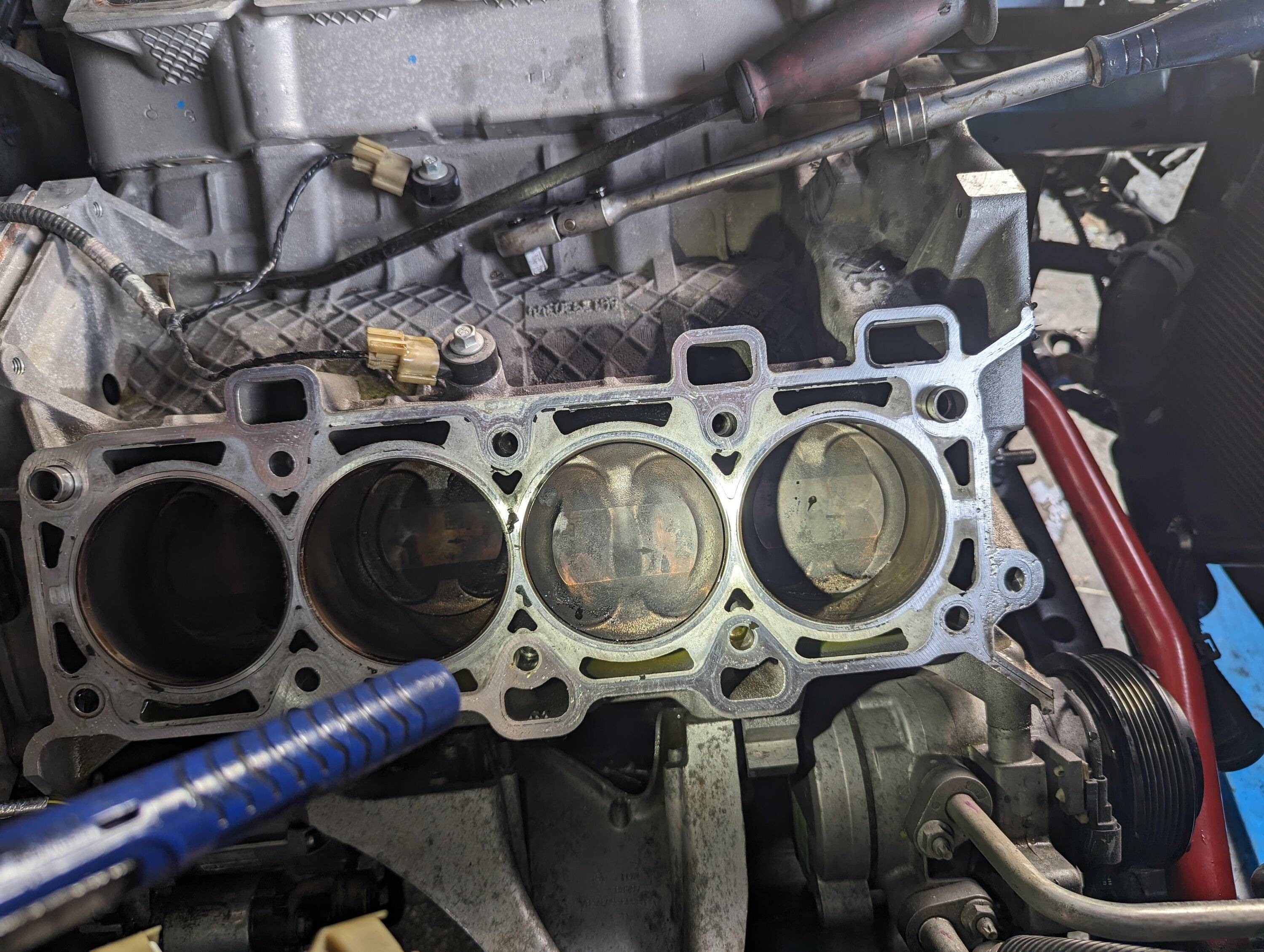

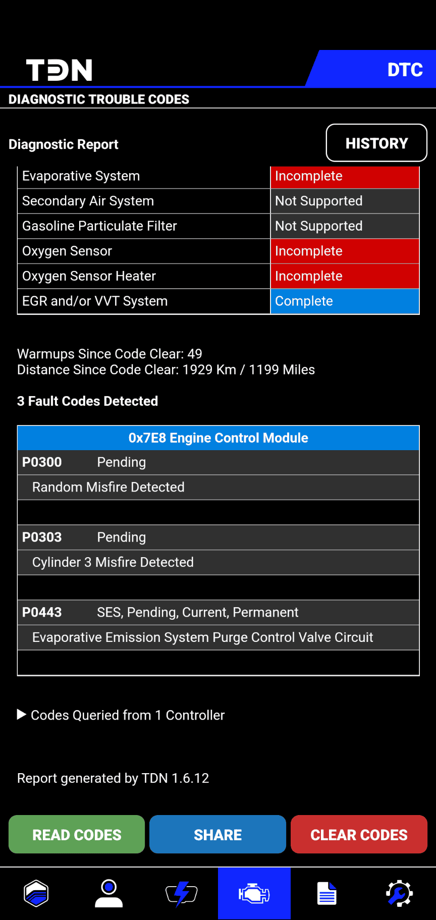

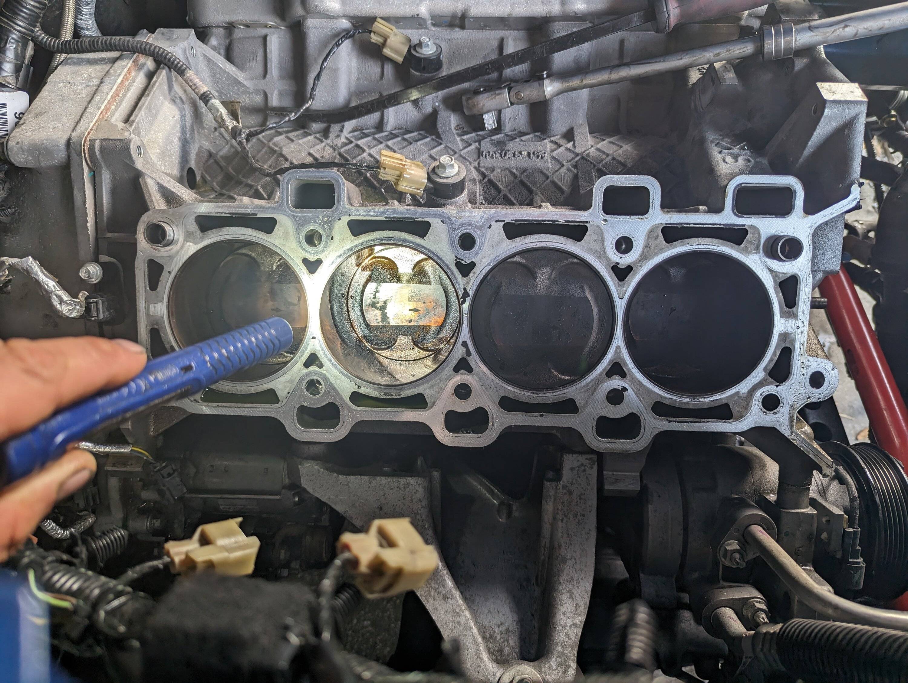

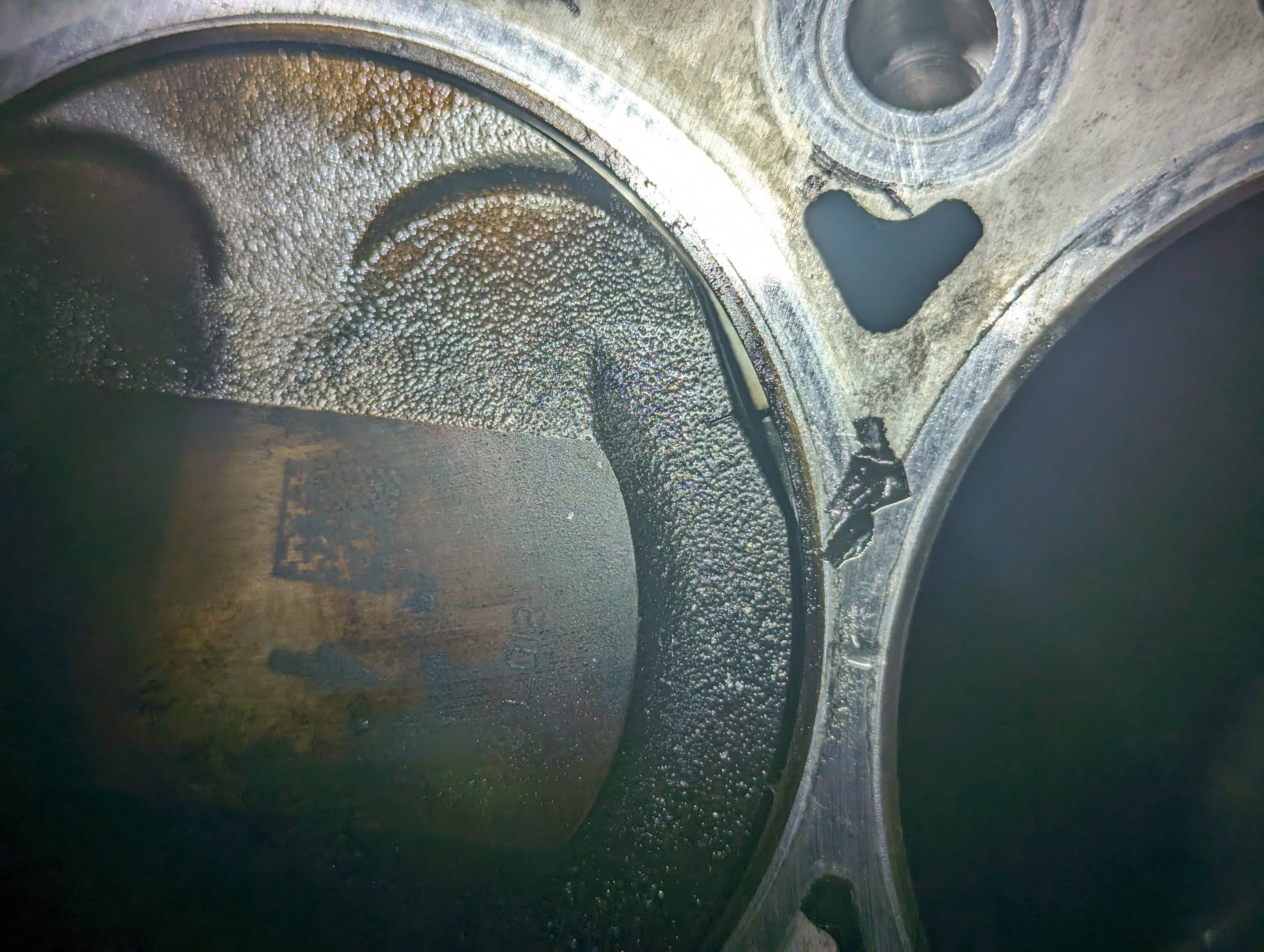

After only 1000 miles with the supercharger(79mm pulley) I received a misfire code P0300 and P0303. We opened the engine and saw that the piston on cylinder 3 was gone, luckily the block and the walls were okay. It was close after or during a WOT with a 93 octane from a gas station that was quite suspicious.
My mechanic says that for him it lookes like it was injectors fault (ID1000s) which were used before and they are old, got em from a friend but were tested prior installing.. you can see how piston 3 and actually the one next to it seems washed and the other two are dark as it should be.

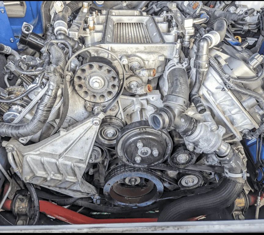

Also I will attach photos of some vacuums in the intake manifold that I sealed + some strange breather that we had to installed, not sure if we installed everything properly, could a vacuum leak cause this?

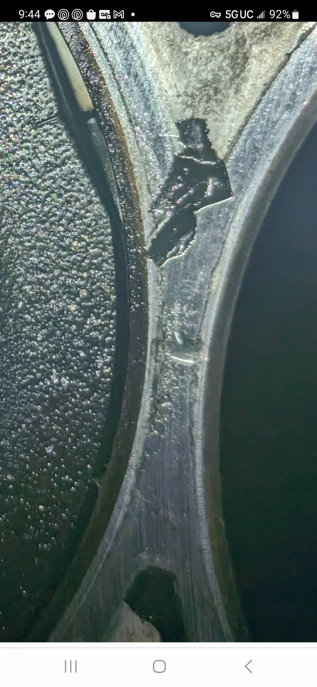

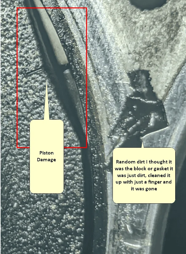

Not too familiar but these marks on the block. Is this gasket material or damage to the block?
That’s severe detonation. Arcing etching between the cylinders once the fire ring in the head gasket is torched.
That’s what I’m thinking…. Can’t tell but that might need to be flycut to clean up
