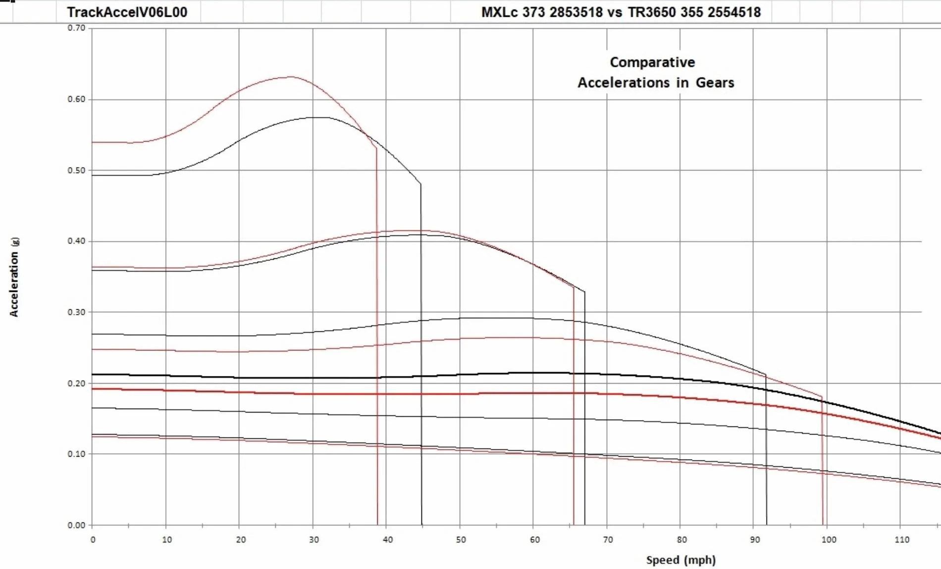

I've got about enough battery life left to post a couple of screenshots you may find interesting. It's part of my due diligence for choosing a different transmission but it illustrates what's going on reasonably well.
The spreadsheet is my own.

I think we might be misunderstanding each other somewhat.
As your chart below quite clearly shows, peak acceleration occurs at peak torque, regardless of the gear selected. From a “seat of the pants“ perspective, this is what we feel.
Yes, we continue to rev the engine beyond that point to capitalise on the torque multiplication of the current gear rather than piss it all away with the reduction of the next gear selected as you well understand, but the simple harsh reality is that the car is literally losing that “push in the back” as you do so.
The question being asked by the OP was specifically asking for the difference in “feel” between horsepower and torque. I‘m simply trying to highlight to him that peak acceleration for a given gear will occur at peak torque, whilst horsepower will allow him to hold onto a shorter gear for a longer time period, which is what allows you to cover distance more quickly, AKA, racing.
EDIT:
Your graph also shows us how drastically that “seat of the pants” feel diminishes each time we swap to a taller gear and why that’s relevant to covering distance quickly.
Evidently.
There's no getting around the fact that peak acceleration is only a momentary snapshot of what is going on. Using peak conditions to describe "feel" is a bit too simplistic. Then again, I've been running these acceleration sims for nearly as long as the Mustang has existed so I am going to be looking a bit deeper into what's happening.
Especially for Meatball - acceleration mirrors the torque curve (more or less) rather than the HP curve, and that's what gives you that overall "seat of the pants" feel. If you're paying enough attention, you can feel the acceleration swell as you approach peak torque rpm from below, and taper off once you're past it. That's really the answer to OP's question, where he's asking whether it's the HP you feel or the torque.
