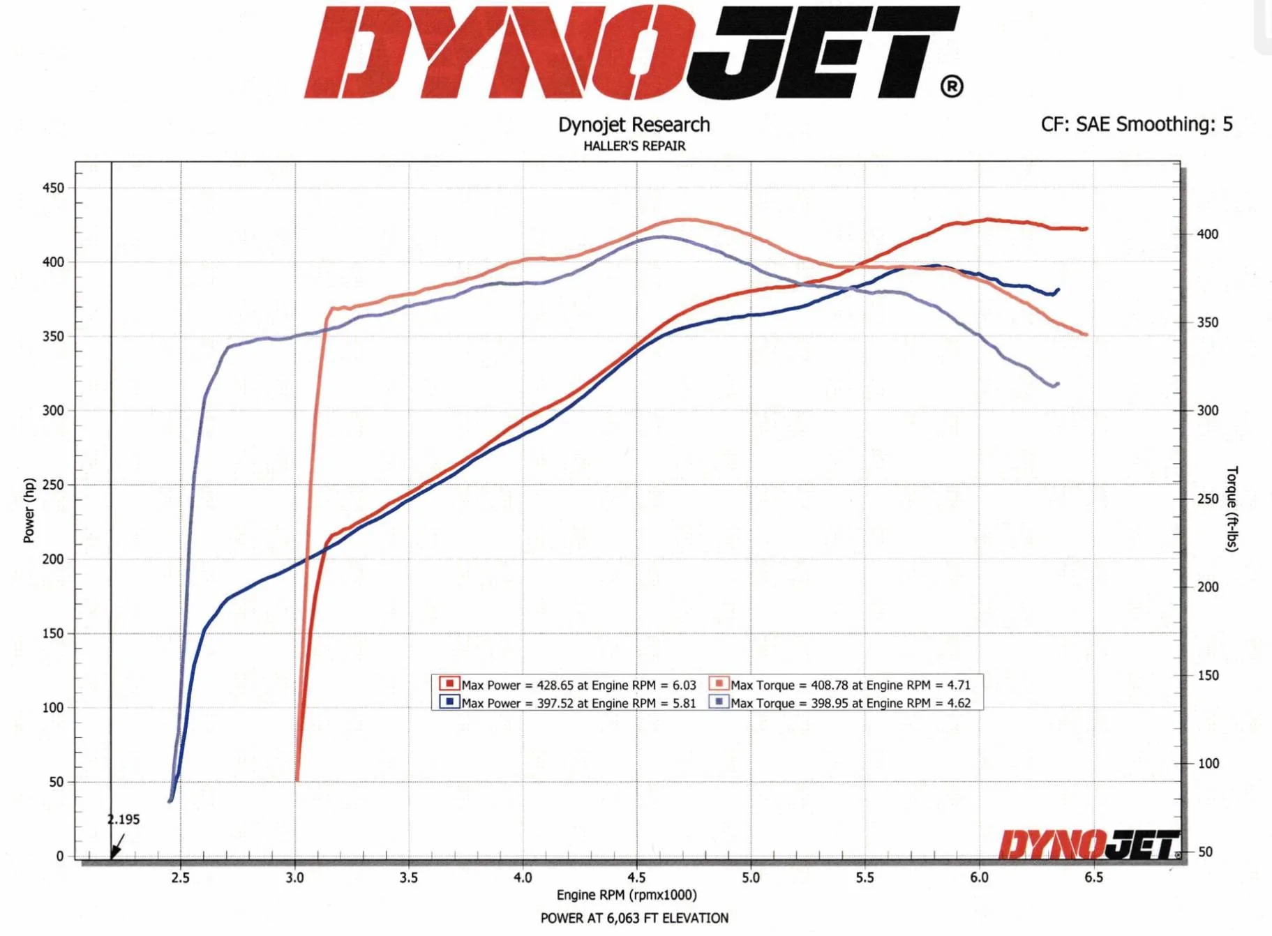

Dyno chart from a Camaro below to graphically illustrate for the OP how the peak accel happens early (in this case) but the driver will hold the gear regardless, cos he wants to capitalise on the torque multiplication of that gear, rather than shift up.
That's a useful chart. From it, I think you could take this away as a bottom line answer . . . HP basically tells you where you need to keep the engine rpms for best acceleration, but after that it's the combination of the torque curve, gearing, tire size, car weight, and quite a number of other things that ends up giving you what you actually feel as acceleration.

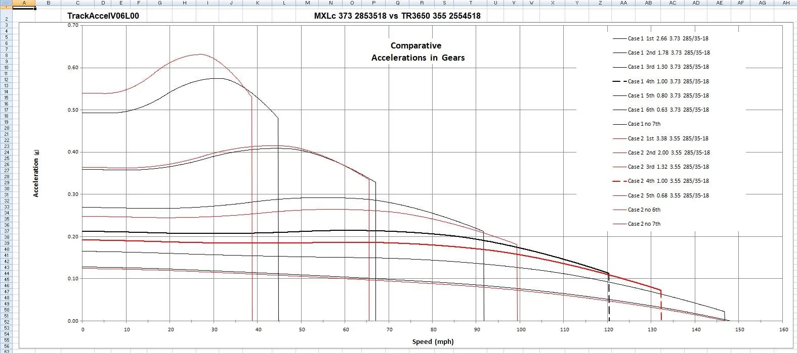

You missed my point entirely.
(a) Max acceleration in any given gear is maximized with the engine running at peak torque rpm.
(b) Max acceleration at any given speed is maximized by running the engine at peak HP rpm and gearing accordingly. It's just another case of gaining more from staying in the lower gear than you lose from torque fall-off.
(a) and (b) are not two ways of saying the same thing. They're distinctly separate.
Again, acceleration is the force (torque) divided by mass.
OK, let's run with that . . . yes, a = F / M
But force 'F' is not torque (forces and torques aren't even expressable in the same units). The force you're talking about is the total rearward tire force, measured or calculated at the contact patches.
To get to those contact patch forces, you have to divide drive axle torque (let's assume that wheelspin does not occur) by the drive tire rolling radius. But axle torque is engine torque times transmission gear ratio times axle ratio. You're glossing over all those things in boldface, which brings some risk of losing people who may be trying to follow along. I've been running this sort of analysis for longer than you're likely to guess, and I'm having to translate more than I should have to.

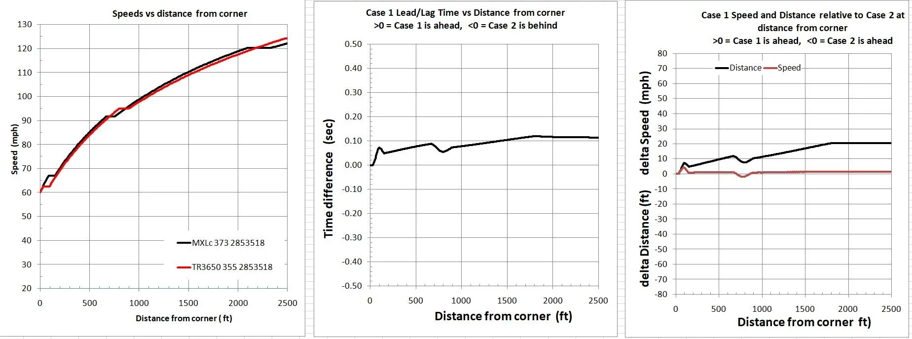

I've got about enough battery life left to post a couple of screenshots you may find interesting. It's part of my due diligence for choosing a different transmission but it illustrates what's going on reasonably well.
The spreadsheet is my own.
Norm
