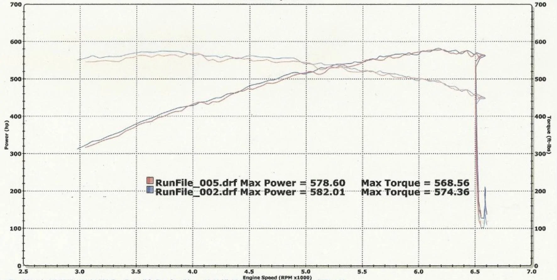

Dyno chart from a Camaro below to graphically illustrate for the OP how the peak accel happens early (in this case) but the driver will hold the gear regardless, cos he wants to capitalise on the torque multiplication of that gear, rather than shift up.
