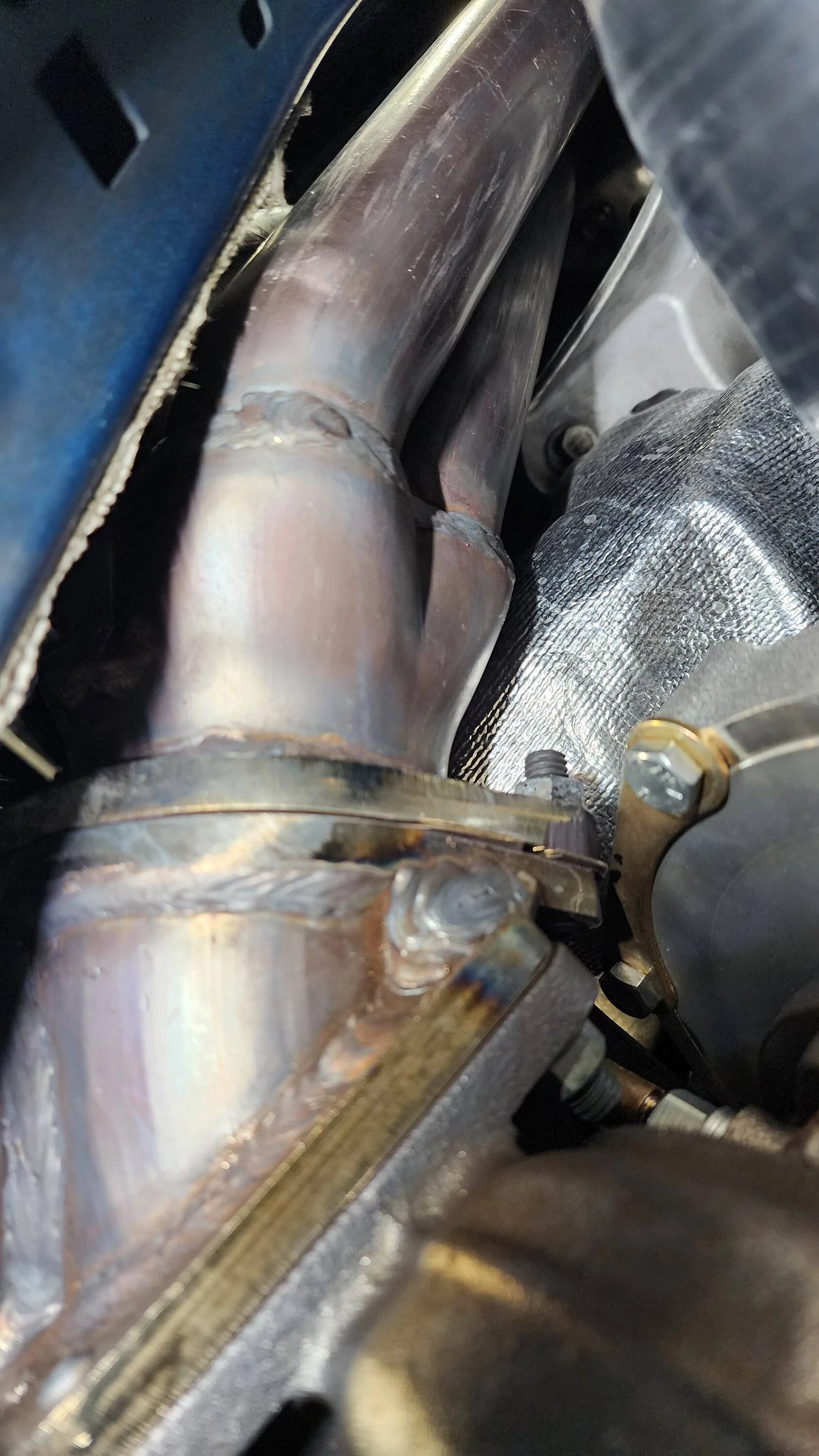

It's all super tight. Wait until you mount the starter and realize there is about 5 sheets of paper clearance. Lol. I wrapped my starter with peal and stick heat wrap.

That shit falls off after time and heat cycles. Been there, tried that lol

Yeah, likely. Holding up for now. Good stick across the top. I thought about that formable aluminum stuff and tie it off. Or just replace the starter when it fails. Lol

It is a lot closer than I would like it to be. If I ever have to take it off again I will use some sort of blanket.
