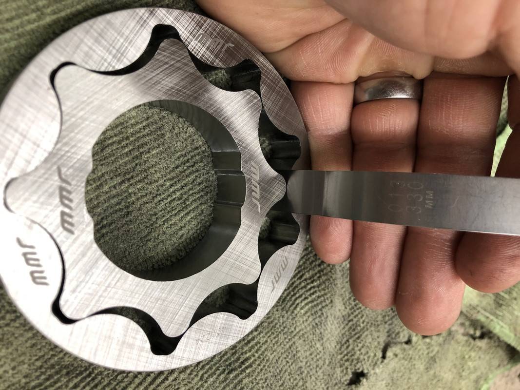

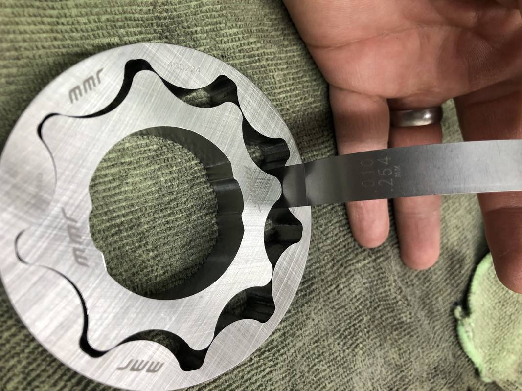

I've never heard anything bad about MMR gears. I have almost everything MMR makes in my engine including their shortblock. 14k Miles (supercharged and now twin turbo) later and still running strong. I think every manufacturer gets a bad rap from someone.
MMR's opg gears are not good. Not even close to good.
The set I had I measured .010 -- .013 (!!) between the teeth. Waaaaaaaaay too much.
The ones you want are the Ford cobra jet gears part no 6600-M50A. Ive been told they aren't being made any longer though so who knows.

So they should measure around .004? Mine runs 80psi oil pressure warm with a little rpm. 100psi at startup. 5w-30 Something is working right.
That's good oil pressure and at 14k miles, youre likely just fine with your MMR motor.
I think the issue is MMR's consistency and quality control. Perhaps you got a set with tighter tolerances.
Some other members have shown the gears themselves to deteriorate quicker than other brands so pay close attention to metal particles in your oil at changes.
