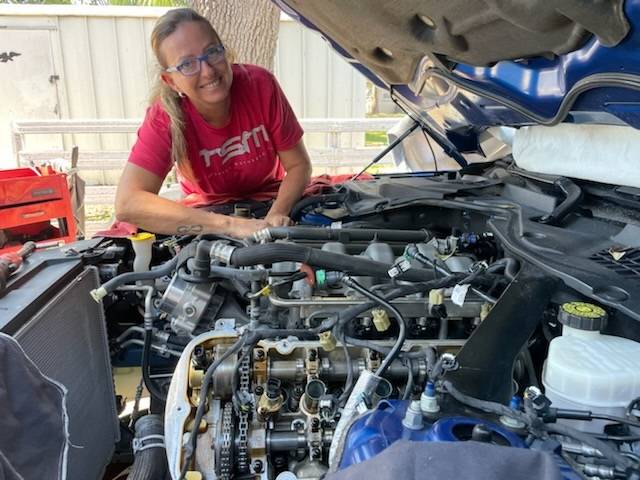

Besides breaking an intake bolt off in the back of the head the OPGs went back together smoothly. This weekend coming up we should start taking off the manifolds/exhaust to start on the Hellion Kit.

I didn't take too many pictures.

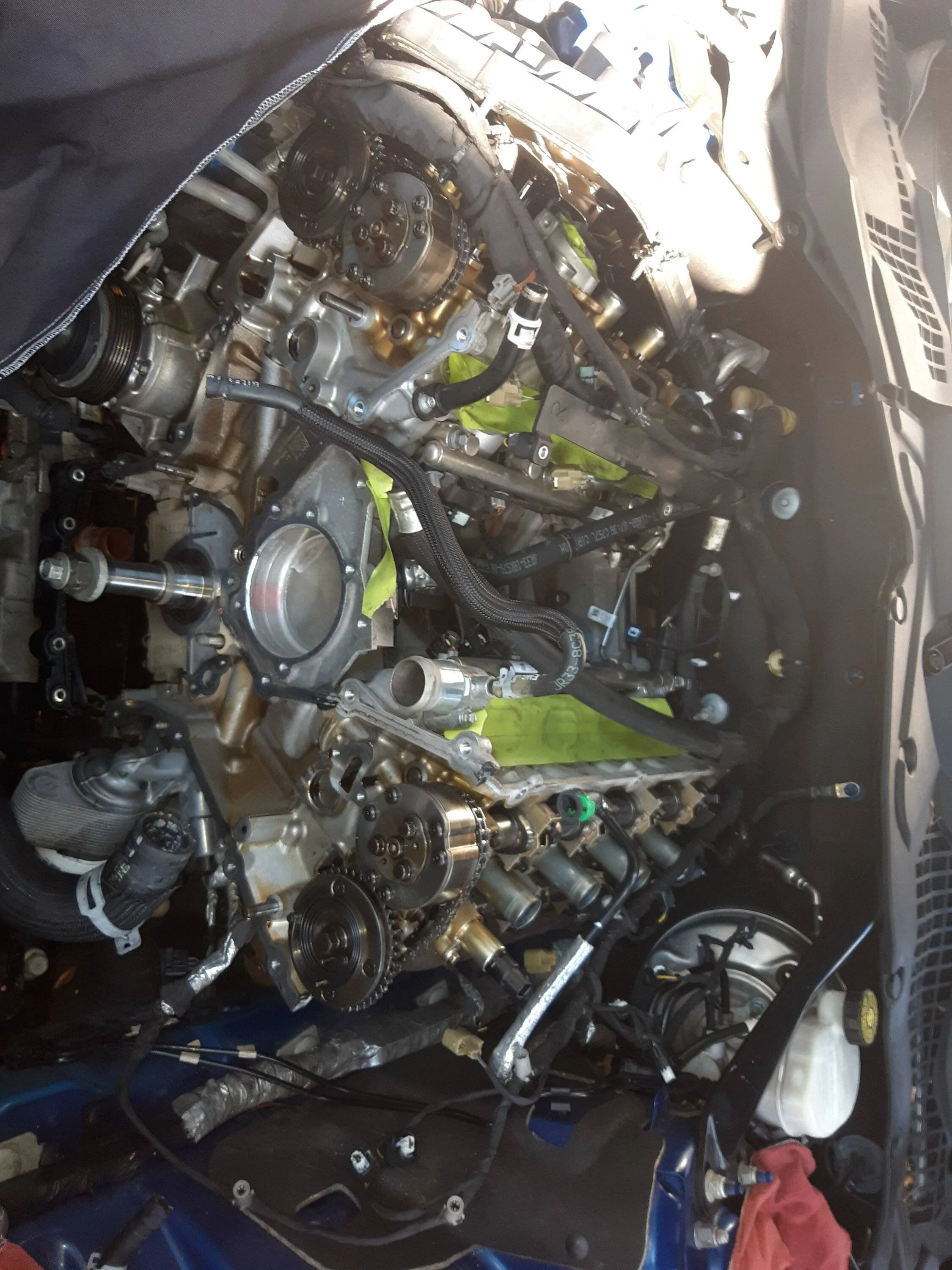

Apparently I was too busy playing grab ass with my wife during the job. I overlooked turning the engine over 360 degrees after installing the left side timing chains. The engine did not like trying to fire with the right side bank 180 degrees out of time.
On the plus side it only took 5 hours to re-do the timing chains. LOL.
Next up is to start installing the Hellion kit.

we see the misstiming a lot, it can be tricky

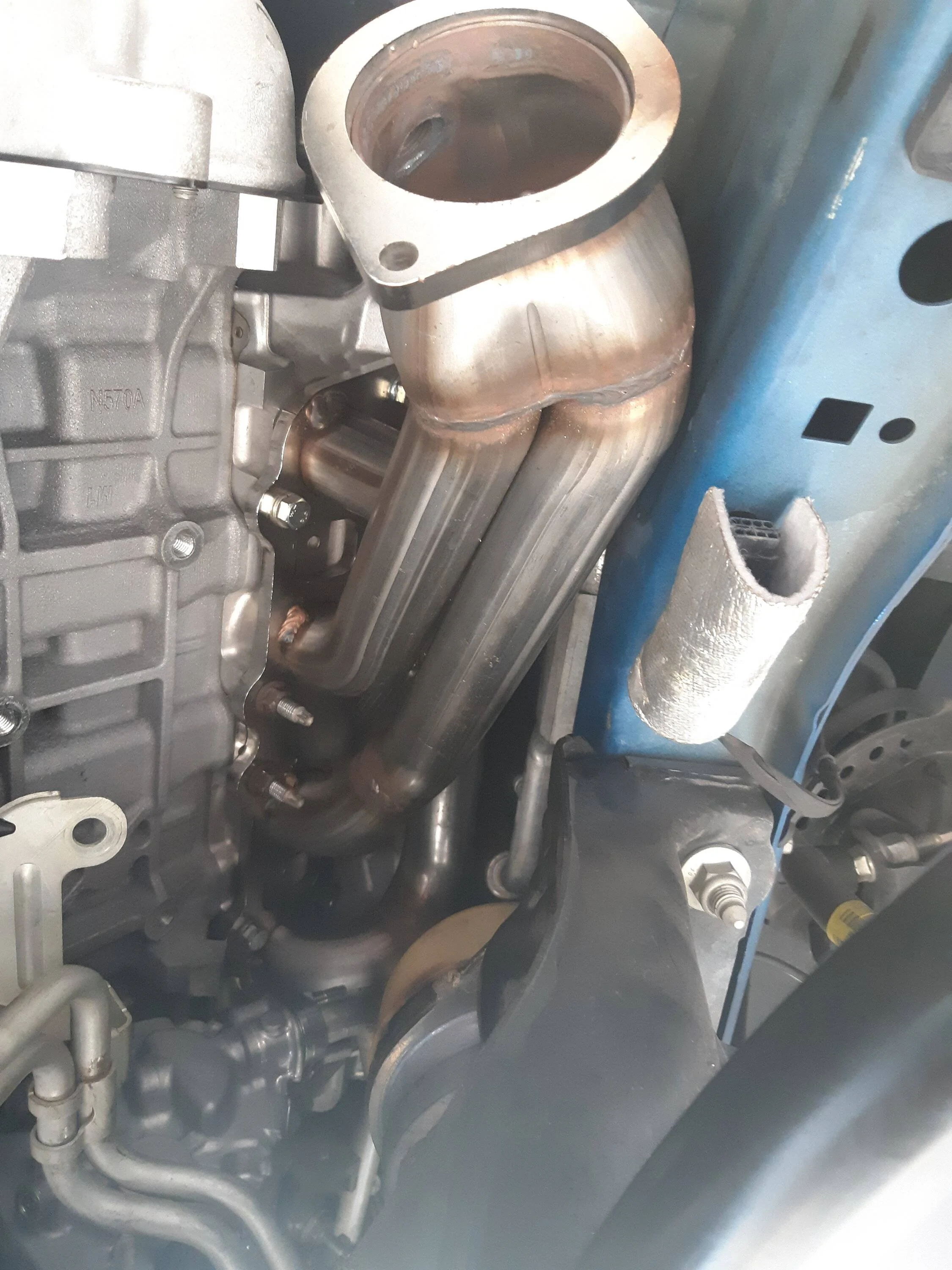

Progress is slower than I had hoped, I haven't had any time to work on it. Hopefully the left side header goes quicker than the right.
Dang that's a beefy looking manifold! How much clearance do you have from the body? Looks really tight.
How much power are you looking to make? I'm not convinced those hellion headers are needed at anything less than 1200hp maybe even higher.
No worse then the factory manifold. You cannot remove the manifold without removing every stud. Alldata wants you to remove the ac line to get the factory manifold off.
