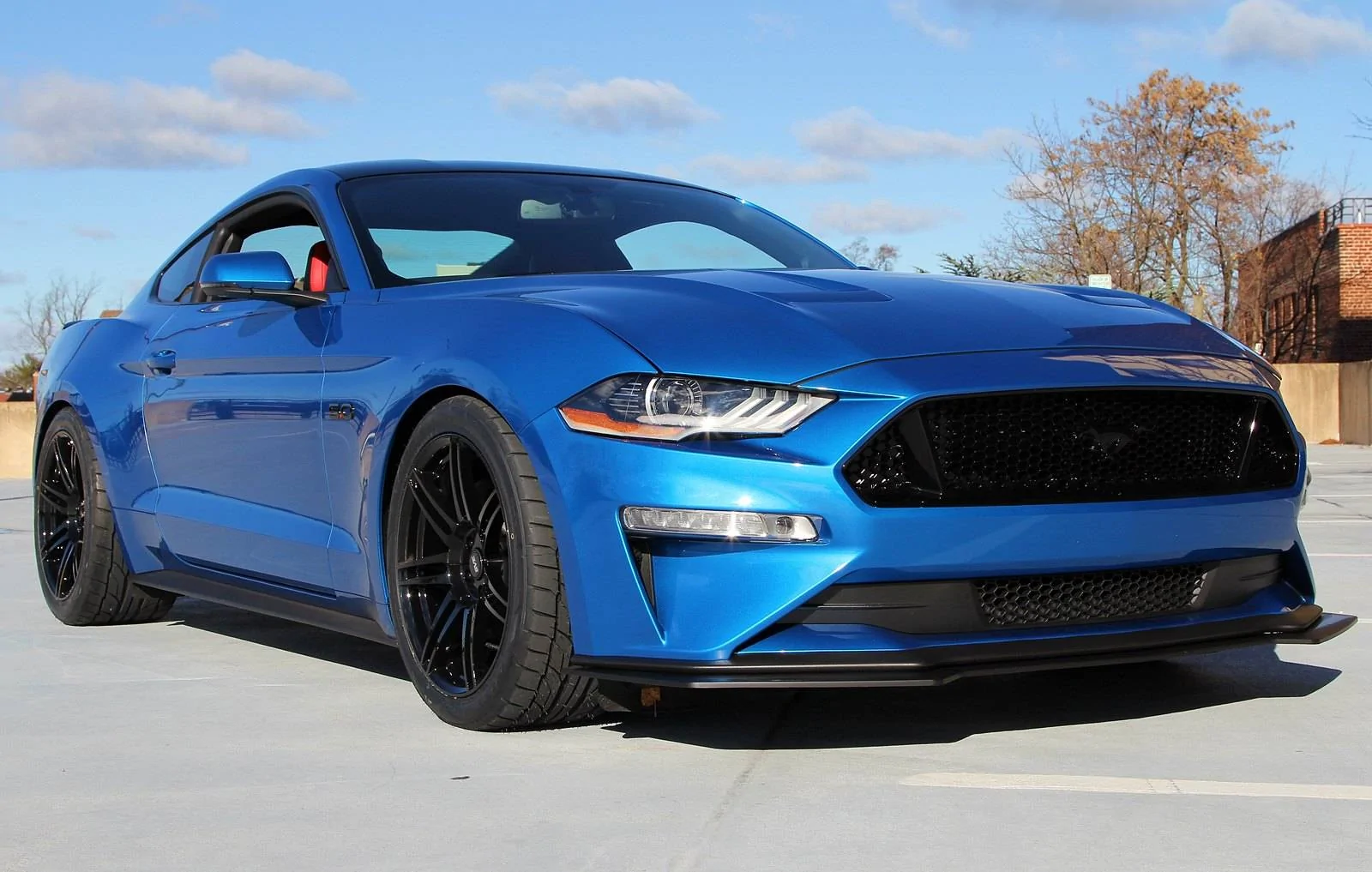

Just noticed this past weekend that both headlights have slight condensation on the same spots. Car has been sitting in the garage and no water has been in contact with it. wandering if anyone one else has experienced this given no contact with water. its a new car with only 1400 miles. Is this a warranty issue or it will go away on its own
You can see the 2 spots in the pic where its showing up

It's normal. They have vent holes. If water starts pooling up then I would worry.

Remove one of the bulbs that is in that portion of the headlight housing.
Then park the car with the lights facing the sun.
On a warm day this will take anywhere from an hour to a few hours but the condensation will be gone.
Put the bulb back in and you should be g2g.

OP, don't touch nothin'. Just leave it alone. It's fine.
That's how they work. When the lights are on the condensation bleeds away through vent holes.
