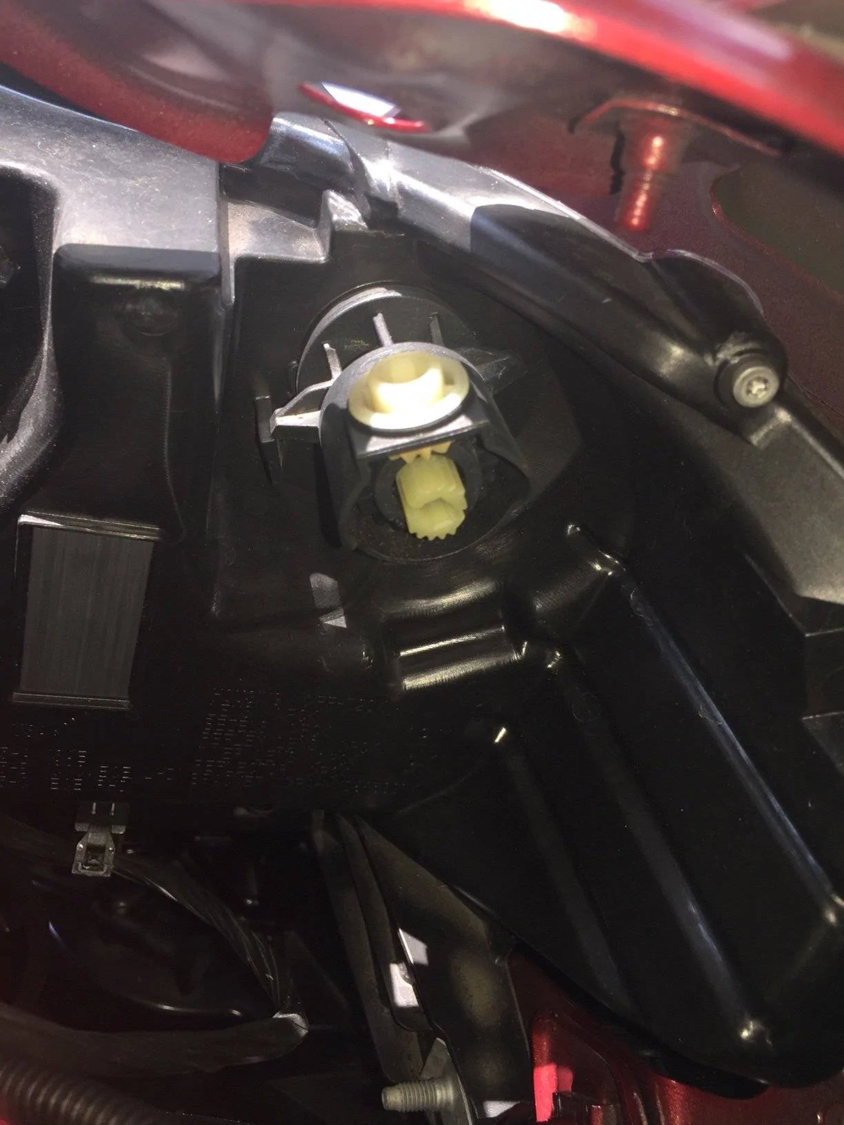

Hi guys!
Having a bit of a problem here.
My headlights are pointed up way too high, blinding everyone that passes me.
When I tried to look for the little white plastic adjustment screw after checking the owner's manual, I couldn't find it. There's no screw whatsoever. Am I missing something??

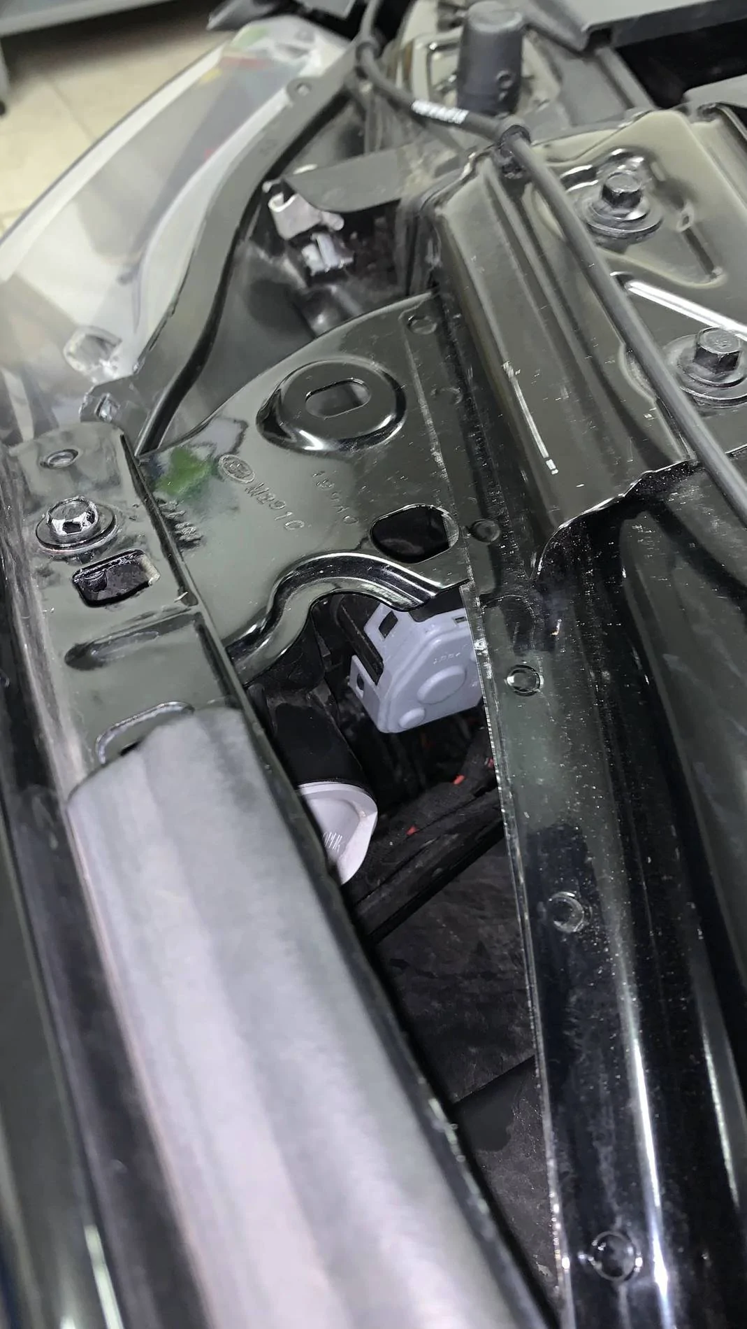

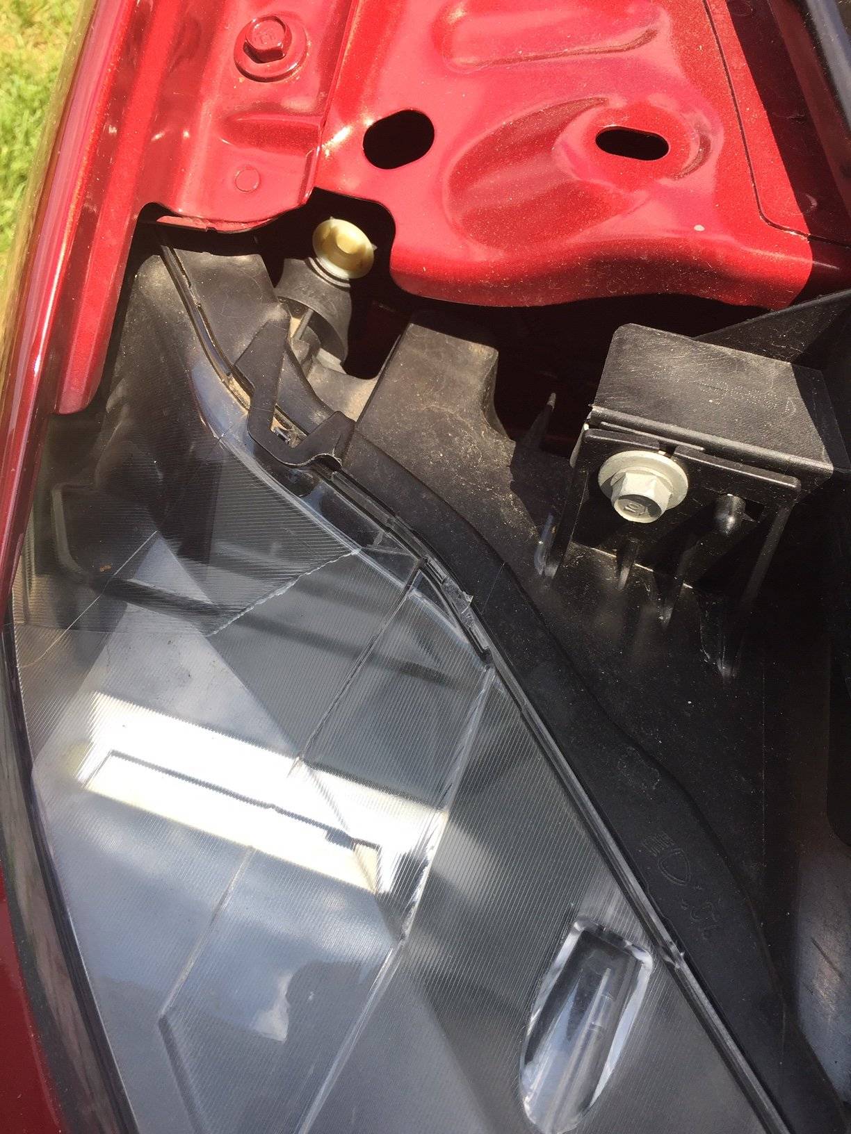

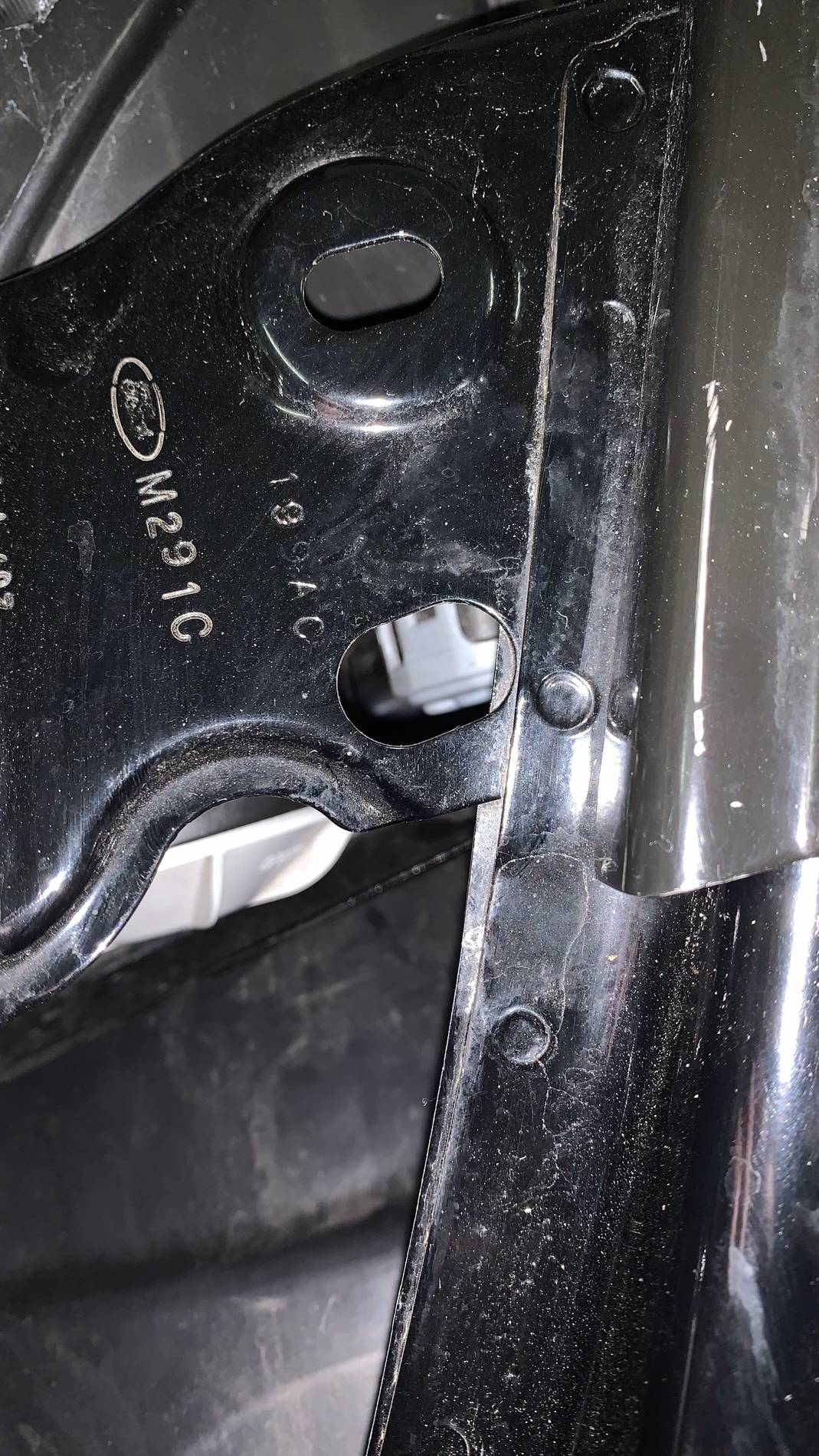

On US Spec cars, we do not have this. At the outer edge of the light housing is the white-ish plastic hex adjuster. It is located not on through the flattened oval hole but the other oval hole closer to the side of the car. You need to reach it going in at a 45 degree angle.
It is possible Europe spec-ed cars have a different adjustment than US. From your photo, that could be a digital motor cover. where US cars have the old school manual adjustment.

Looks like my headlight housing has been modified in some way to fit an auto leveling system. No way to adjust it, no screws, nothing.
I’ll stop by a dealer next week and see if they have a way to adjust it. No idea how though.

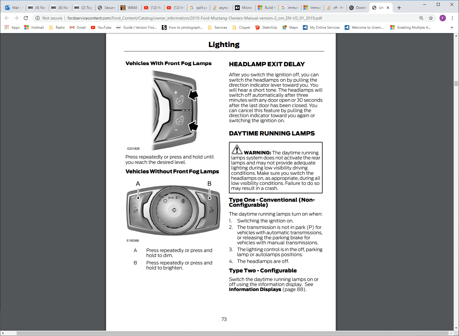

Ths is my switch for the lights

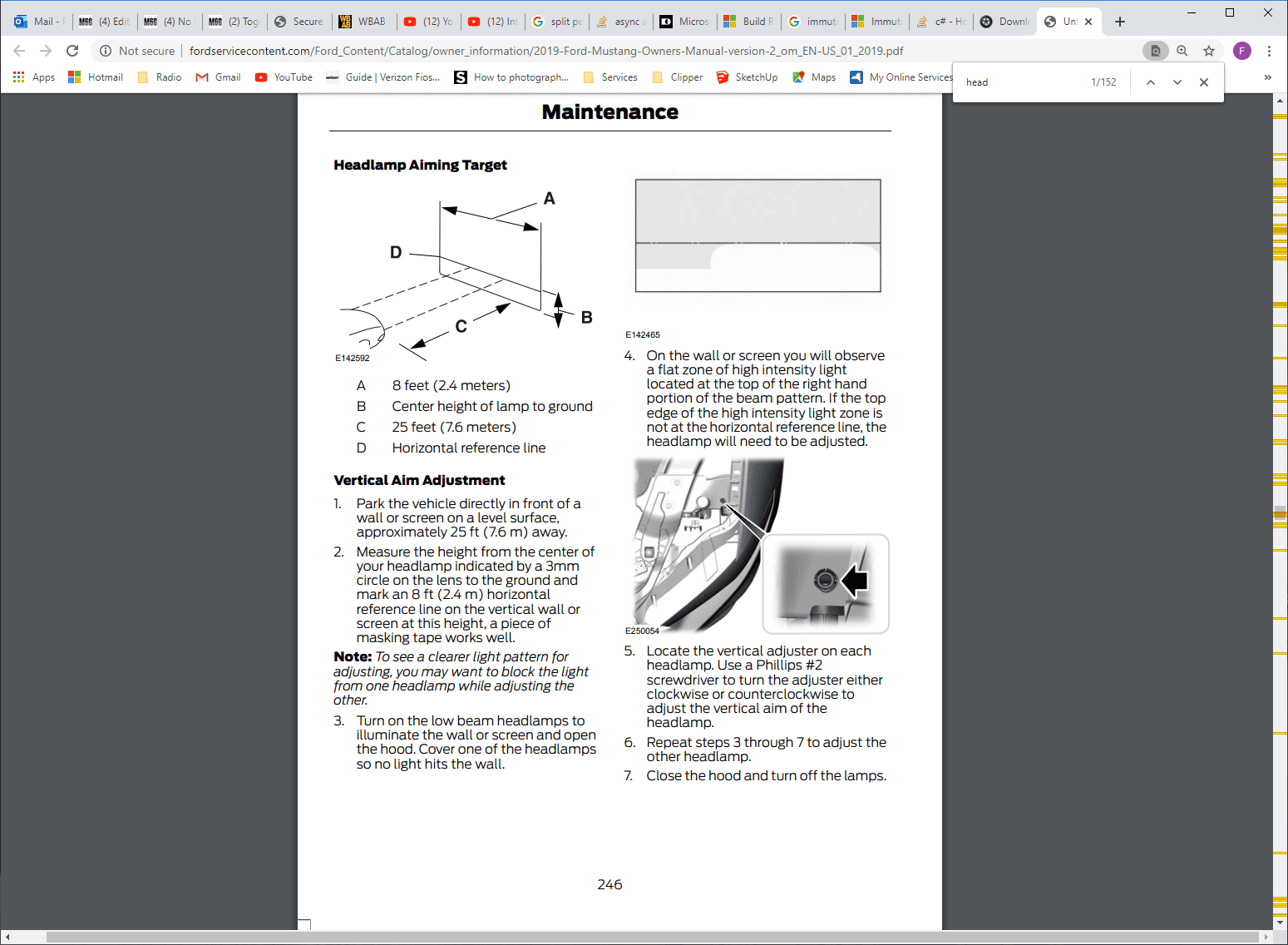

Here is our procedure to aim them

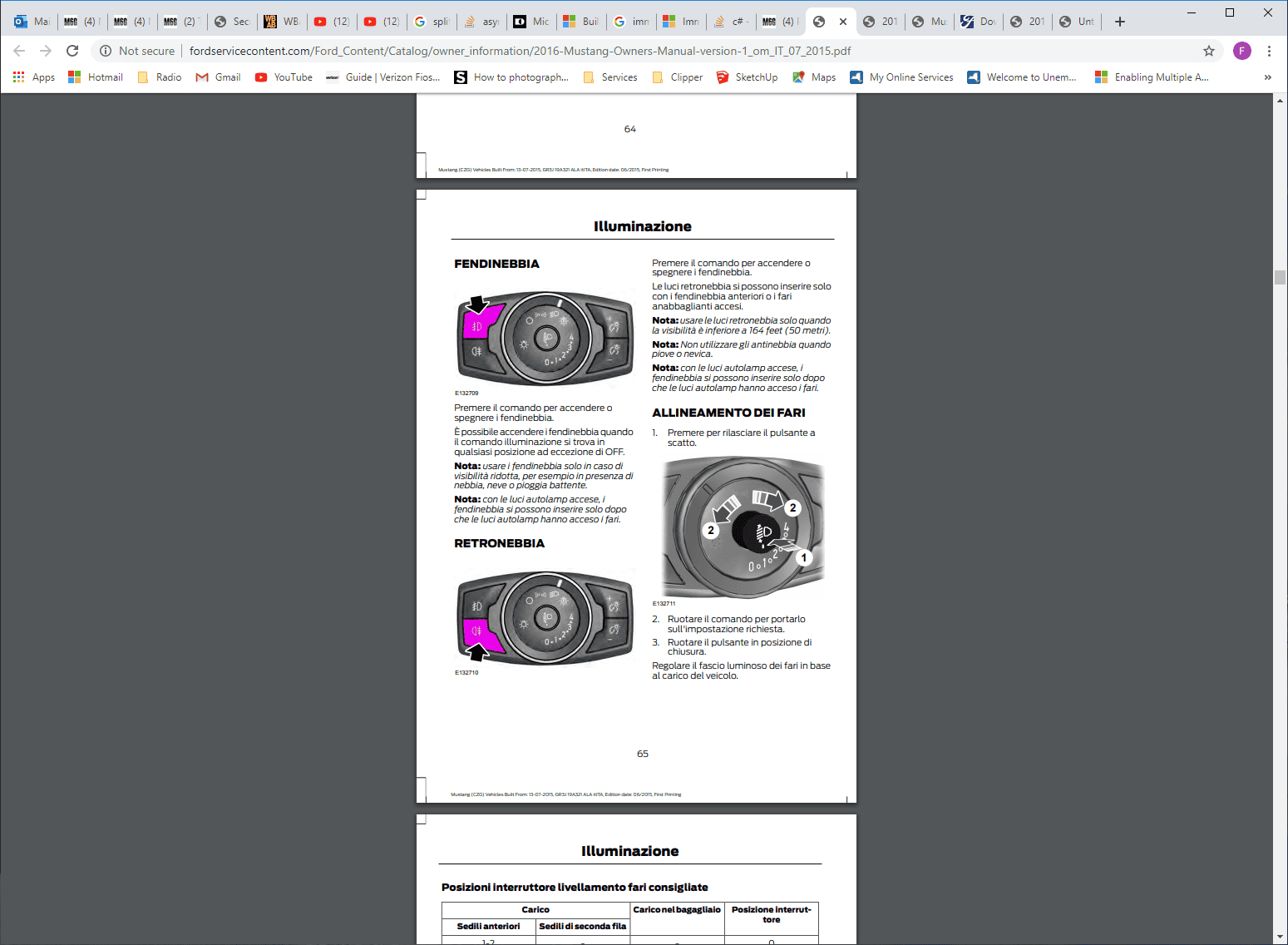

Sorry, I could only find the italian one but here they show your pop out button for adjustment
We definitely do not have that.

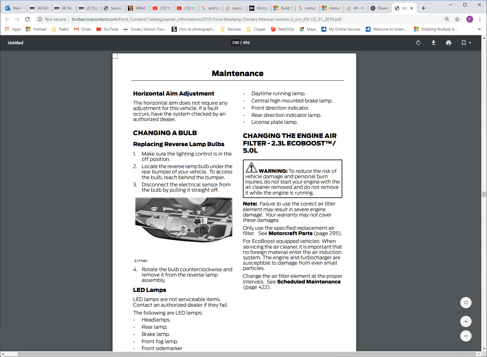

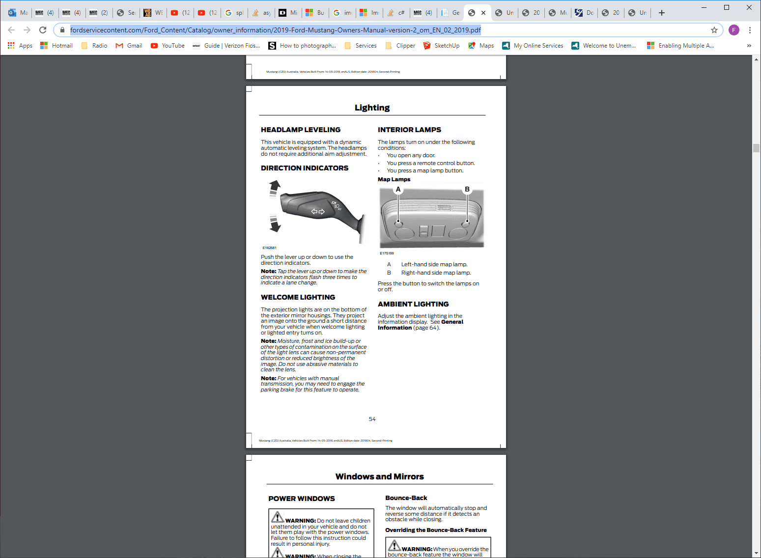

I found this for Austrailia owner's manual for themustang
https://www.fordservicecontent.com/...ang-Owners-Manual-version-2_om_EN_02_2019.pdf
ON page 58 it says they are self leveling headlights.
