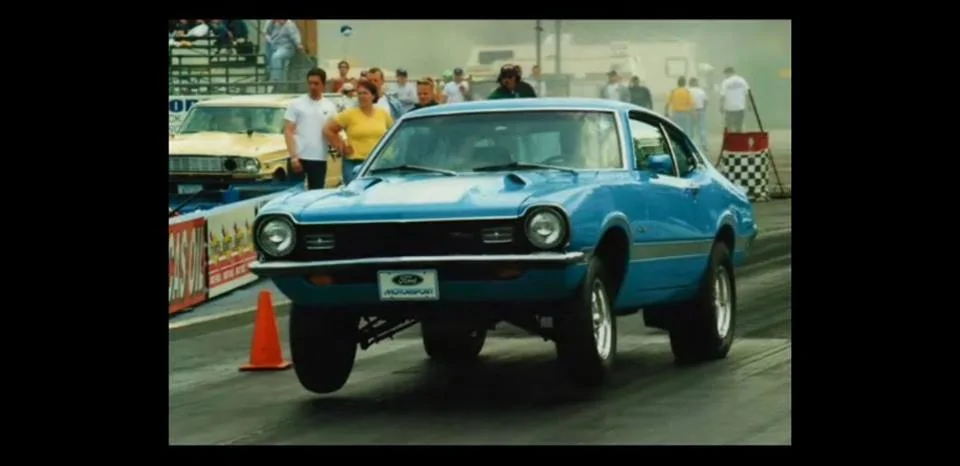

Kooks built me a set of 2" primary tube headers for my 71 Maverick Grabber back in 1995......they were expensive as hell, BUT the fit like a glove......did NOT have to touch the shock towers etc. They even sent me a milled down spark-plug socket so I could access the plugs without un-bolting the motor mounts and lifting each side of the motor. They alone picked up 6/10ths over the set I had fabricated locally in Seattle. Worth every penny and they were at that time a work of art! Spend the $$$$....buy Kooks!
