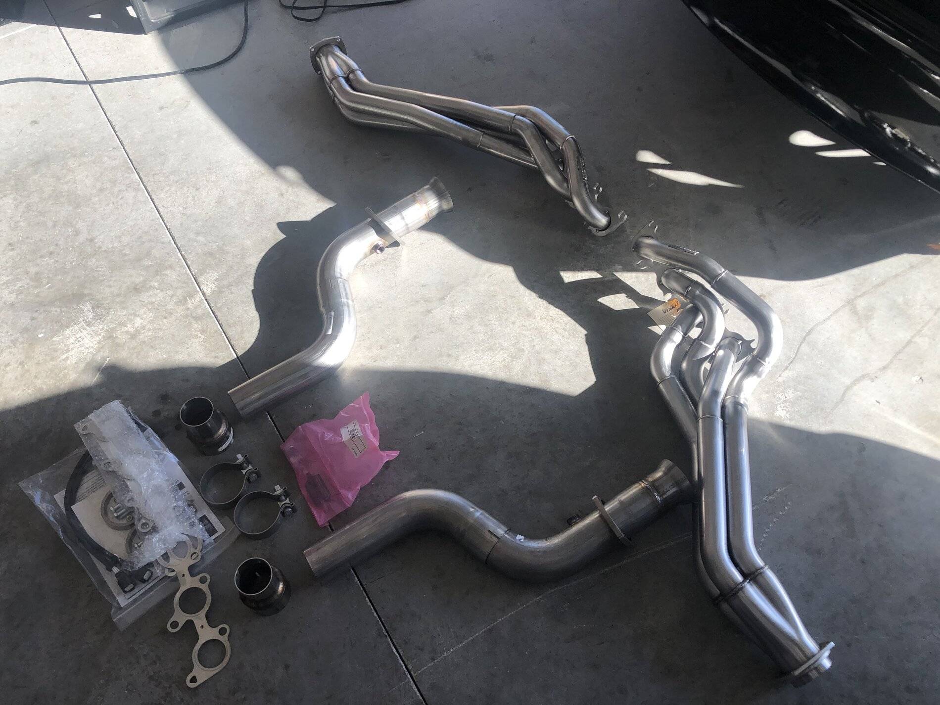

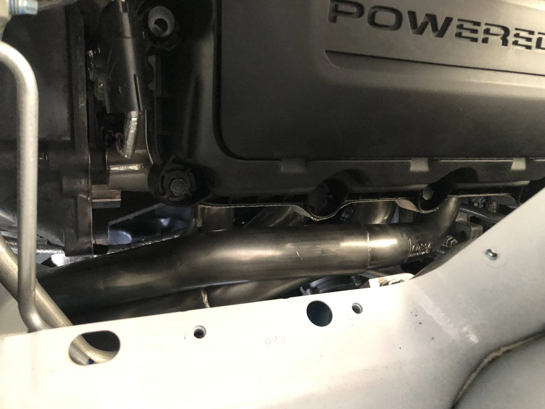

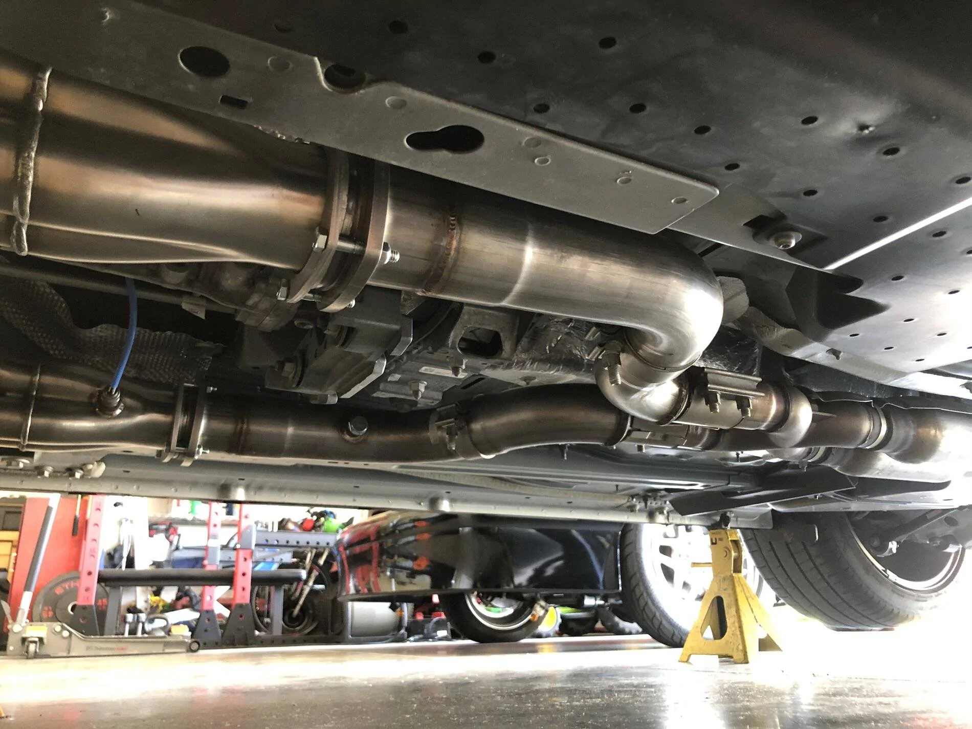

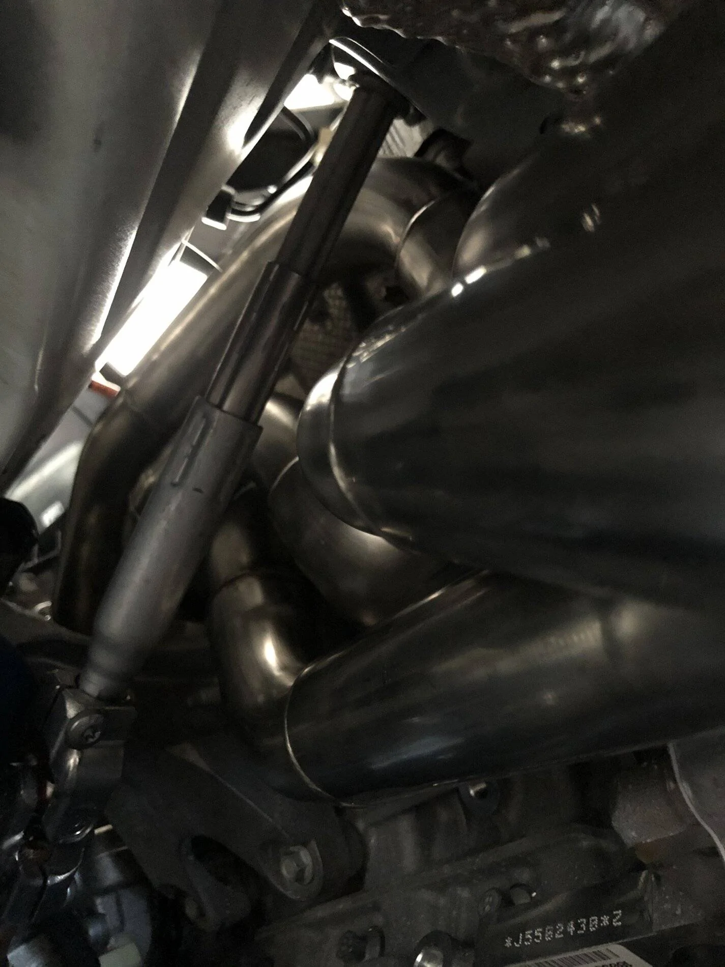

Just installed Corsa longtubes on my 350 in my garage on jack stands. Some of the easiest headers I’ve ever installed. Great clearance everywhere and used all the factory hardware. Car has a Lund E85R tune also.

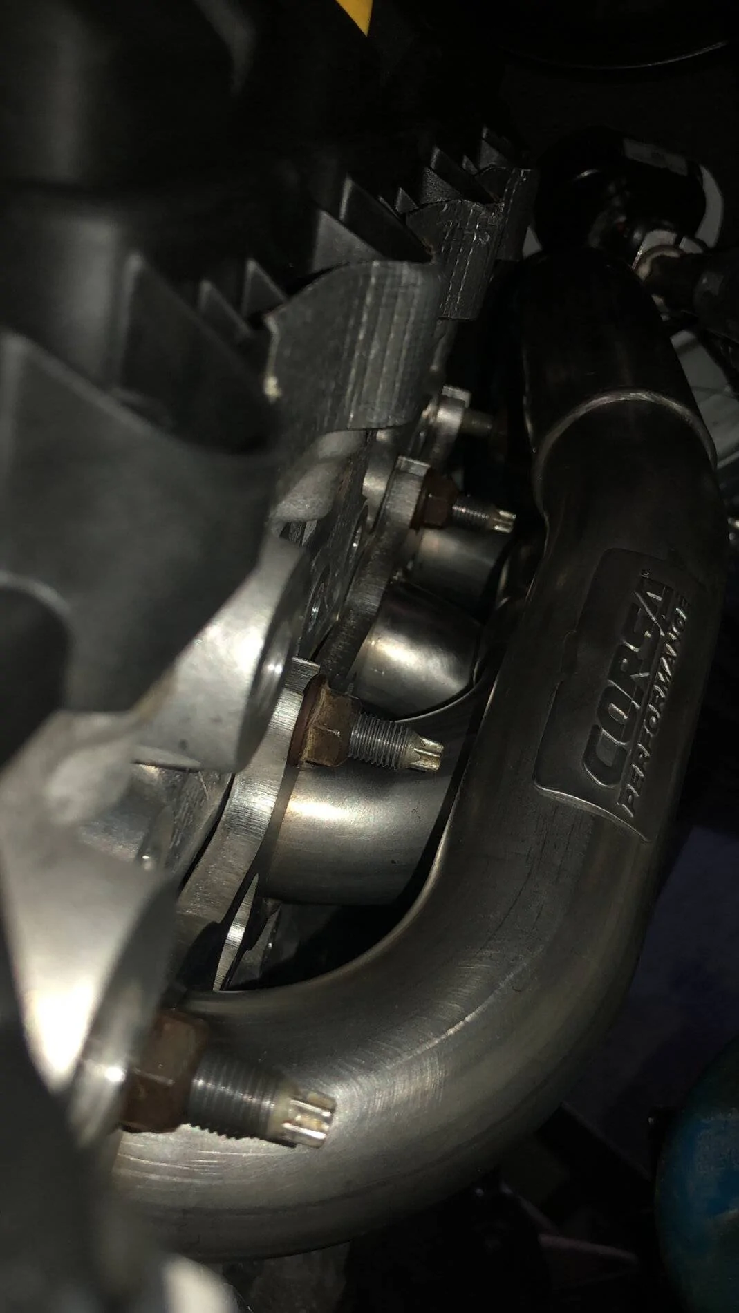

Also, before tune and headers were installed I was running B line cat deletes and a proflex commander on full E85. Took a picture of my exhaust ports before putting the headers on. Got to love E85. Ports are nice and clean. Barely any carbon!
