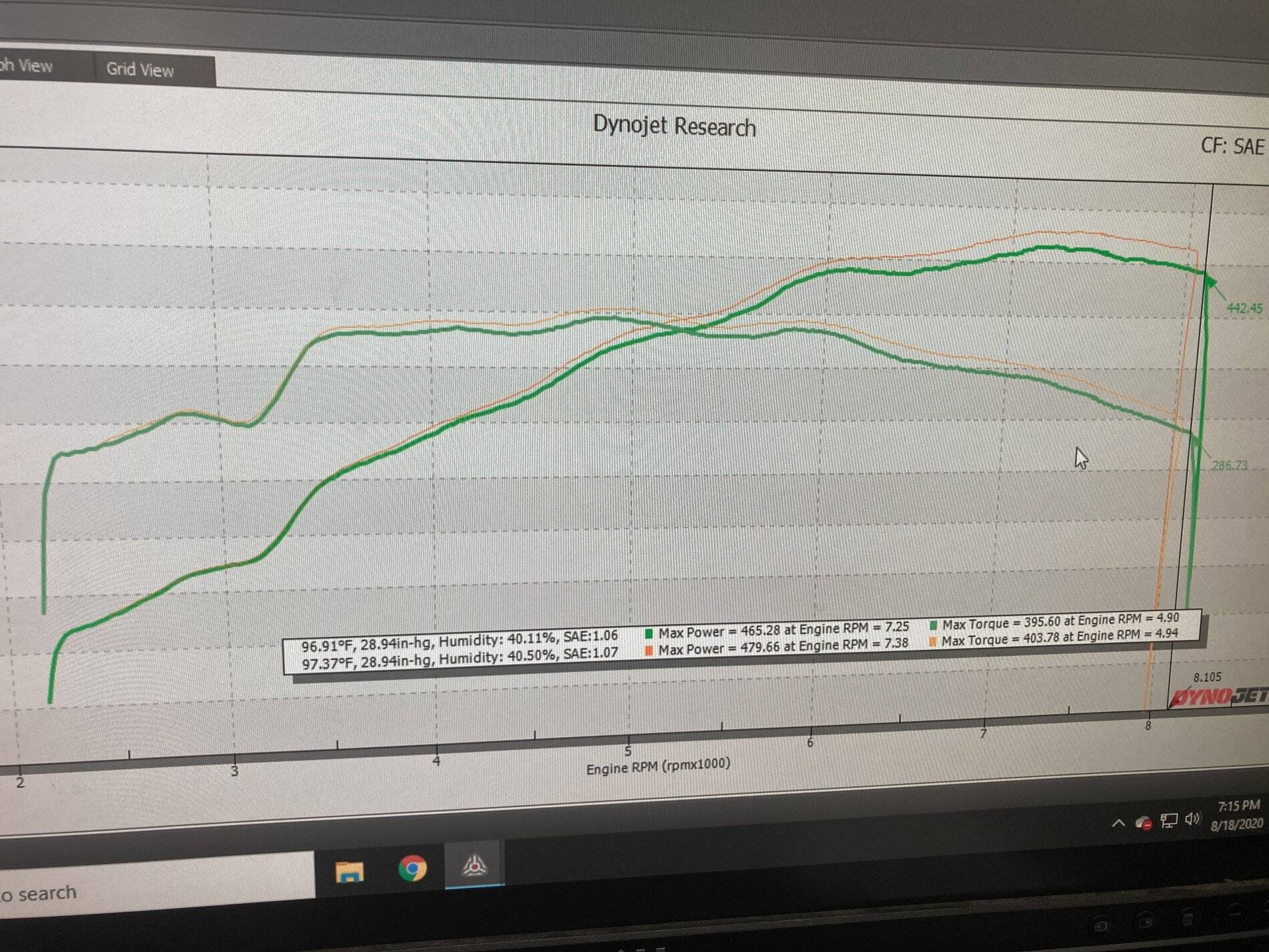

Here’s a dyno from a 2017 GT350 that I tuned. Car was stock running 93 octane. Dynojet using STD Smoothing 5. Gained ~15hp and 5tq. Could probably play with VCT a bit and smoothing things out and maybe pick up a bit more.

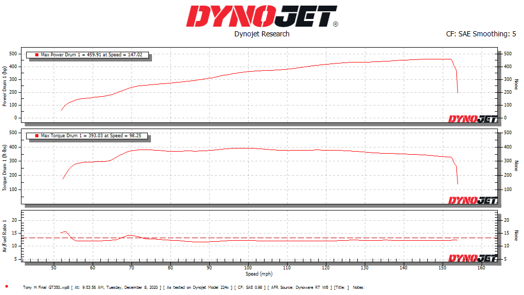

I recently had Kooks off-road LTH & X-pipes installed with an 93 octane tune by Brenspeed. Everything else is stock. I was doing it in an effort to improve the low and mid-range more than the top end as I tend to drive the track mostly in 4th with only a couple of gearchanges per lap (yep - I'm old & lazy - just do this for fun). Also I was really just curious.
See my dyno chart attached - as you can see the peak numbers are virtually identical to stock (SAE Smoothing 5). I see lots of claims for peak HP & torque and it is noticeable how many use STD and don't mention it at all so be careful that you don't spend a lot only to be disappointed.

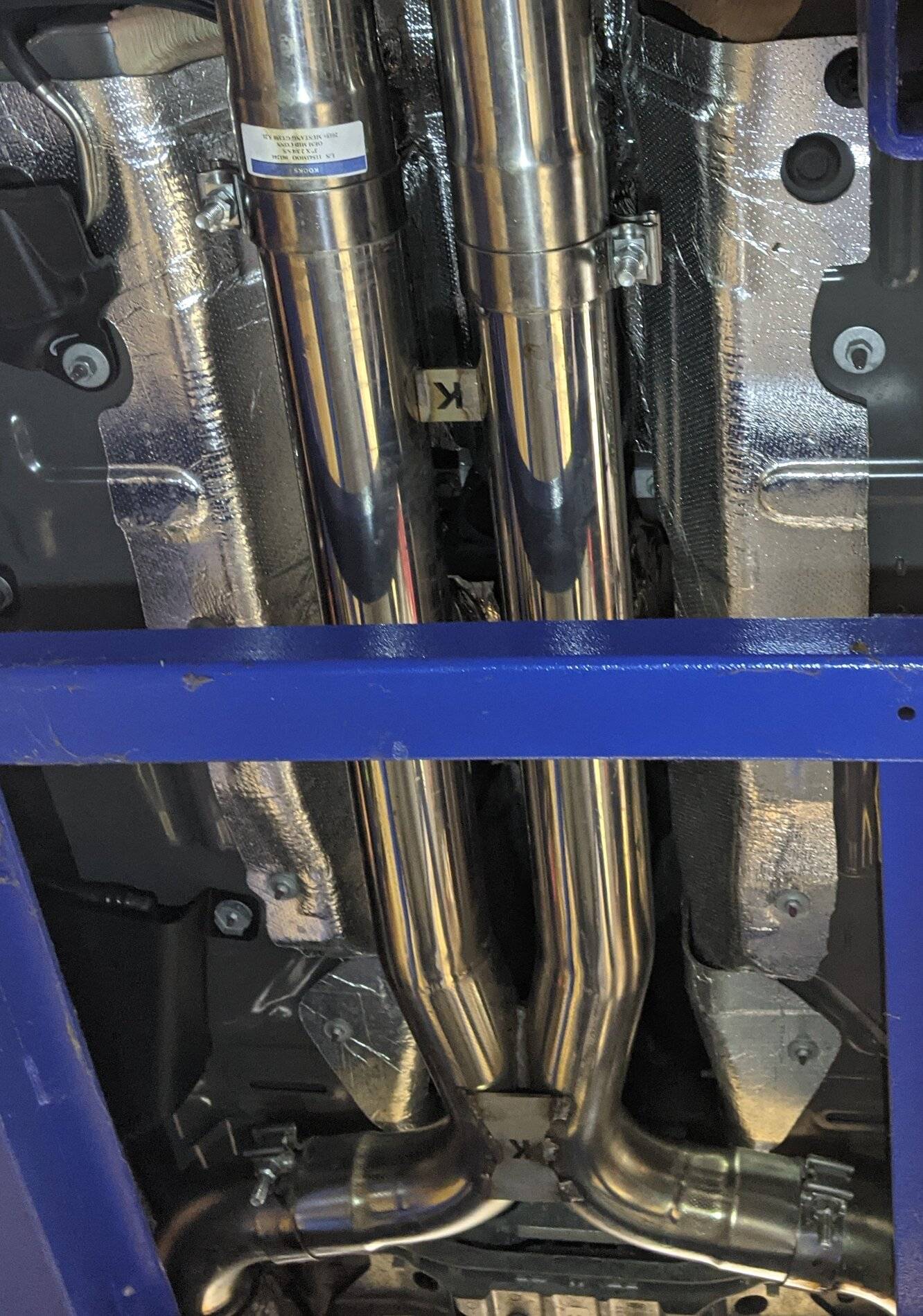

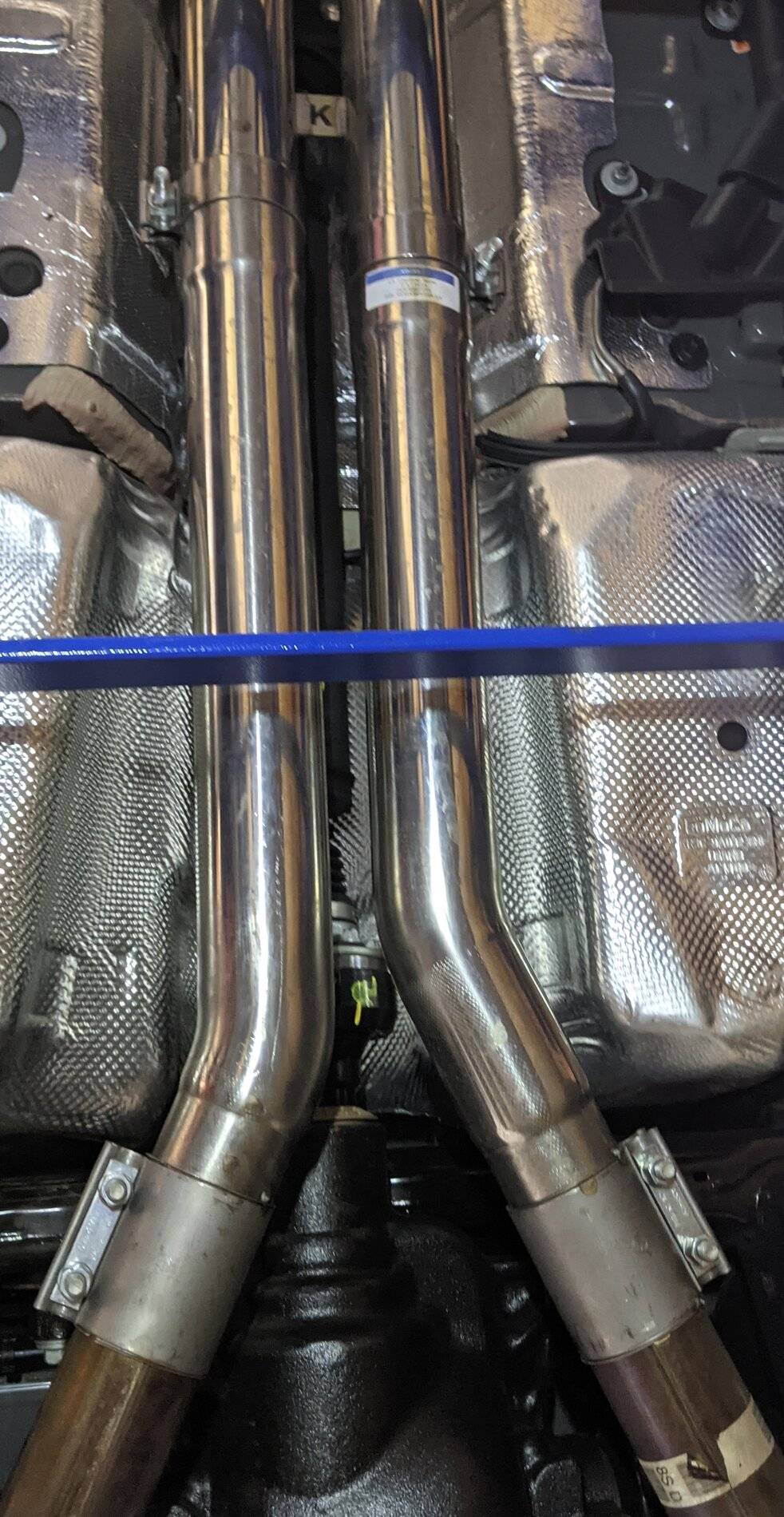

The one problem (which I anticipated) was that with the muffler open the car was completely open pipe and ridiculously loud. It also had the typical horrible rasp with the mufflers closed - the car sounded like a Civic with no cats! However I wanted to keep the switched mufflers so had to find another solution other than swapping the OEM mufflers out for non-switchables. At this point I have installed a pair of 4" x 18" Vibrant Performance 1795 resonators in the straight pipe section behind the X-pipe and before the axle.
The pic shows where they are now - but it is a before pic! They don't touch and are a slip-on fit.
Now the rasp with the mufflers closed is 90% gone and the car is OK around town. But if you open the exhaust it is still pretty freaking loud (not surprisingly). Fortunately Gingerman (where I'm going this Sunday 4th) has no sound limits. I'm planning on adding more muffling somehow or maybe the muffler switch controller so I can go to other tracks once in a while but am open to cunning alternative suggestions - anyone. The simplest would be to just add a 2nd set of resonators in the rear section of the X-pipe assembly and barring better ideas I may do this.
That would be here:

As to the performance of the car - I will let you know of my impressions after the weekend. The good news is that the weather forecast is exactly the same temp as the last time I was on the track so it should be a good comparison.
