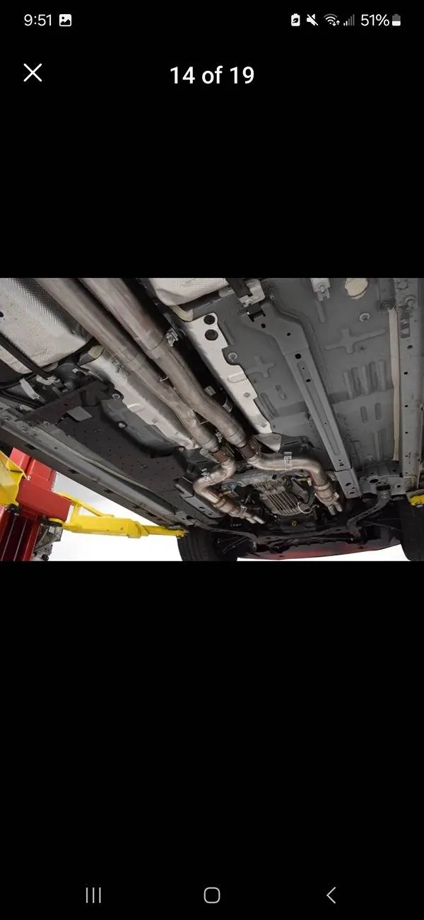

If you want a moderate exhaust note keep your stock manifolds and go to a cat back exhaust with an H pipe. I have MBRP race on mine and I like the deep rich tone. It is still loud, If you want to keep it down just a little more use the street version. If you go to Headers it will be louder than you want. I just installed the Stainless Power catted headers and it is loud. I live in the country and only have two neighbors and they both have loud cars so nobody cares.
