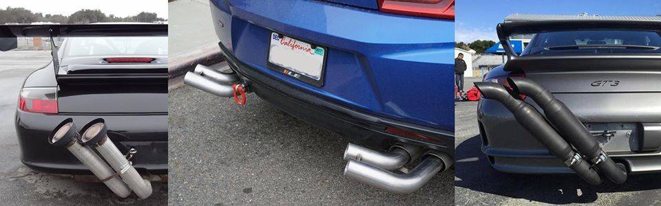

You may try out some of those cellphone app decibel readers, though we would allow a 1-2 decibel buffer to be safe because chances are they're going to read differently than the tech official's meter at the track.
Worst case, you can always run some Laguna pipes. :giggle:

Yeah, definitely thought about running some Laguna pipes! But I think I should be okay as long as I don't blow past the sound booth.. not sure how strict they are up at Thunder Hill
